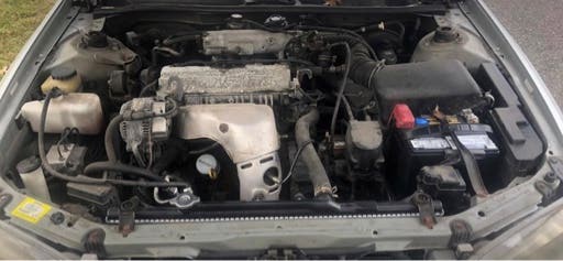

So I just picked up my second 4th gen Camry. Third if you count the es300 I flipped last month. Picked this old girl up for 900 bucks. 202k on the clock with a heavy oil leak from behind the timing cover. And a check engine light. The timing belt was just replaced at 150k, so I’m not too worried about the water pump, but I did go ahead and order both oil pump seals and a new timing belt. It has a new radiator, new front brakes, and has been overall very well maintained. This is strictly going to be a fix up to sell project, as my daily right now is a gen 5 XLE V6. I love flipping the gen 4 Camry/es300 as its such a good platform, easy to work on, and they hold their value well. Check it out. More photos to come when I begin tearing into the repair process

So I was able to get the car up on the lift at work today as it was a slow day. Took care of a few things. Went ahead and did a full transmission flush, serviced the front differential (the A140e uses a separate diff housing) lubed the front caliper slide pins, balance front tires, and confirm that my oil leak is coming from the oil pump seals. Also took the time to diagnose a p0401 code for insufficient EGR flow. Found that the VSV failed so I went ahead and ordered all my parts to get this thing road worthy for a total of $75 to repair all the issues with the car. I call that a win
