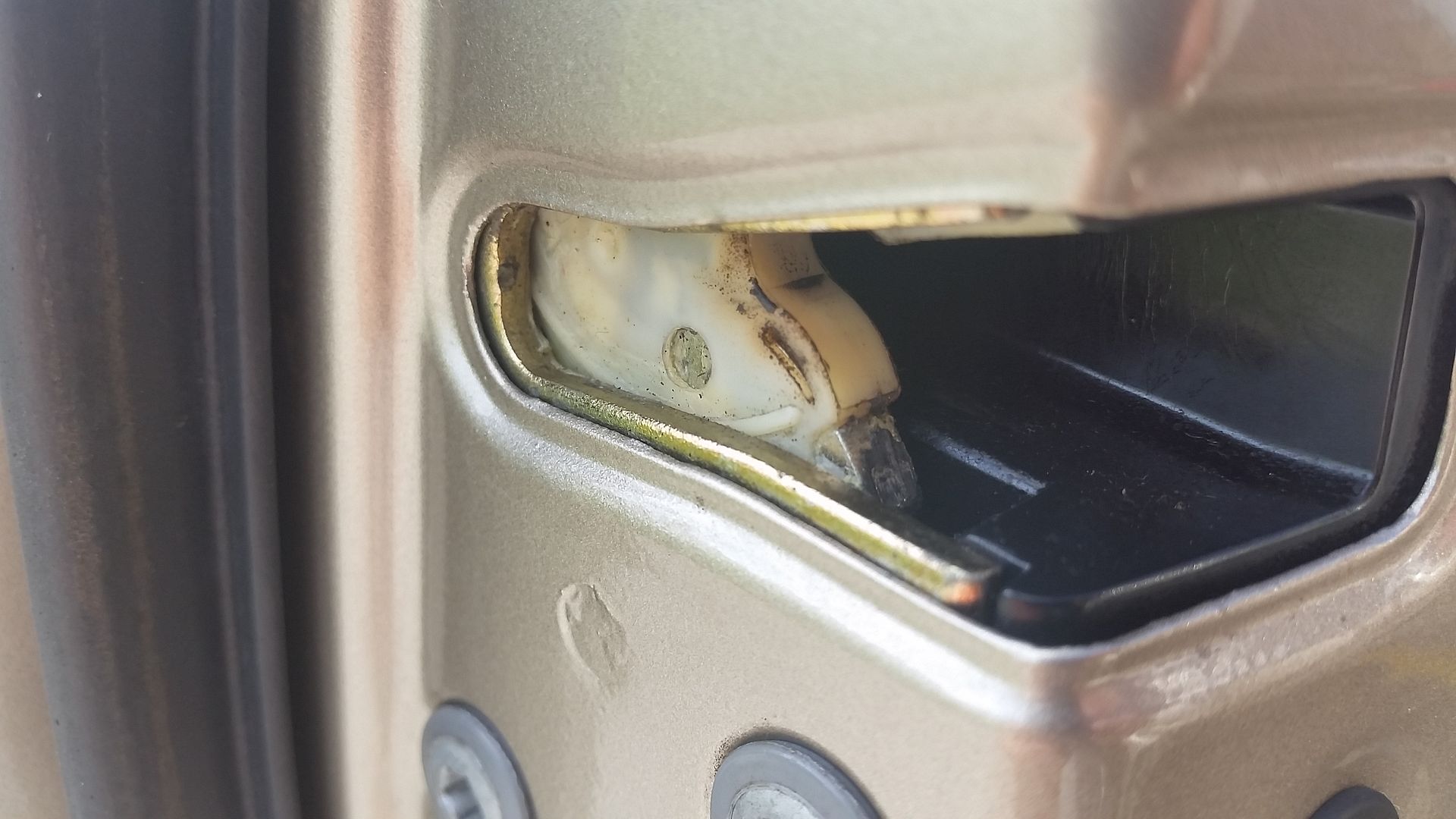

One thing I did notice is on my driver side door latch, the white plastic covering (which appears to give the door the nice quality closing), is all worn out, causing me to have to slam the door shut. I have an overheard DVD player so no dome light to verify whether the door was "open" when the alarm went off, though it does seem like a likely cause. Here are pics to show the difference:
Driver side front:
Driver side rear:

My '02 Sequoia's alarm would go off sporadically at any time of the day or night. In the forums, some suspect a leak after the windshield after it was replaced or some suspect door or hood contacts as the problem. I brought my Sequoia back to Safelite Glass who replaced my windshield and they did removed the molding to check for leaks. In the process, they've cleaned up the car molding which was caked with crud and around the engine compartment that had a lot of leaves that were clogging the drainage system which cause water to leak back into the car - probably causing electrical problems. Satellite quickly pointed to the sunroof drainage system (two hole near the front of the sunroof area) which were clogged - they've seen this happen with vehicles of all makes and models. The tech who had pride in his workmanship used an air hose to blow into the drainage hole which is connected to a hose that runs down the interior molding to drain behind the engine compartment. Once he blew out the stuff that was clogging the sunroof drainage system, water flowed out and now my alarm have not gone off in several days.This seem to be a common problem and I wanted to post this information.
Thanks for posting this, it may help someone else in the future !
