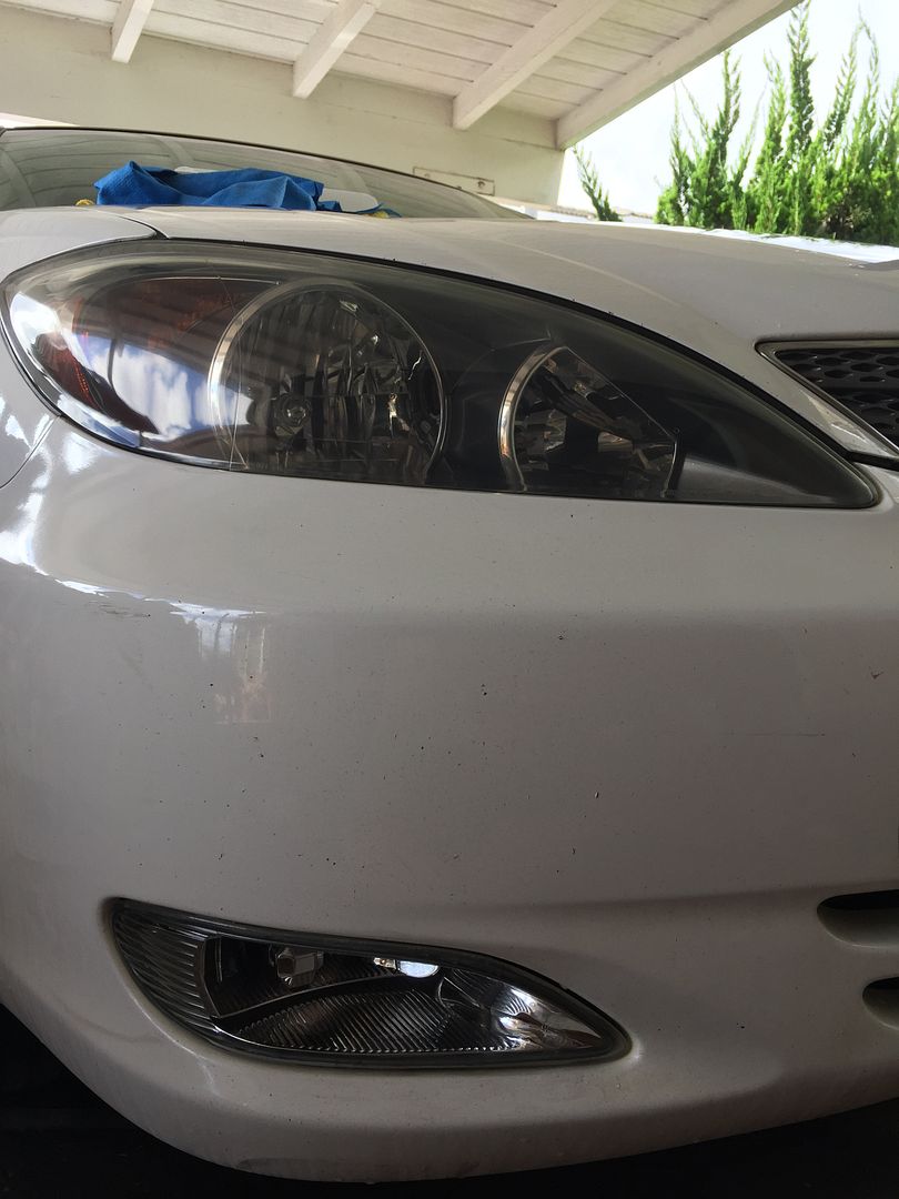

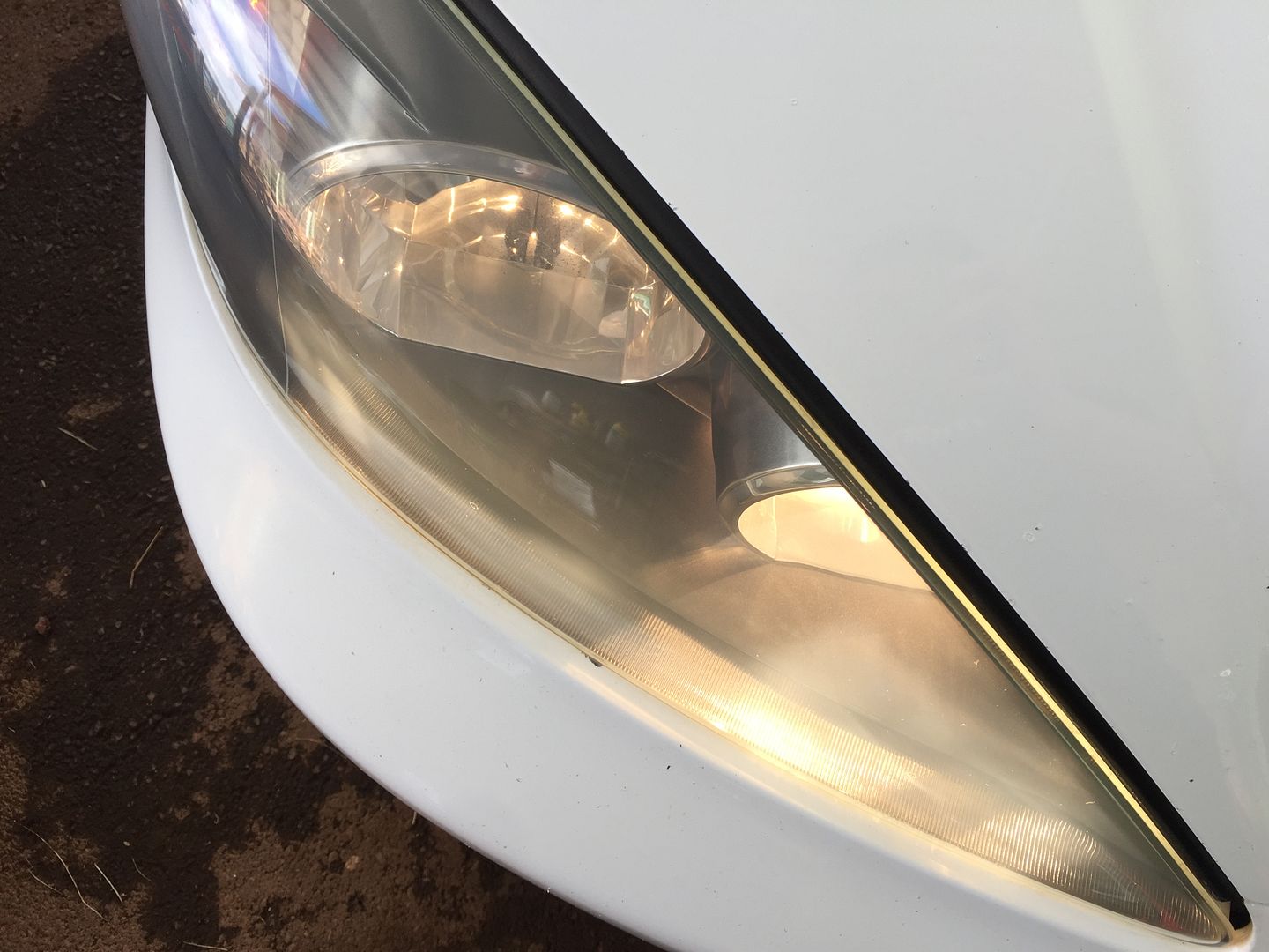

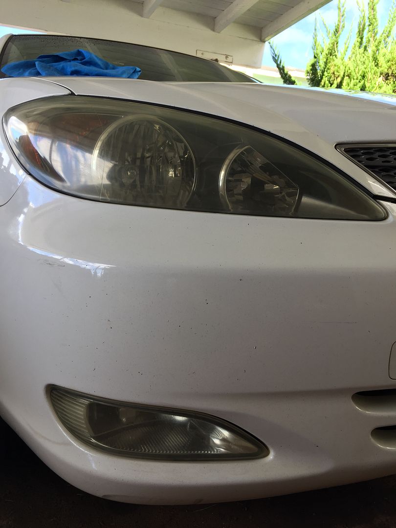

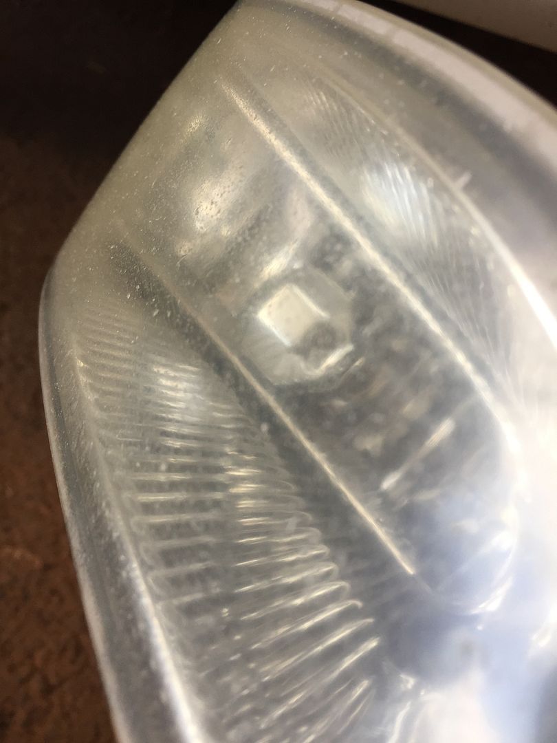

Some pictures below from my 2004 SE.
Before (same for both side, picture from passenger side)
After
(Passenger side done, Driver side not restored yet)
Passenger Side, some scratches still exist, might have to compound more and longer but not noticeable. Driver side not done yet in these pictures. I did complete the driver side after this picture was taken.
Think the results is good but maybe I'm expecting too much from headlights that are 12 year old.
Anyone has other products that they had good results with?
