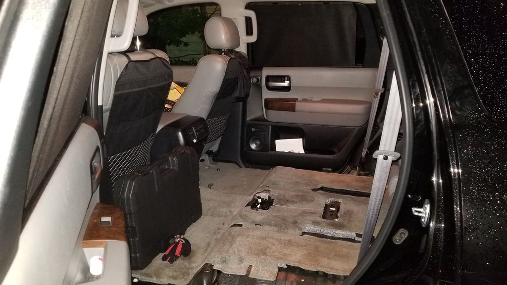

1. The floor pan is the same for the SR5 and the Platinum I was able to use the stock bolt locations without issue.

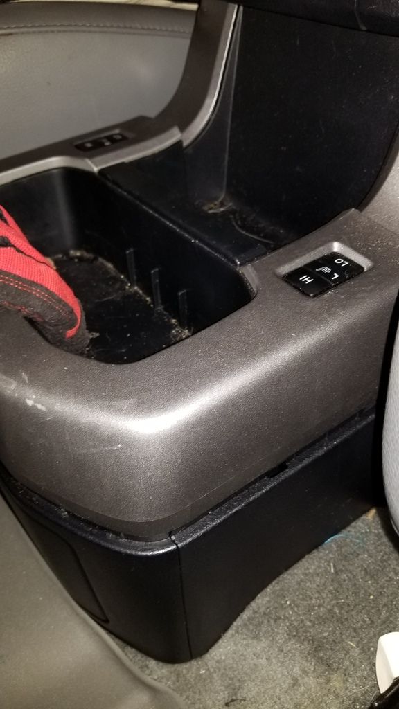

2. Have fun with the console. There weren't any instructions I could find to disassemble the console and it took me the better part of an hour to disconnect the seat heater leads from the console.
3. The carpet will need trimming, but not too much. Actually barely needed any trimming to make it fit and I have weathertech floor mats which cover the center bench rails beautiful it really looks stock except for a shallow dip of the carpet beneath the center bench.

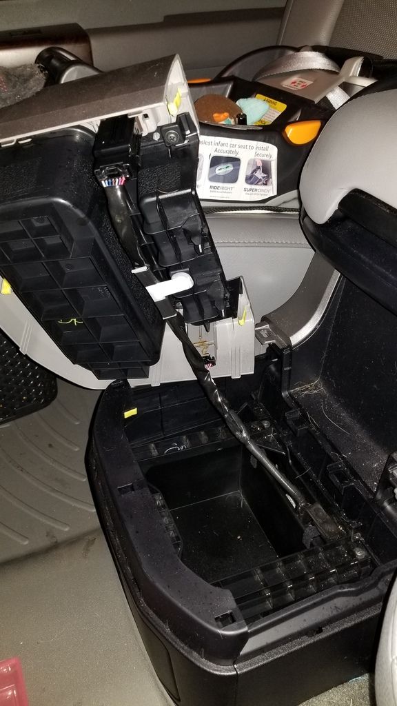

The seatbelt is integrated into the middle seat so all you need to do is bolt the seat to the floor. Please let me know if you have any questions. Trimming the carpet was actually the hardest part of this. Well next to removing the seat heater switches. Taking out the seat heater plugs was by far the hardest part of this as their is no instruction set to disassemble the center console and those plugs are way up the top.
EDIT: it will disassemble way easier if you unbolt the center console from the floor and then dissemble it from the bottom up instead of trying from the top down like I did my first hour.

I couldn't find any instructions so I just had to try and wing it. The plastic shroud pieces are secured with 3 screws and a bunch of pull tabs you can just pull up. Do the forward plastic first then move to the back as they overlap.
For the carpet I just bolted in the seats under the carpet and went back to trim to fit after install to make sure I cut as little as possible. There was still a sizable gap behind the middle seat so I glued the scrap carpet pieces there and have the weather tech digital floor mats so it covers the glue marks nicely

Oh and razor blade for the carpet. The carpet padding is crazy tough so be ready for a work out cutting it without scratching the floor

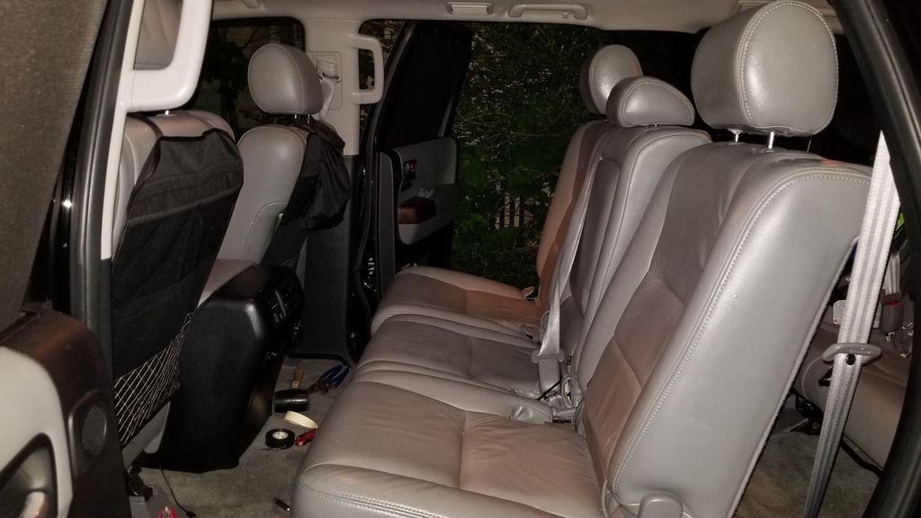

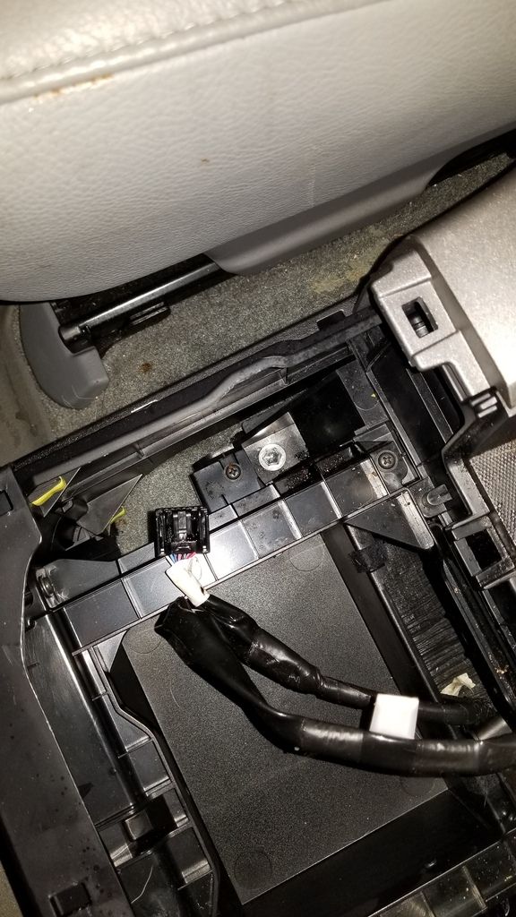

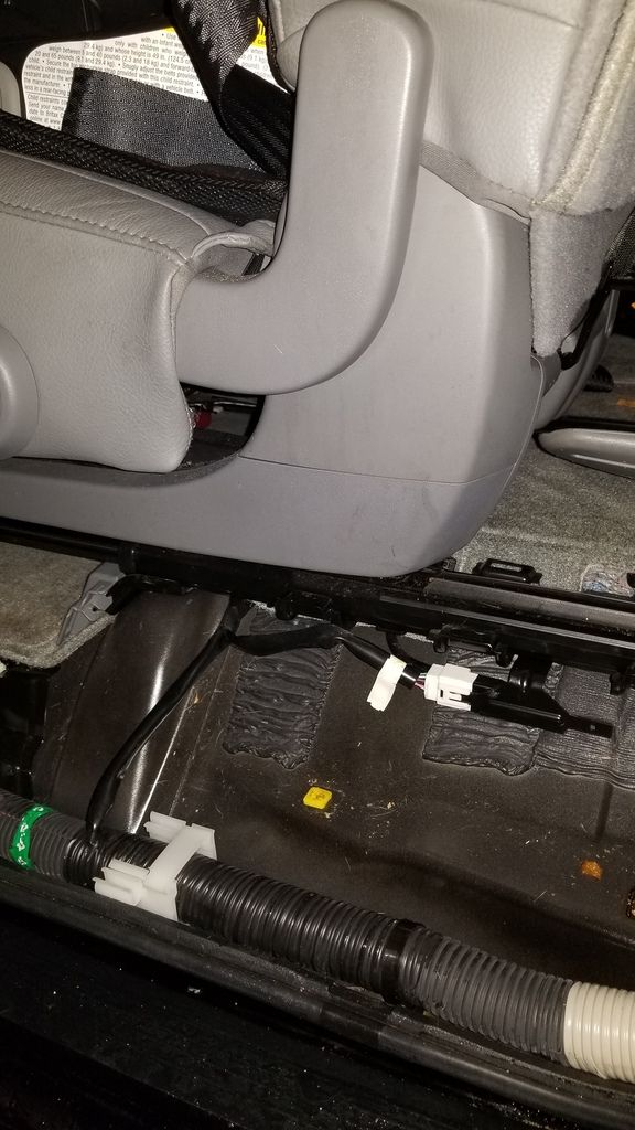

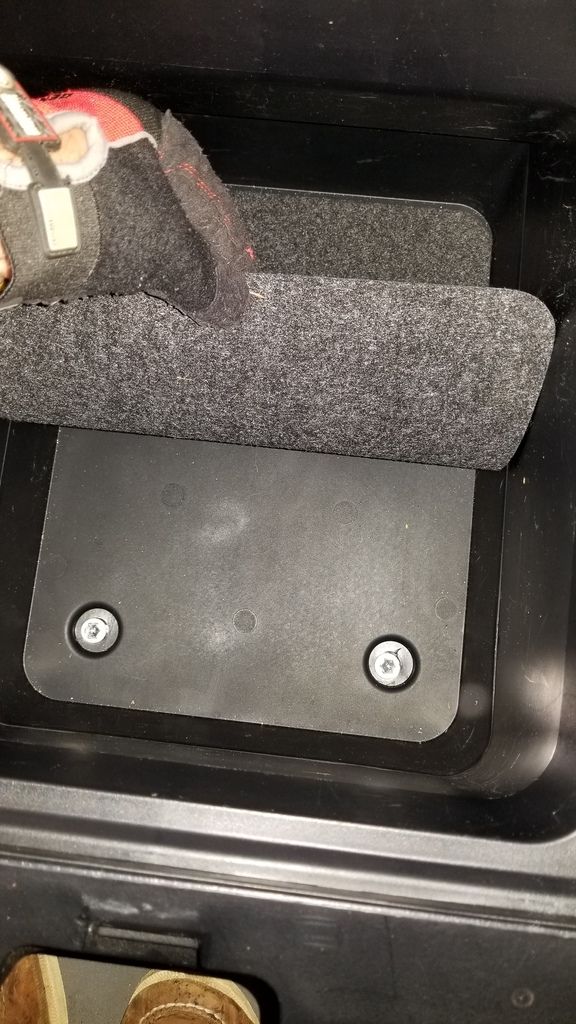

Last night I completed my installation. Thanks for the advice. Wasn't difficult at all. Center console has 4 10mm bolts, two under the felt inside the bottom of the console, and two under the trim near the cup holders by the seat warmers. Need to detach the seat warmers control cables on the seats and on the center console. The center console is bolted to two brackets that have 2 14mm bots each. The bolt holes from the brackets are where the middle seat bolts to. I just taped them up with electrical tape. I'll try to post some more photos and videos I took of the process.

Here are the brackets that the center console bolts to
Seat heater clips on seats

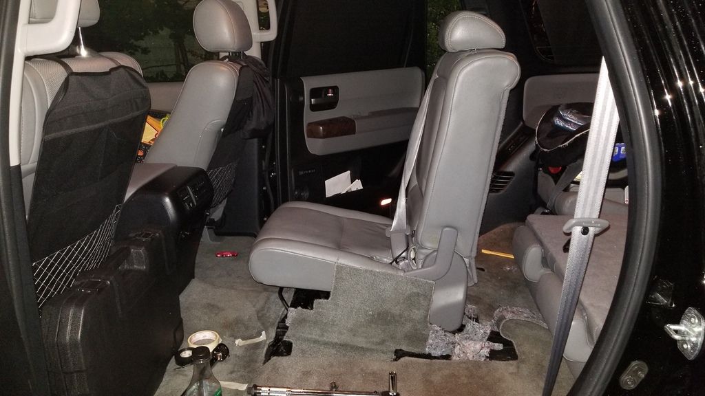

Seats and center console out
Middle seat is in some carpet trimmed away
Outer seats bolt up to exact locations of the platinum captains chairs .
Leather is the same color but is slightly different texture and not perferated like the front or back seats .

Discussion Starter #19
Wow great job Bill! Really wish Toyota had just come with a bench option from the start but they at least made it fairly easy to switch seats. The difference in leather texture is only slightly noticeable to us and since the color is so similiar I don't think anyone else who has ridden in the car can tell unless I point it out. And major Kudos on the center console took me forever to get those dang plugs out looks like you got it out in a sinch.
