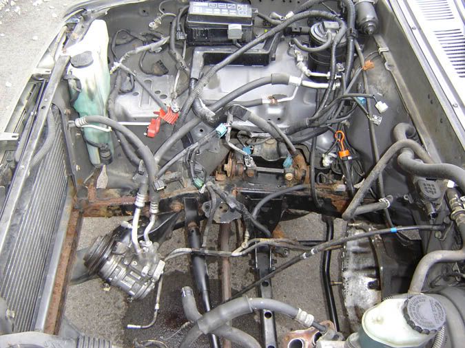

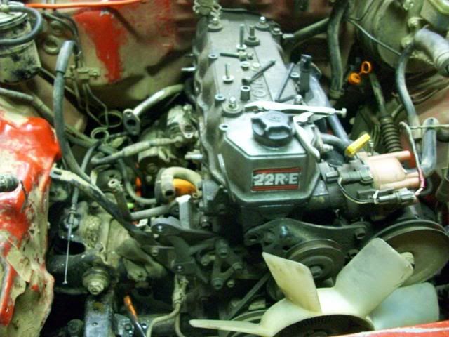

Well, after about 260,000 miles, the head gasket on the ole girl finally let out. Instead of simply replacing the gasket, I decided to lay down the coin and completely rebuild the engine. So i picked up a 94 ford explorer for $300 (which ironically blew its headgasket about a week ago :lol:), parked the yota, and went to work. For gaskets I went with Engnbldrs master kit with the 268 cam. It was kind of a bitch finding time around classes and work.. but i made do.. and a month and $700 later.. I'm happy with the results:
The engine pulled relatively smoothly... i was in such a hurry to get the block and head to the machine shop, i stripped it down so fast and forgot to get pictures of the process :rolleyes:

Finally got to drop her back in there... the NIGHT BEFORE i had to go on a week long business trip to Arizona... It killed me knowing that she was sitting there, ready to start.. completely across the country...
Shes not 100% finished.. i just needed it back on the road. But man am i happy with it.. Sounds great and feels better.. The cam is amazing!
Still gunna clean it up a bit. And Ive got a buddy with a dino that owes me a favor. So Im hoping to get some numbers real soon.
All in all it was a great project! A lotta time and work but im happy with the results and im glad to have my baby back :clap:

I'm curious why you took all the components off of the engine while it was still in the truck rather than pull it out complete and disassemble on a bench which wouldbe easier?
Because the intake has wiring all hooked to it so its easier to just pull that through the fire wall, unplug the connectors from the block and trans, pull the intake, then just have the block to deal with when pulling it.
When I pulled mine all I did was take the upper intake off to free up the wire loom and unbolted the A/C compressor so I didn;t have to refill the freon.

I'm curious why you took all the components off of the engine while it was still in the truck rather than pull it out complete and disassemble on a bench which would be easier?
The only serious and unnecessary thing i pulled was the lower intake. That was simply because i was anxious to get the engine started, and a buddy of mine had my engine hoist and wasn't going to drop it by my shop till the following day :thumbsdow Most other things (ac compressor, PS pump alternator) i just unbolted and pulled off to the side like you did.
How hard was it for you to set your timing?
Not bad at all! I missed the distributer location by one tooth at first, but quickly realized it, and it timed in real nice.
