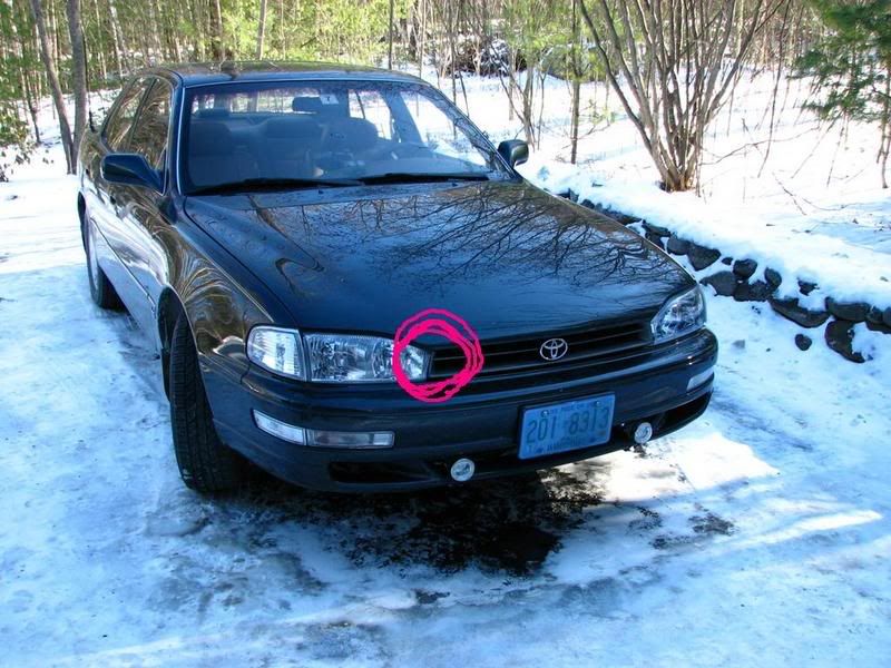

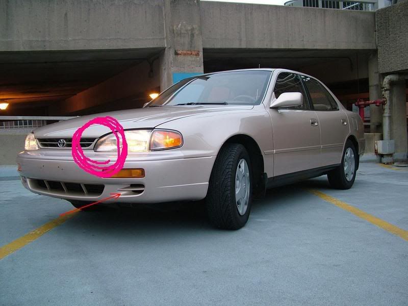

ive noticed that the depo clear lense has the tip cut off the light and realized i have a 3.5 car because mine arent cut like that...ive wanted to get rid of that stupid grill so will the depo lense fit if i make my own grill?
what i have
what the depo is
I HAS BOOST!!!

the gen 3.5 has a small lip under the the grille, on top of the bumper, that will have to be trimmed if u want to put the gen 3 grille on, and thus put in the depot lights in. if u dont trim the lip ull have a gap between the headlight and that lip even if u make ur own grille.

search, you have to cut your bumper and buy a new grille to make that fit. Try searching for depo lights or front end conversion- there are atleast 5 threads about how to convert on here somewhere ;)
