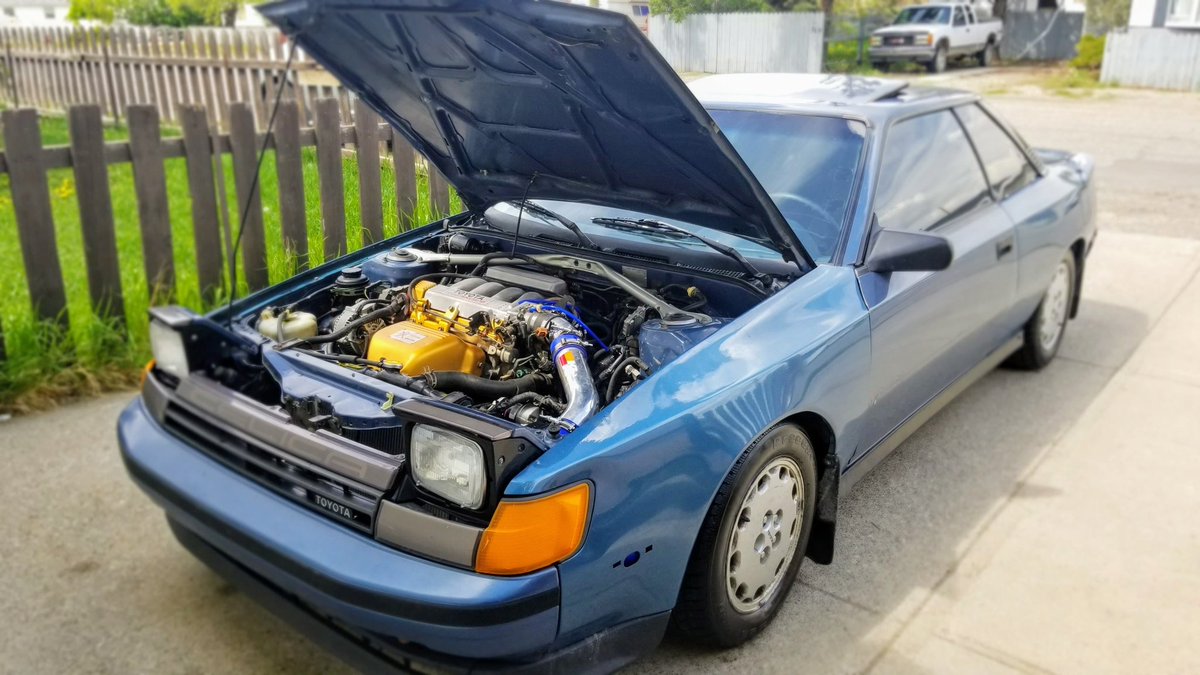

I have an 1986 Celica GT-S (ST162). The previous owner had put in a second-gen (91'?) 3S-GE and somehow managed to get a GTE harness to work with it... yeah I know. Well long story short, I'm pulling the engine as it started knock-knock-knocking at heavens door. I thought I'd be a nice time to put in an actual GTE, cuz' why not? I've been restoring the car so might as well give it a bit more power.
I've ordered a full engine/transmission assembly from a JDM ST185 Celica (only 50k miles). It was RHD- the importer said 'that doesn't matter' (hope he's right...). It comes with:
