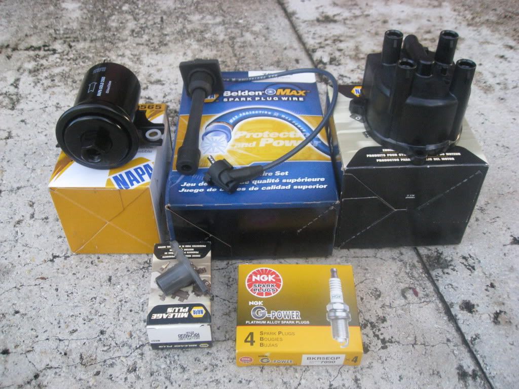

I'm gonna try to find the receipt. Ill get back to you. I actually just purchased these items on Saturday. I wanted to do a tune up since my cars been acting up.
is that the correct dizzy cap? i thought it's like this for 20V?
I have a 16v...oops didn't notice he had a 20v.
