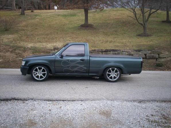

Yeah man im definately a fan of a drop.. My truck is on 17's with 3" blocks removed middle leafs, and the torsion bars are turned down.. I took my rear bumper off, and did a 4x4 front end conversion minus the grill... Here is a pic of it...
P.S. the front is a lil high im gettin ready to lower it more in about 10 minutes.
My drop is going to be 4.5" overall at all four corners
Front
Rear
Side

· <^-~*PIMP*~-^>
1993
719 Posts
Arved said:
Where are the 3" blocks? The rear? I'm a dope on these things.
When you drop the front with the torsion bars, doesn't that mess up the camber?
I don't want to trick out my truck too much. Maybe a little drop to make it easier to get in/out of, and make it easier to put stuff in the bed. Practical without stylin', like you are. :)
Take care,
The blocks go below your axle, you replace the u-bolts and that drops the back.... Lowering with torsion bars throws your alignment off.. SO once you do the t-bars you have to go get an alignment ASAP..
My truck isn't very practical if your wanting good quality without problems.. WHat i mean is that i have a 4 and half inch drop.. My truck drags everywhere.. I have to go over speed bumps at an angle...
If you want a nice stance, you could do 2" blocks in the rear, and match it up with the t-bars
