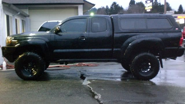

here's random pics of the madness and some specs:
everything after that is a blur. here are some random pics....
specs:
bilstein 5100's on stock setting/OME 886 coils/ 1/2" top plate spacers/ modified front diff drop/modified carrier bearing spacer
Total Chaos UCA's
Pro Comp AAL/fabtech shocks
Pro comp MT's/Rock Crawler steel wheels - 16x8
Airaid intake/Flowmaster catback
JBA headers (suck)
rock sliders
Allpro bumper/smitty XR8 winch
piaa 510's hella 500's
satoshi grill with grillcraft insert
raider canopy
bed lights with custom tailgate activated switch
yakima rack system
THULE rocket box
20% tint front to match rears
yellow lamin-x fog light covers on piaa's
tractor reverse lights
golight
that's the main stuff. if you want to get real nit-picky:
all weather mats, relocated trailer harness, black headlight mod, fog light mod, extended rear diff breather, extra d-rings in bed, toyota bed mat, dual factory fog light switches, de-chromed interior: (black trim pieces from base model truck) de-chromed steering wheel emblem, blacked out instrument cluster rings/tweeter trim rings, fj cruiser gauge pod, debadged exterior, trimmed body mounts, prerunner rear mud flaps, fj cruiser center caps plenty of scratches..

I notice you have the 5100s and 886s. How much lift did you get?
I am ordering and Allpro bumper (and when bonus comes m8000 warn winch) and have the 5100s with stock coils but I don't want more than 2" 2.5" of lift?
Wicked truck:thumbup:
^thanks
the bilsteins on the stock setting, with 886 coils, bumper and winch gave me just about 3" of total lift. i do expect the coils to settle though, probably a half inch to a full inch. when that happens, i'll put in some top plate spacers, or change the 5100 setting to .85
i'm really happy with the ride though, rides awesome.
