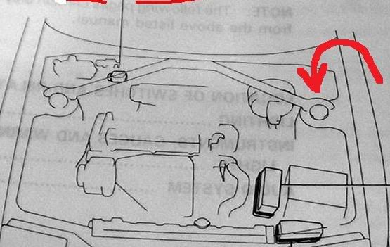

Your 87 Celica has a black diagnostics box mounted on the driver side strut tower.
If you flip it open, there are directions on the inside cover. You'll need about 5" of wire and two paperclips or spade connectors. Follow the directions and the check engine light will "blink" a certain number of times = giving you a code.

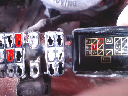

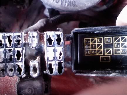

Which Pins?
SO here is a pic of whats under the cap for the diagnostic box. There is no TE1 or T1. Just a T. Which 2 do I jump together? I am also assuming the "goop" that I can't remember the name of is supposed to be there? And sorry for all the questions, but the guy on CelicaTech who wired the switch to his box mentioned checking the ignition timing. Will this be one of the codes that flashes? Now I am just waiting on the link for how to read the codes. I appreciate all your help and time Rick.
Josh

Josh, bridge terminals T and E1:
I fixed the links for you:
See here for a list of codes:
http://st162.net/forums/viewtopic.php?t=343
http://st162.net/forums/viewtopic.php?t=380
Note: we had a domain name change from .com to .net, so just replace the .com with .net and you should be able to see the correct links.
The goop is dielectric grease, mine has it too. It's fine, don't worry about it.
This check will not give you a code for ignition timing. You must check ignition timing separately with a timing gun.
