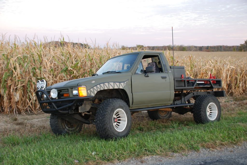

I picked up the truck today. The glass re-install went well and everything looks good. Should be put to the test with the rain coming this weekend. Went out for a drive tonight and got caught without my good lens. Was still worth a pic though. :cool:
