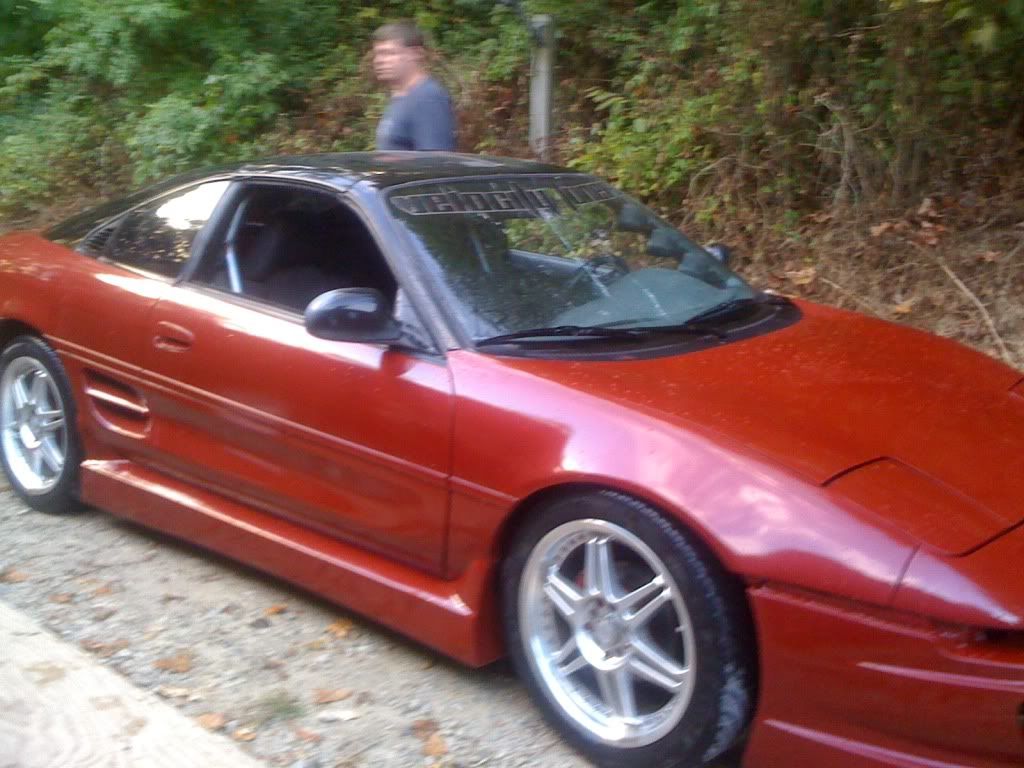

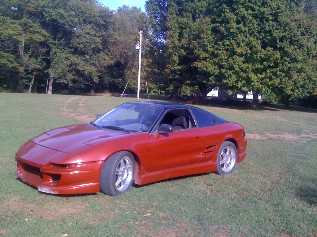

Alright, I went and traded my Camaro for an MR-2 tonight with a turbo, I don't know much about it because he had just received the car himself. It runs great, and I absolutely love it, it has t-tops, too which my Camaro also had. He said that it runs lean sometimes, and gave me an AEM F/IC fuel/ignition controller with the car which hasn't been installed yet. It has a fuel/air mixture ratio gauge in the car and in colder denser air the car seems to run quite a bit lean and it'll die.
My question is how can I solve this? And how can I hook this fuel tuner up? I'm mostly a small block chevy guy but I'm absolutely in love with this new car, so any help or suggestions would be greatly appreciated!

Good lookin 2 , BTW.
