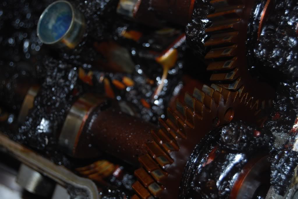

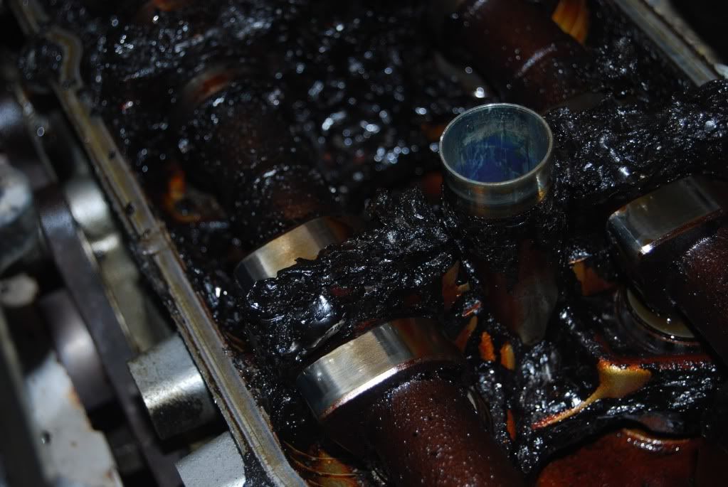

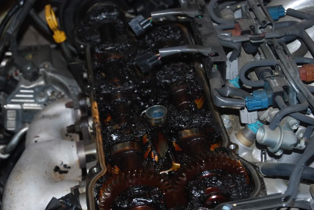

I have a problem and I need some advice before proceeding. My sons bought a 96 avalon with 82,000 MILES last fall and got their licenses this spring. They only drive it to school and back (2 miles) and generally are very good on cars. I noticed an oil spot on the place they park and started looking into it. I took the timing belt cover off, found some oil and continued to look, finally after reading online, i decided to pull the valve cover off and have a look at that seal. I had read about the 'gunk' lawsuit, but I have never in all my years of working on cars seen ANYTHING like this.
So. Please advise me as to what the next steps are. We have owned the car for only 2,000 miles and changed the oil / plugs and have babied it. Obviously this is a BIG problem.
I suspected something was wrong with the Oil pressure sensor because the light would flicker on and off sometimes (now i know why, clogged sensor)
Can this be repaired or am I just out of luck? I think cleaning all the passageways and pan isn't possible, without THOUSANDS of dollars in repair and the car is worth 2K. (i have 2K in it)
All I can say is...
"Oh what a feeling!!!!"
My sons are very sad, this was a good car... Now it's dead or at least too expensive to fix.
Brian

holy crap i am a toyota tech and i havent seen one that bad. maybe use kerosine or something to clean the engine out and hope for the best
holy crap! theres no words for that............. anyone know if the oilpan will come off with the engine in the car? if so u would try washing it out with something omg that is just wow. i wouldnt try "flushing it"
maybe a rebuild is in order and several days in a block cooker! lol
wow
:eek::wowza::yikes:
OMG, how is that possible?!?!?:confused: The previous owner for sure did not change the oil regularly. I don't think there is much you can do besides clean what you can. Can't imagine the rear bank.
CRAZY!!!!:eek:
That's what happens when you do very short trips and the engine isn't run at normal operating temperature for long.
2 miles is too short. If I have a short trip to make, I intentionally make it longer by just driving around for 10-15 minutes.
The previous owner must have done the same thing - short trips.
Reactions: 1
Jason is correct. Oil needs to get to a proper operating temperature for it to lubricate properly, without doing so will cause the oil to gum up and cause what you see in those pics.
Before I saw the pics I was going to recommend Auto-Rx which is a engine flush that slowly liquefies the sludge to prevent passageway plugging during cleaning. I read quite a few success stories with it. Your engine looks to me like it is too far gone for that, but you might contact the company if this is your last resort. http://www.auto-rx.com. Maybe a combination of hand removal of some the sludge and Auto-Rx will do it.
I think the Toyota extended warranty was 8 years or 100K miles, so you might want to check. You still might want to try even if you are out of warranty, the problem is have the proper maintenance records from the first owner - I think at least one oil change per year.
Man, those are like pics out of a horror movie; maybe you could sell them to Mobil so they could use them in their ads for Mobil 1.
I'd tend to agree with Edge10. I ran Auto Rx through my engine as a precaution but yours looks so bad I don't think I'd recommend doing that. I'd be worried about big chunks of sludge breaking loose and plugging up oil galleys, which, even if it happened for only a few seconds, could be catastrophic. Of course, as you know that could happen anytime, even without using the Auto Rx.
I hate to say it, but IMO you'd better start thinking about selling the car and moving onward. Don't dismiss Avalons because of this incident though. They're great cars...you just happened to get one that hadn't been properly maintained.
