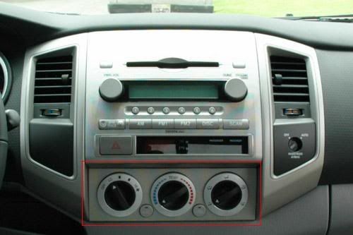

I was putting my stock stereo back in, and I accidentally broke the mounting tabs for the a/c and heater controls. Now it's just hanging. Anyone know where to get a new one at with the mounting tabs. They broke off and cannot be put back in. I've looked everywhere. ?????? Thanks guys.

maybe steel epoxy putty? I use that everywhere and it hardens fast in minutes and you can sand or trim the excess.
Get a tube cheap in the plumbing section of Home Depot.
Also, I found that instead of prying it out, a better way is using needle nose pliers to pull where you've removed the outer knobs. One side then the other.
