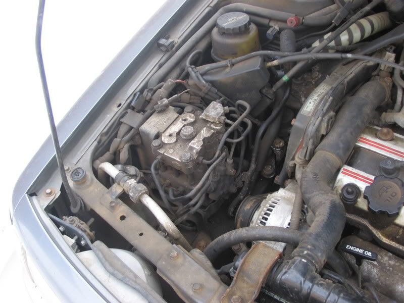

ABS was offered only on the wagons and V6 Camrys of the 2nd generation. In 1990 the Canadian market was offered ABS for the first time, while (as far as I've been told) it was not an option on US cars until 1991. So if your Camry is a 4-cylinder, non-wagon, you probably don't have ABS.
If you DO have ABS, you will definitely know it. With the hood open, look in front of the passenger-side wheel well. There will be a monstrous-looking device with hydraulic brake lines running out from it in all directions. This is the primitive ABS.
This is what it looks like on my Camry:
looks like ur power steering fluid is low LOL :lol:

Actually I skimmed your reply before I posted, otherwise I wouldn't have written such a redundant post!
And monito, you're right...the car has spent most of the winter sitting and I just noticed today that I'm low on ps fluid. Once the rack is replaced it never seems to be perfect again! :sosad:
