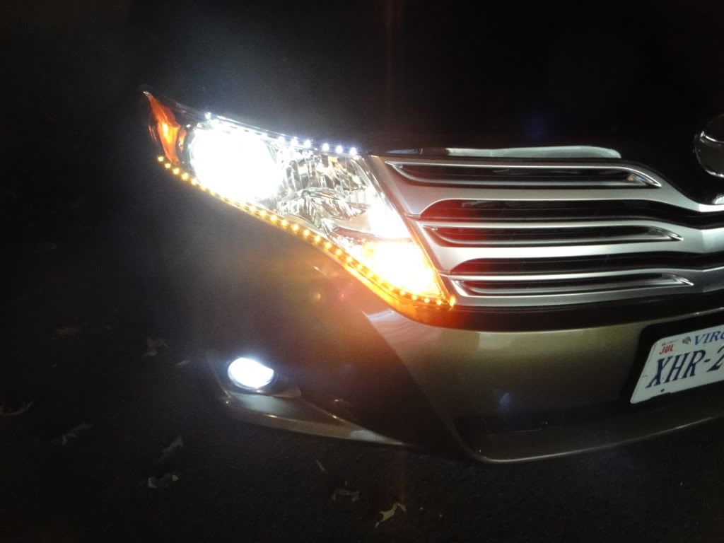

I add a turning signal led strip to the Venza and I think it really helps people seeing the turning signal or at least I noticed people are turning their head looking at my amber blinking led lights.
It only lights up when I flick the turning signal light on and it is not too tacky since most of the time it is off and you barely notice anything there (the strip is only about 4mm wide).

Here are the things you need:
1) Go to eBay and buy a pair of 60cm (about 24 inches long) "Amber LED strip". I bought this ebay item 150477834853. Disclaimer: I have no relationship with this seller so you are free to buy from just about any seller on ebay that sells led strips. Make sure you ask them how the led light are facing.
2) Get a pair of 18-22 gage "quick splice" from Auto Zone to tap into the turning signal wire.
3) Find the turning signal light wire. The turning signal light has three wires. I use the automobile wire testing kit to test the wire... my Venza uses the banded green wire as its turning signal.
4) Clean your head light housing. Peel off the 3M double sided tape on the led strip and carefully stick the strip along the bottom of your head light as shown in my photo. Do it from the outer edge of the head light toward the signal light since that is where your power source is. The Gap will be wide enough to pull the led strip along with its wire into the back of the signal light.
4) Test to see which of the two led wires is a positive wire and then use the quick splice to tap into that turning signal wire.
5) Ground the negative led wire to the body of the car (use the existing ground if you can find one) and you are done.

The led strip has a 3M tape on the bottom. Believe me or not, it is pretty strong after a couple days. The bottom strip will need about 24" long (the thin strip is better for the bottom part) and the top will need about 12"-14" long.

Do you want to put the strip on the top? The top you just get the 14" or 20" "side glow" strip. If it too long it can be trimmed off at every three lights.
The bottom one however, you definitely need 24" to cover the entire headlight contour and it has to be the thin led strip (thick one might be a little unsightly and not as flexible)...if you just want it white then this item #190495072764 thin LED Side Glow 24" will do.

Well, after six months it held up pretty good. The bottom one on the driver side need s little silicone gel (my fault for peeling it off and re-apply it back on when I first install it). However, the rest (both the top led) and the other side of the bottom are holding up well.
I took it through three car washes and it still holds up just fine.
