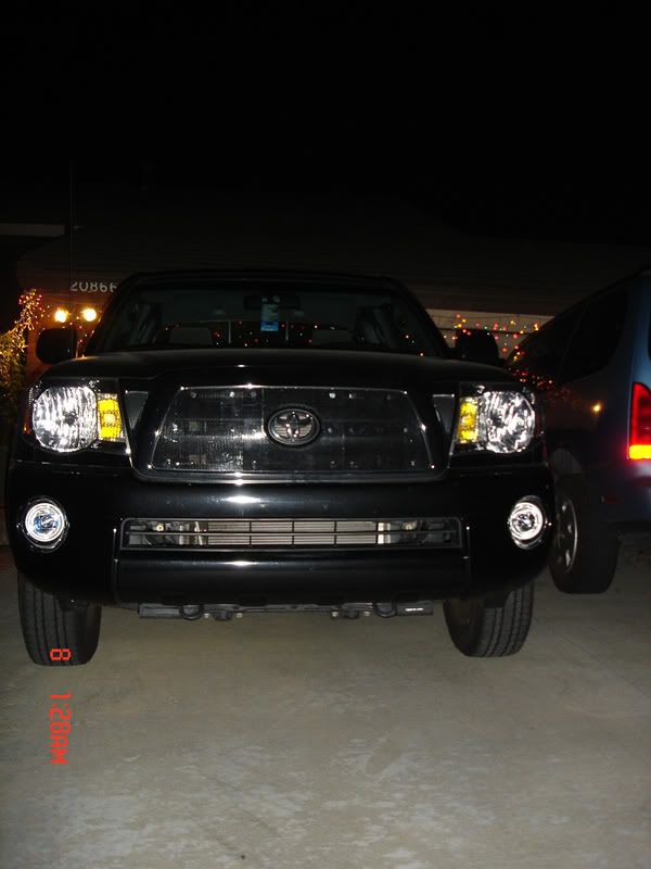

it didn't come with special mounting equipment, i just used hte brackets it came w/ and screwd it in. ill show some pictures let me upload them
