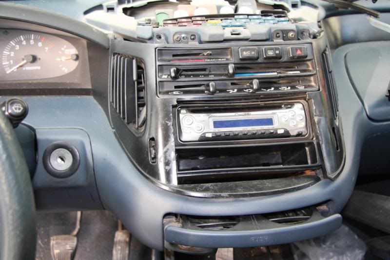

IF you go ahead and decide that you are going to remove the light, here is the way you do it.......
I said this was a 10 minute job... well, I forgot about two screws, so, add another 3 minutes to it to get the radio/ A/C bezel off......
These are the only two screws that hold the Cluster bezel in place....
Once the two screws are out... Pull carefully, but firmly. there is a little lip where my hand is... pull from there. there are three tabs that will let loose...
Once that is done, move over to the other side. A small flathead may help if you do not have fingernails. Pull twards you just a bit till the whole plastic piece can be moved to the right. wiggle it a bit to separate the vent out of its place....
From here, just pull it all up and out.....
Now you have the 4 screws that hold the cluster in. once those are out, you can pull the cluster out. If it is an Automatic, It will have the Shift indicater cable. you can either trace this to just under the dash and disconnect, work with it the way it is, or unscrew the indicater itself....
Reinstall is all the same, just opposite...
