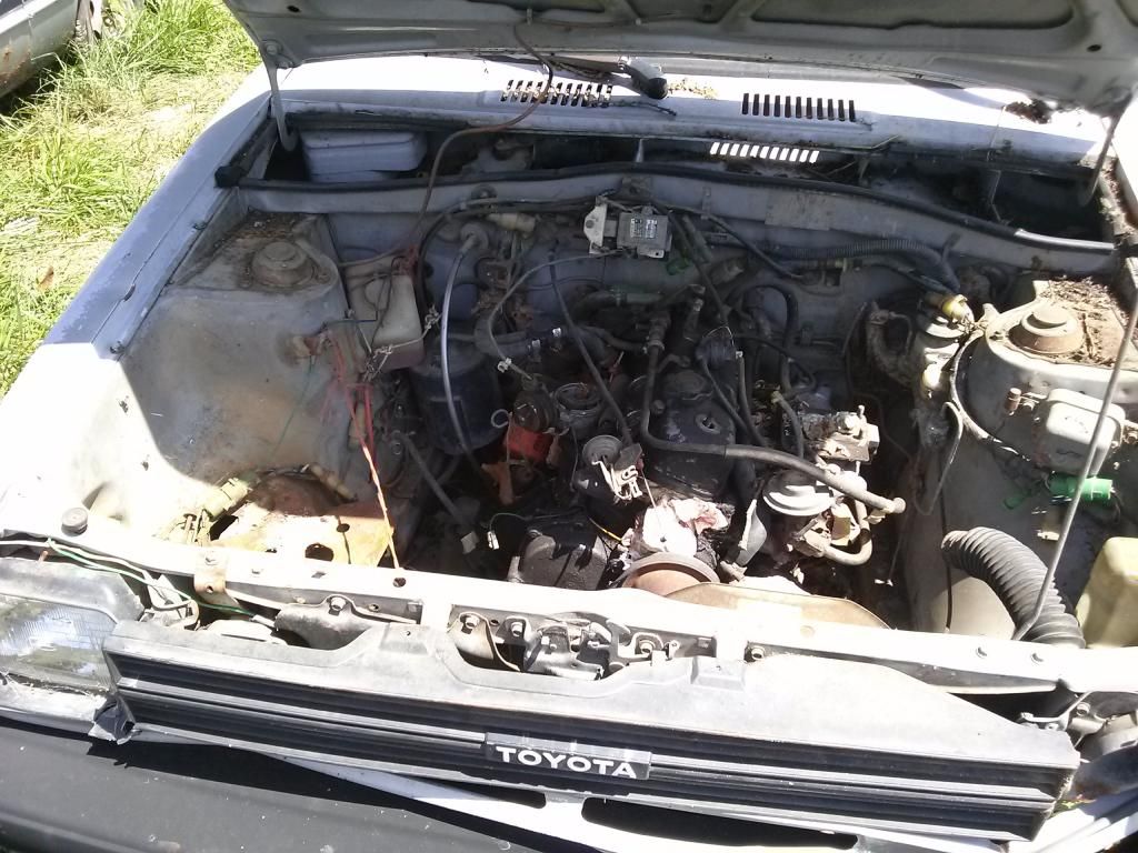

Back in August of 2014, 2 1981 Toyota Starlet's popped up on craigslist right down the road from me, for $400. Me and my brother went halves and both paid $200. He signed the titles, so they are in my brothers name.
There was a "good" car and a "bad" car. The good car had a bad motor but a clean body. The bad car had a good engine and rusty body and trashed interior.
The bad car when we bought it.
The good car. Unfortunately it was in a collision and the driver fender was messed up.

Good motor ready to go in good car.
Bad clutch. The bad engine had a pretty decent clutch on it so I used that.
Ready for engine.
Back in!
