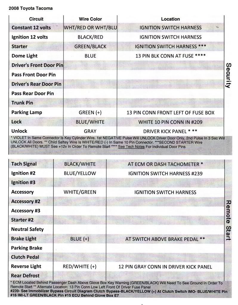

I bought the following from Crutchfield and it looks like I'm going to have to resort to doing it myself: Python 872 alarm system, and they included the XPressKit KX05 interface. They also gave me the following diagram. Hopefully this will all be relatively straight forward.....
