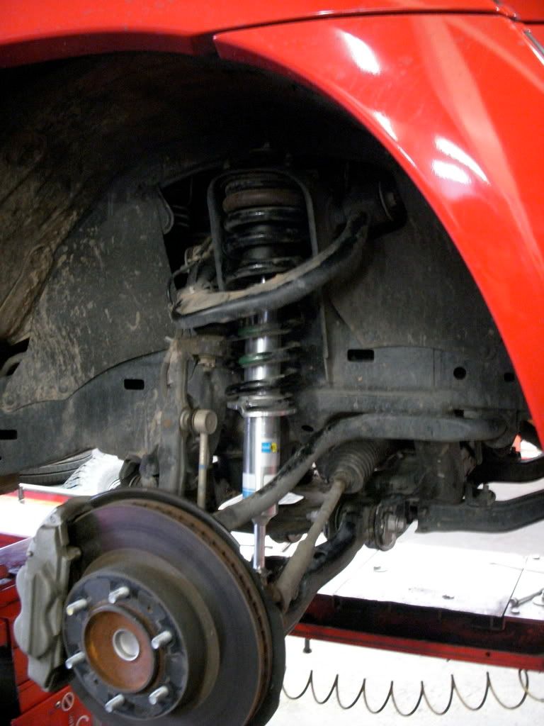

with just getting the tsb done i was thinking about buying some adjustable 5100s. i was going to use them as a little lift kit. i was wondering what a good height to set them at is? also do i need new uca's with them? and how do they ride, does anyone notice any vibrations or anything? if anybody has pictures of this setup could i please see them. thanks

If you want your truck level most people get the rear tsb and set the 5100s to 1.75
If you want your truck to be level with the 5100s set to 2.5 most people put a 1 to 1.5 inch block in the back if you want to go the cheap route.

Yeah what he said but tire size has nothing to do with whether or not you
need UCA's. Lift amount is. Stay with the 1.75" and you should be able to get a decent alignment without the aftermarket UCA's.
Haha, I just got done reading a post from you on TTORA and now your venturing over to the better site! Anyways, welcome. I have the 5100's set at 2.5 and the rear TSB and I have a slight lean with the front taller than the rear. So if you want a nice level look set them at 1.75". You wont need new UCAs because your not lifted over 2.5". People with 2.5-3 inch lifts don't need UCAs but they help with the steering feel and alignment.
As for vibes it happens hit or miss, you don't really know until you lift it. Mine doesn't have vibes at 2.5 but some people do. 1.75 might be less likely to get vibes because its not as big a change.
Also the ride is much nicer with the 5100s!

+1. I have the same setup w/ a AAL 1.5" in the rear from Wheelers and it is a tad taller in front, but I don't care it looks bad ass! The ride is smooth, no vibes, and no wandering. :thumbsup:
