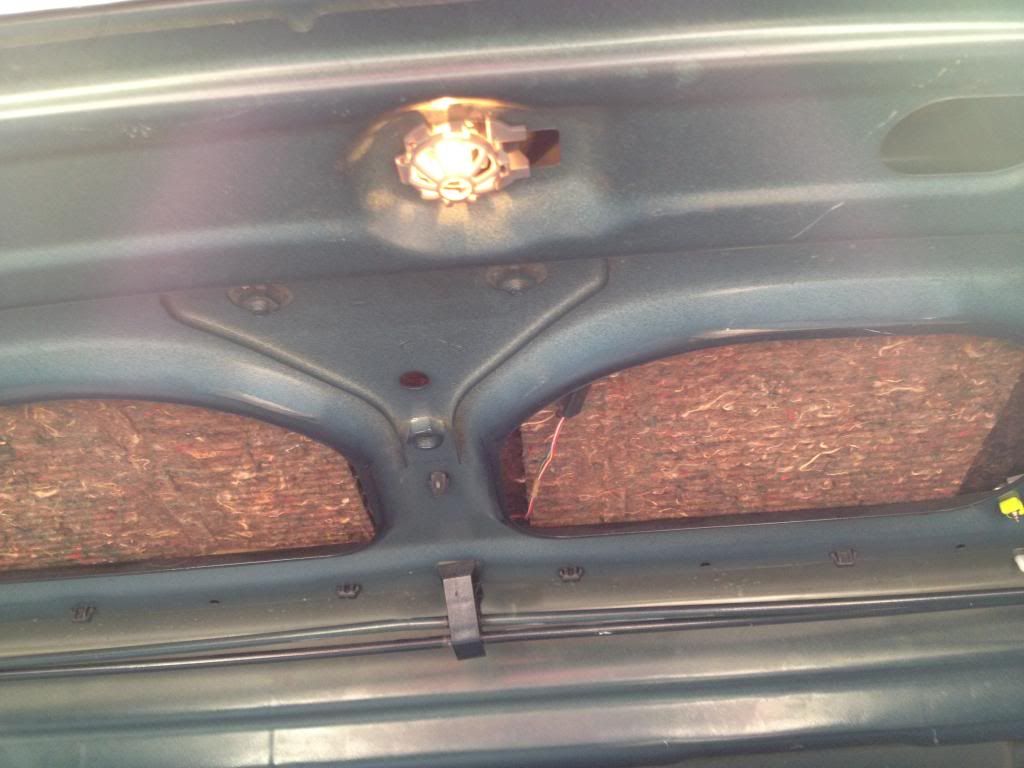

Trunk light.

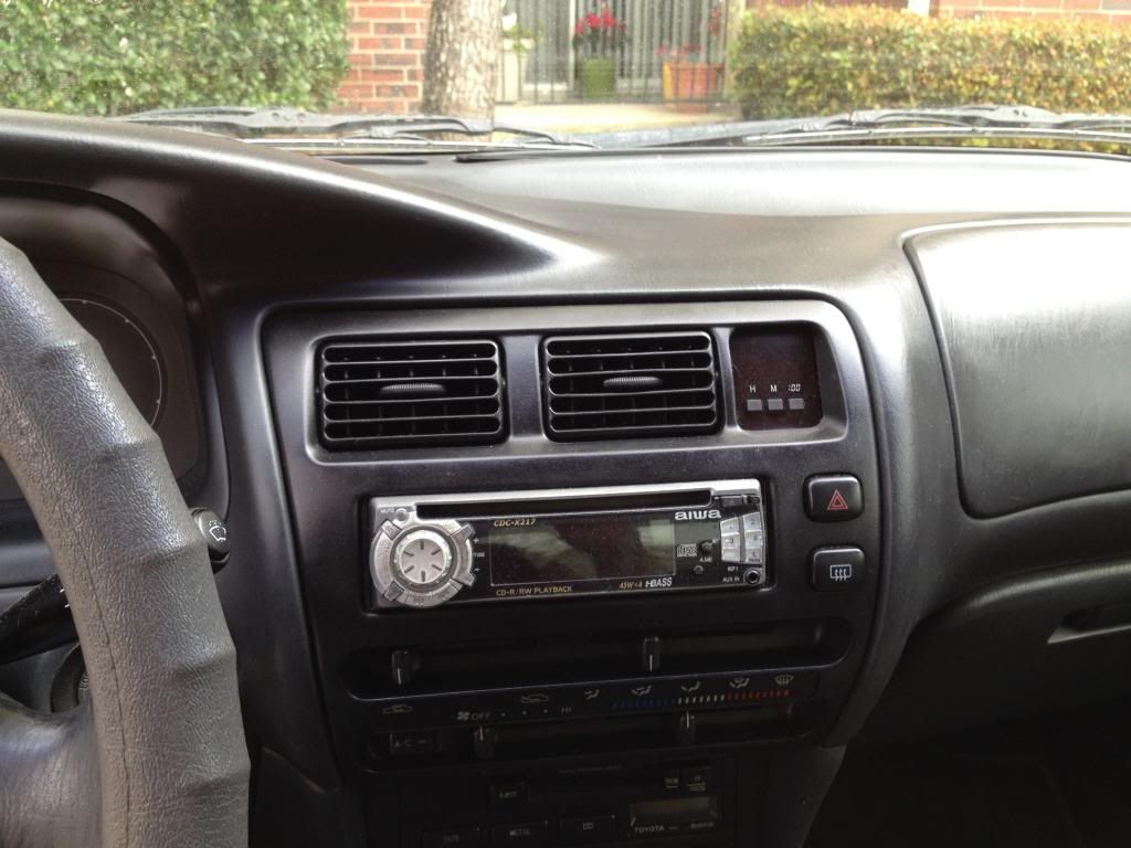

Clock

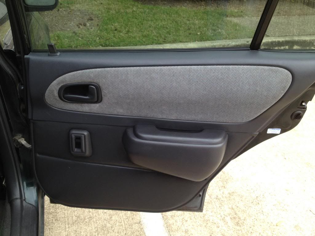

This was stock for the 1997 year, but I like how the door panels look versus the older models.
I had the window tint installed when I bought the car to help with the summer, and the blue garbage on the windshield is old tint. The windshield has 6 or so small chips smaller than a dime that were filled in. I was originally going to have the windshield replaced, so that tint was never changed out. I've also installed various screws/bolts/clips that were missing, upper air duct leading to the breather box, battery tray, trunk liner just below the latch, the trunk lid liner, cabin dome light cover, replaced a blank panel cover next to the cluster dimmer control because it had a light for an alarm, removed the old car alarm. I might be missing other little knick knacks. .
