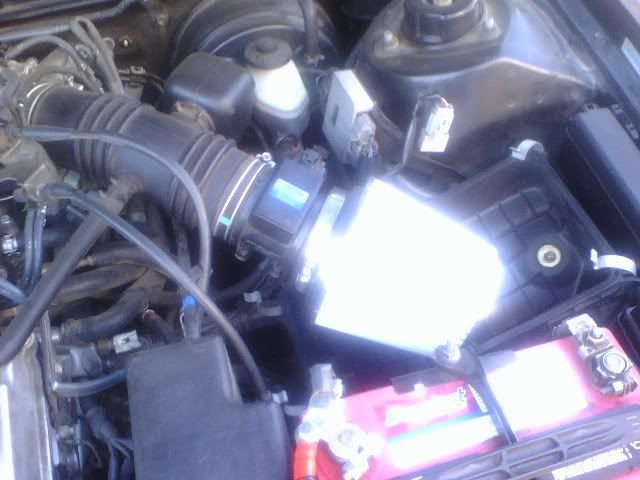

how do i install a cone filter onto a stock intake? i tried taking out the air flow meter so i could put in the cone filter but it makes the car shut down after a few seconds and if i take off the box that connects to the stock CAI and the meter theres no way to install the filter, any pointers? i kinda made a thread about this before but i didnt really know what the meter was and mistaken it for a sensor:hammer:

Are you saying that you removed your air flow sensor and put a filter there instead? Please tell me that I'm tired and read that wrong. You should be able to remove the stock airbox from the pipe and then clamp the cone filter to the end of the pipe after the sensor.
you can also get a small piece of 3" tubing from any auto store and use that to extend the filter out a little and allow for easier fitment.

yeah, i know i put it back and its working fine, what im saying is how am i going to connect the filter to the sensor since the connection from the sensor to the airbox is square.

are trying to do some thing like this...
pretty much but at the end of that airflow meter its a square with 4 screws at the end of each corner so im not sure how it would attach
hmm.. not sure but MAYBE their might be an adapter plate for it?
i've seen them done on i4s mostly because their airbox that connects to the air flow meter is round(?) and im not sure if ive seen one done in a v6 before but i'd be great if someone who has done this could show me
You can also get one at autozone. The one from autozone is alumin.
i did that on my 95 1mz.
