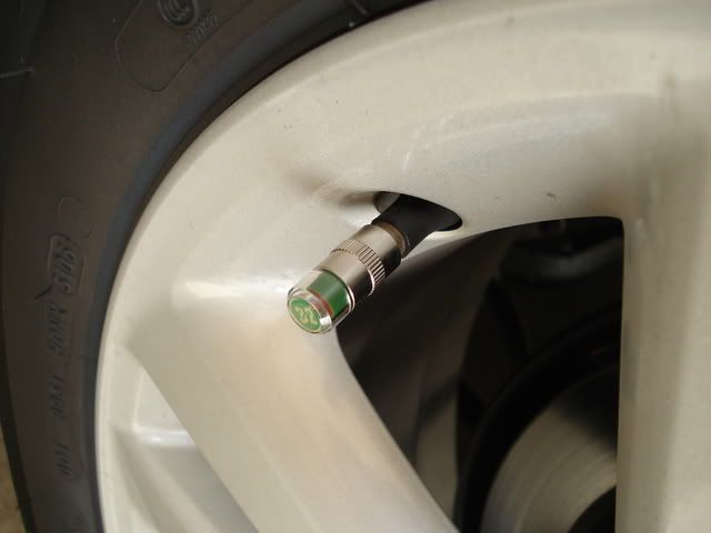

Tyre pressure monitoring
had my new Highlander Hybrid for a week now. (Previously a 1998 RAV4). Man I'm pumped. It's a nice ride.
My Highlander came with little wotsits (yea, I'm technical) on the tire inflators. They show green when the tires are at the right pressure and shift through yellow to red when the pressure drops. They simply screw on to the existing stem (I know there is a word for that, but I just can't remember it tonight).
Anyone know what they are called and where to get them? I'd like some for my other car too.
If it will help I can post a picture of what I'm talking about.

Is your "other" car equipped for tire pressure monitoring systems? If not, you can't just put the sensors in your rims and assume that they will work.

tirecheck
I'm going to guess you're looking for valve stem caps with a pressure indicator built in?
The brand I've seen is tirecheck. You can probably get them at most auto parts stores, you can find them easily on the internet.
For what it's worth, you shouldn't need them on an 04+ highlander, as they have a tire pressure monitoring system built into the vsc/abs computer on the vehicle.
3,116 Posts
TPMS is built into your HL...but the tirecheck's are good in that they can show that ur tires are properly inflated.
TPMS on the HL (not sure about the brand new 08), only turns on if the pressure is very low or if one or more wheels is 2+ psi different from the others. So if u like 35psi for your pressure, TMPS will not turn on till probably 28 (i think is the factory default setting).

First, let me apologize for posting in the wrong forum. I thought it was generic enough (tires) not to really belong in the Hybrid forum.
I'm pretty sure (just checked the owner's manual) that I don't have any fancy TPMS system on my vehicle. I got the low-spec one without many frills, they're expensive enough as it is. Also, the reason this came up is I have a slow leak in one of the tires and when I added air yesterday, there was practically no pressure in the tire, yet I had no warning systems inside the cabin warning me.
So I suspect the dealer gave me a freebie el-cheapo TPMS (he mentioned something about it being a $30 value, but I wasn't paying attention). I'm pretty sure it's not vehicle-specific, they simply screw into the valve stems.
Here's a pic if that'll help.
See the red? I'm going to visit the tire repair place after I finish this post. :)

Anyways as far as i know, all highlanders regardless of trim have TPMS because its a reading based off of the ABS speed sensors. The more accurate and specific TMPS systems that are on i think the brand new 08 HL have a sensor in the valve stem which can measure specific PSI for every tire.
The older Highlanders such as the 2005 model we have V6 2wd (base model), use the speed sensors, and typically it takes around 10-20 miles of driving before it sets the sensor off, unless you have a severe loss of pressure. So when you pump the tires up, park the car, and restart the next morning the light will not turn on till you've driven the car x amount of miles (provided that you have lost over 2psi for any particular tire).
i hope this helps.
Our sensor kept on going off because i typically like to use different pressures for the front and rear of vehicles so by using 35 in the front and 32 in the rear, that was enough to set off the sensors. We couldnt figure out how and why this was happening so we took it into the dealership and a mechanic explained it all to us.
Since your vehicle is new, check your owners manual for the low tire pressure indicator symbol that should appear on your instrument panel.
Good luck, and if your car is new, take it back to the dealer and have them take care of the tire for you.
This Space For Rent
14,153 Posts
Those look like aftermarket "sensors" (I use that term loosely :)). They just tell you what your tire pressure is. It's the poorman's version of the TPMS. How much did the $tealer rape you for those things?
