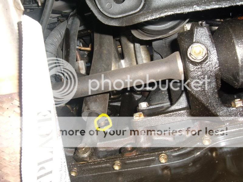

and now back to subject... where exactly is that drain plug on the back of radiator ? what am i looking for ? someone take a picture please ? i don't want to unscrew something important :eek:
