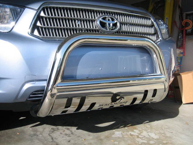

I have a Black Horse Bull Bar on my 09 HH.

Bull Bar
It looks nice. What does it do (is it just for looks or does it protect the vehicle somehow)?
