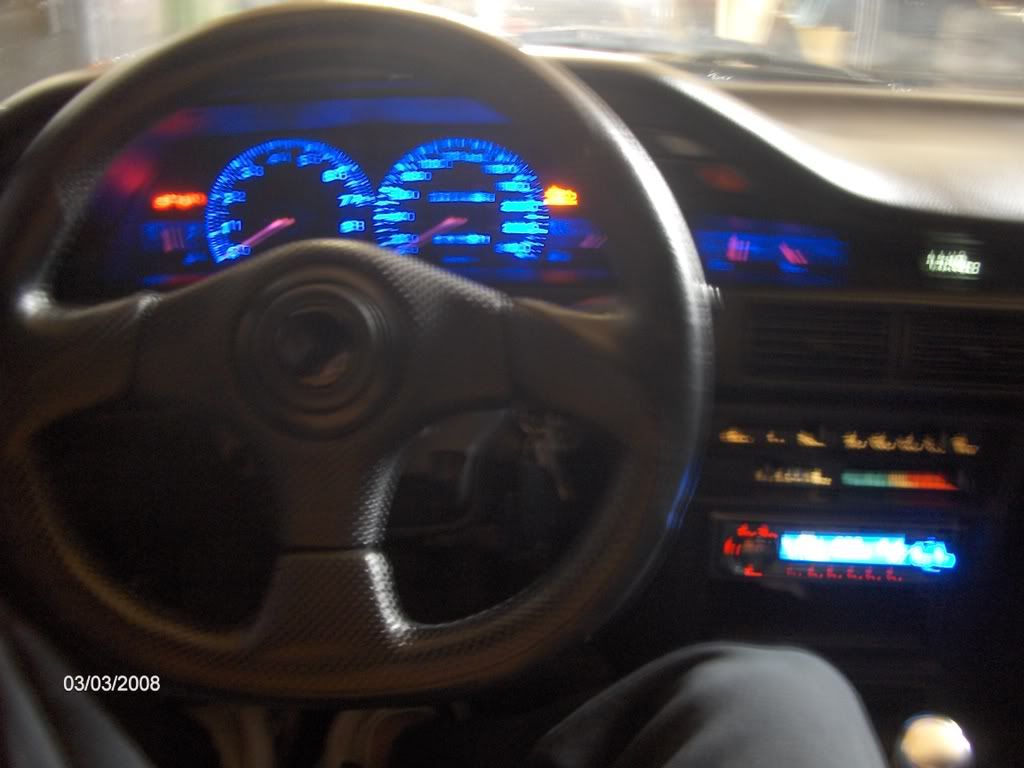

What do you guys think about my new dash lights??
Just put these in the other day!:D
Sorry about the blurry pic^

They're too blue to my liking, maybe if they were more clear-white-ish I would approve. :)
Good thing you got rid of those rims, chrome = :ugh3:
yeah I am also not a huge fan of blue, my radio is and it's rather distracting
ill give it too ya. i like the blue. probably look good in mine with my blue interior
it's a little bright for me but 2 thumbs up on the idea and effort.
It looks bright in the picture but its not really that bright. My camera has light enhancing features or something
blurry pic...had too much coffee huh. lol
just kidding. :)
Hey man I really like the lights. I am more of a red fan but I dig the bright lights :)
Yeaa! The blue lights r tight! Umm.. do you think you can post up some step by step instructions on how to do this? And what is the model # of that light bulb? Thanks!! :thumbup:

Here's what I mean by whiter rather than blue.. this is Xenon's old car with.. you guessed it, Xenon bulbs in the dash lights instead of regular 194 peanut bulbs. :)

I love them and I'm mad jealous! The only thin stopping me from getting LED lights is the short life it has as compared to OEM lights. Otherwise, I'd be getting them.
are you kidding brother? LED's will outlive your car! Only annoying part is making sure the polarity is correct while installing them.
Yeah, LEDs should easily last 200-years.
Problems with them come from implementation issues. Such as improper current-limit resistors and overdriving them without adequate heat-sinking.
