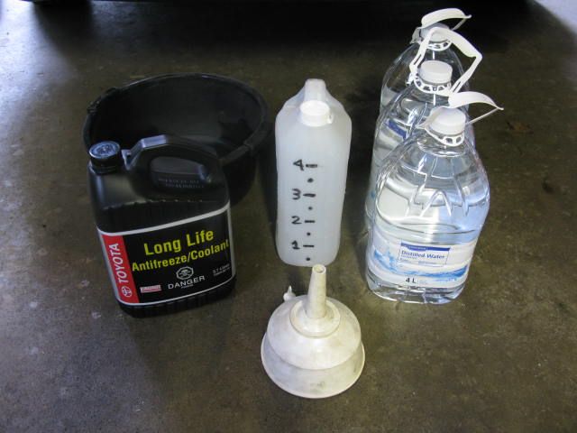

Tools & Supplies:
a) 3.7 liters Toyota Long Life “red” concentrated coolant $27.57
b) Three(3) 4 liter bottles of distilled water $2.97
c) Empty container with markings every ½ liter (optional)
d) Funnel
e) Drain pan
Total = $30.54 (13% GST included)

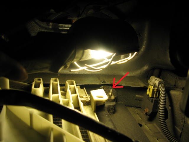

1. Locate the drain cock (red arrow) on the bottom of the radiator. This is a photo standing in front of the vehicle, on the driver side, looking down the back of the radiator.

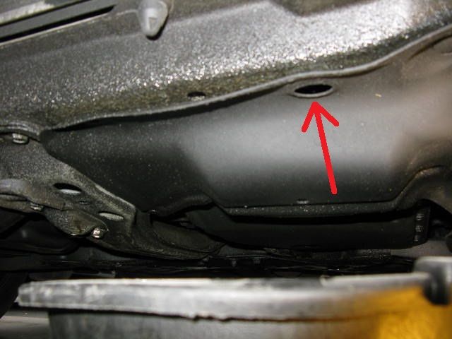

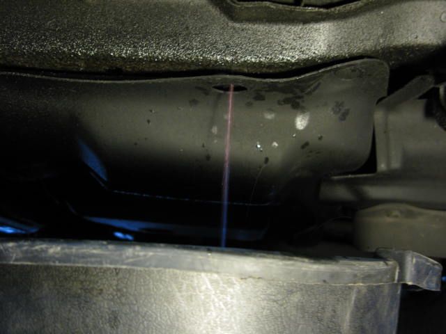

2. Place a drain pan below the hole in the bottom of the plastic engine shield (see red arrow). There is no need to remove the engine shield. This photo is taken from the front of the vehicle, on the driver side, at ground level, looking up at the plastic engine shield.

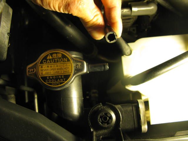

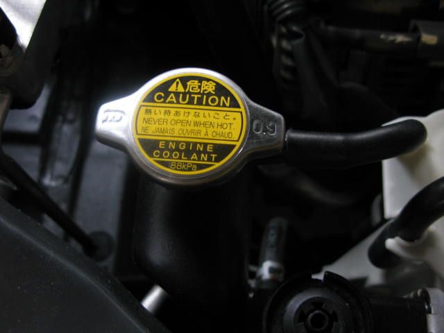

3. Remove the radiator cap. CAUTION… If the engine is hot, wear a pair of gloves and use a rag to cover the cap. Partially open the rad cap first to relieve any pressure inside the radiator, before removing. Wipe clean the radiator filler neck and cap of any dried up coolant sediment.

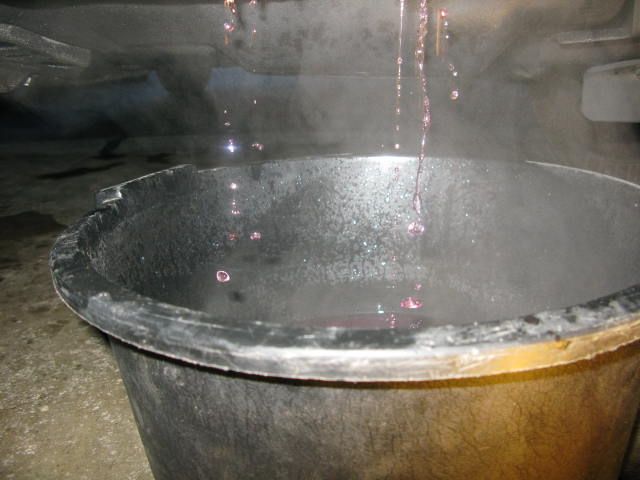

4. Open the drain cock a few turns and let the coolant drain out. To speed up the process, you can remove the drain cock entirely when the flow of coolant slows down. After about 5 minutes, when the coolant stops flowing out, replace and fully close the drain cock. Approximately 3.25 liters (3 quarts) of coolant drained out during this step.
Engine coolant contains dangerous chemicals that can be harmful to human/animal health if ingested and is also harmful to the environment. Do NOT dump your old coolant on the ground, or pour it into the sewer or into the toilet. Collect it in containers, clearly label it and take it to your local hazardous waste depot for proper disposal. In our city, the hazardous waste depot is located at the landfill site. They will take up to 25 liters of hazardous waste free at the depot. Some local garages and auto parts supply stores may also take your old engine coolant. Doing your own automotive maintenance is no excuse for being environmentally irresponsible. Please dispose of your old coolant in an environmentally responsible way.

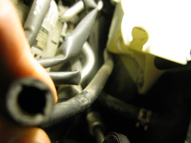

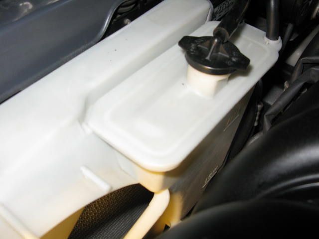

5. Pry off the radiator overflow cap from the overflow tank. On the 2008 Corolla, the overflow tank appears to be molded into the radiator fan cowling. It did not look very easy to remove. Also, there are plastic tabs molded into the inlet, making it difficult to suck the coolant out of the overflow tank.
6. My overflow tank was completely empty, so I did not have to drain it to replace the coolant. If you need to drain yours, remove the hose from side of the radiator fill neck and drop the hose into a small collection container.
7. Replace the hose and fill the overflow tank to the “FULL” mark with a mixture of 50% coolant and 50% distilled water. To do this, I used a measuring cup. To fill the tank from empty to the “FULL” mark requires about 0.5 liters (16 oz) of coolant/distilled water mix.

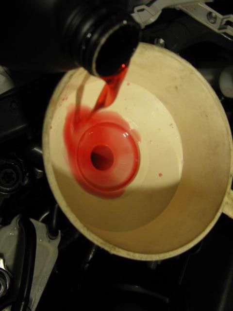

8. Add distilled water to the radiator. Fill the radiator to about 1” below to point where it will begin to overflow. Start the engine. Place the heater temperature control on the maximum setting, to ensure that the coolant in the heater core is mixed with coolant from the engine. I left the fan setting on low to minimize heat transfer, but still enable me to feel heat coming out of the interior vents. Let the engine idle until the thermostat opens and the coolant begins to flow through the radiator. Squeeze the upper radiator hose a few times to “burp” any air out of the hose.
On my other Toyotas, the radiator fill neck is positioned directly above the top tank on the radiator, so it is easy to see the coolant begin to flow when the thermostat opens. On the 2008 Corolla, there is an offset in the filler neck of the radiator, so it is not easy to tell when the coolant is flowing. I let the engine idle for 20 minutes, occasionally rev’ing the engine up to 2000 rpm for 30 seconds at a time to promote coolant to circulation. The upper and lower radiator hoses were hot to the touch.
Shut off the engine and drain the coolant. Be careful. It is hot.
9. Refill the radiator with distilled water. Repeat the process two more times. On subsequent fillings, I only ran the engine about 15 minutes each time. After three dilutions (ie. drained the radiator four times), theoretically there should only be 12.5% of the old coolant remaining. The effectiveness of the dilution diminishes with each draining. You can see the colour of the coolant gets progressively lighter in the above photo.

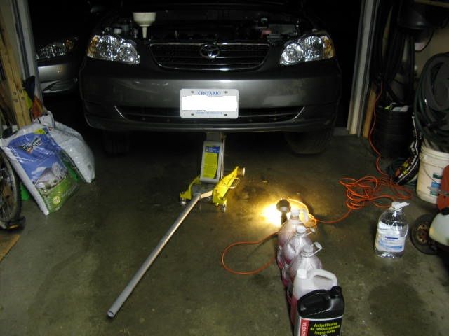

10. Jack up the front of the vehicle and place it on safety stands. Elevating the front of the vehicle is not essential, but helps to release trapped air in the coolant system. Slowly fill the radiator with concentrated coolant until the level is about 1” below the top of the radiator filler neck. Start the engine. When you run the engine, the coolant level will first rise and then fall. I usually have a turkey baster in hand and keep an eye on it. If the level starts to rise above the top of the filler neck, I suck a bit of coolant out with the baster and dump it back in later when the level drops.

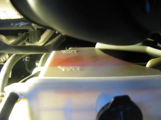

11. After running the engine for 15 minutes (or until the thermostat opens), shut off the engine and replace the radiator cap.
12. After a few days of driving and allowing the engine to cool overnight, I checked the overflow tank. The level was below the “LOW” level. It is difficult to see in the photo, so I added a red arrow showing the fluid level.
13. Top up the reservoir tank with 50/50 coolant/distilled water mix until the level is at the “FULL” mark.
