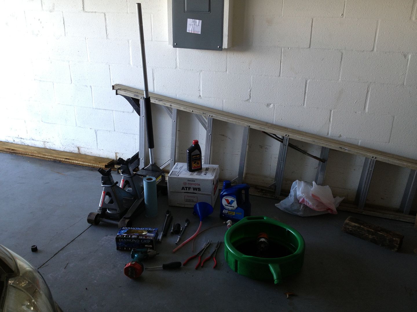

Tools and Parts needed:

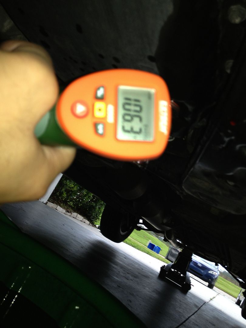

Note: You will need to use at least one of the optional methods to check fluid temp. This means either the Techstream, paperclip, or thermomemter.
1/2 drive 15/16 or 24mm socket
1/2 drive ratchet
1/2 drive extensions (the more the better)
3/8 drive 10mm socket
3/8 drive 6mm hex socket
3/8 drive ratchet
Flat head screwdriver
Needle nose pliers or angle nose pliers
Hose pliers or a very small pocket flat head screwdriver
Drain pan
1-2 Feet of 3/8" or 7/16" ID (7/16" Preferred) Rubber ATF Cooler Hose Section (2GRFE V6 with U660E)
1-2 Feet of 5/16” ID x 7/16” OD Clear PVC/Vinyl Tubing (2ARFE I4 with U760E)
Measuring container or jug to measure roughly 1 quart of fluid (I used the graduation lines of a 5 quart Mobil 1 jug)
12 quarts of ATF
Jack
Jack Stands
Long reach narrow tube funnel or small fluid hand pump to fit into dipstick tube
Brake parts cleaner
Non Contact IR thermometer that can read at least 150 degrees Farenheit (one option)
Toyota Techstream Software (one option)
Paper Clip (one option)
Gloves
New splash shield clips (if necessary)
New fill plug and inspection plug gasket (if necessary)
Rags or towels

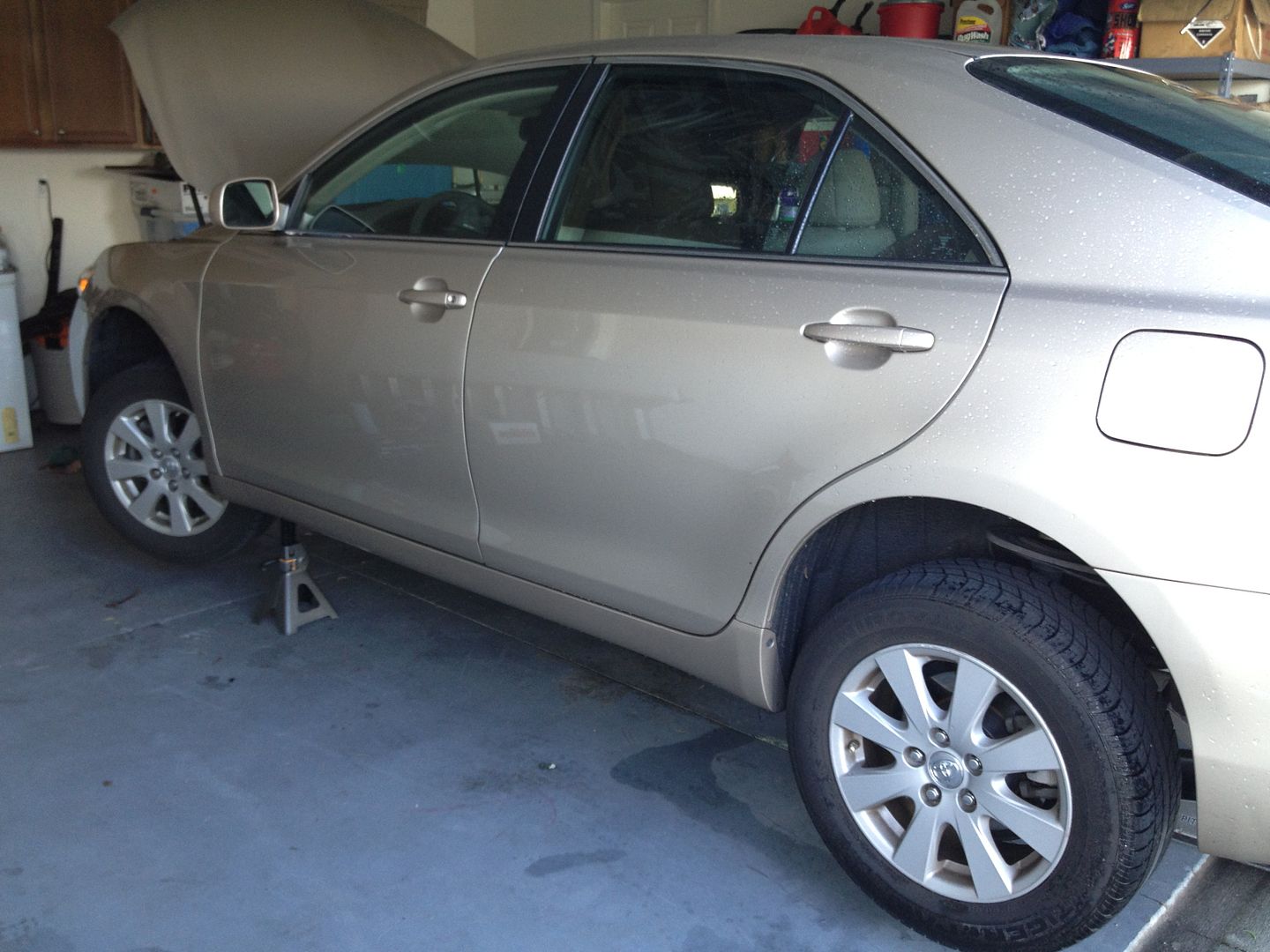

1. Drive the car around the block one time to warm up the fluid then park the car on a level surface, set the parking brake and place the selector in park. Shut engine off and open the hood.
2. Jack up the car and secure it on jack stands. I like to use the nub located on the front subframe to jack in the front. The nub is located about center of the car. Lower the car onto jack stands on the pinch welds or frame rails.

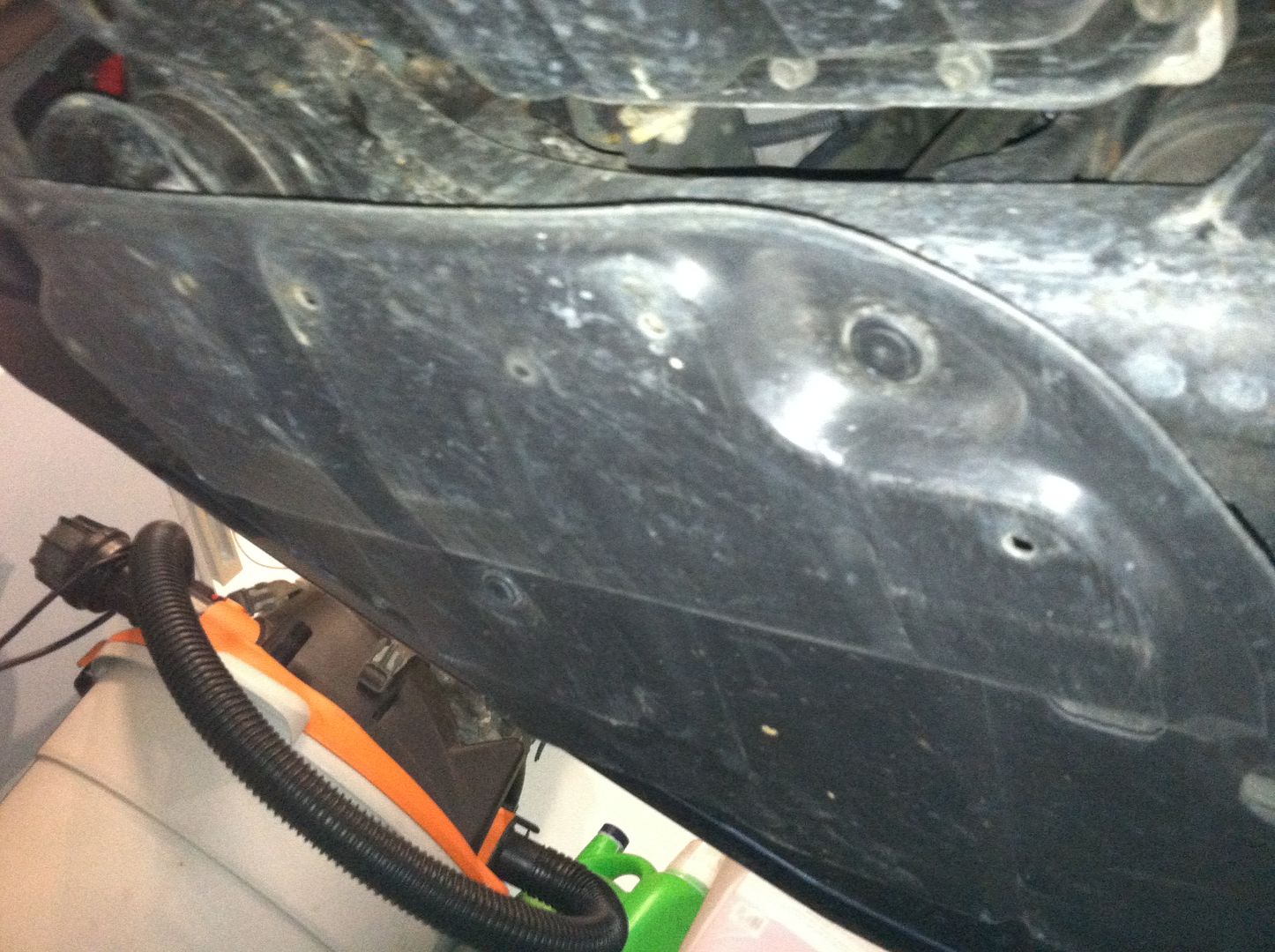

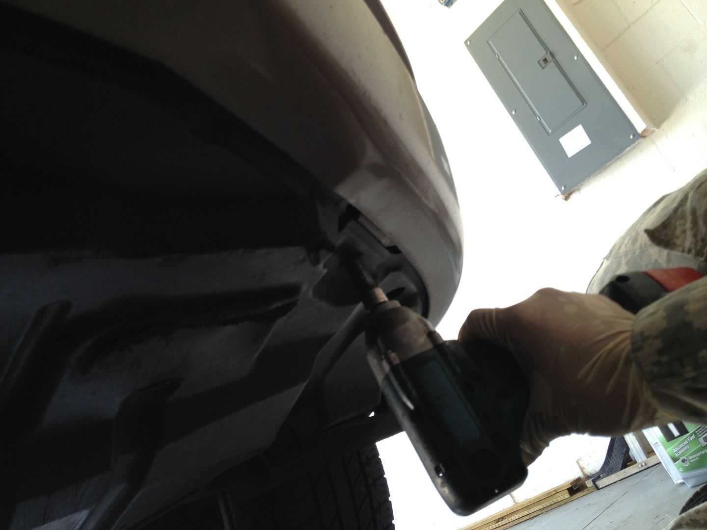

3. Remove the driver side lower splash shield. Depending on who has worked on your car previously or any kind of curbs you may have hit some of these may be missing. Here is when it would be a good idea to have extra clips handy (I broke 2). Using your flat head screwdriver remove the 3 push clips holding the splash shield by prying out the center section and removing the clip. Remove the 5 10mm screws securing the splash shield and small mud guard piece to the car and remove the splash shield and mud guard.
4. Remove the driver side inner splash shield. Turn the steering wheel all the way to the left. Remove the inner splash shield by removing the 2 10mm bolts using your 10mm socket and ratchet or impact and 1 plastic clip by depressing the center of the clip down until it unlocks and then using your fingers or screwdriver to remove the clip. Remove the inner splash shield from the vehicle.

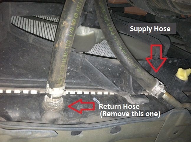

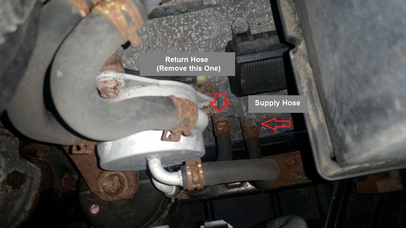

5. Remove the transmission return hose from the radiator/transmission cooler. Locate the cooler hoses which go from the radiator to transmission (2GRFE V6 with U660E) or transmission cooler to transmission (2ARFE I4 with U760E). On the 2GRFE V6 with U660E the return hose is towards the driver side and the supply hose is towards the passenger side. On the 2ARFE I4 with U760E, the return hose is towards the passenger side and the supply hose is towards the driver side. To verify which outlet is the correct return hose outlet, remove both hoses from the radiator/transmission cooler outlets and set them into a bucket. Briefly start the engine for around 2-3 seconds and observe the hoses. The hose that has fluid pumping out is the supply hose and the hose that does not is the return hose. Then reconnect the supply hose to the cooler supply hose outlet and attach your hose section to the cooler return hose outlet (2ARFE I4 with U760E) or vinyl tubing to the return hose itself (2ARFE I4 with U760E).
To remove the hoses, using your needle nose pliers depress the ears of the hose clamp and slide the clamp down the hose (angled needle nose are priceless here). Using your hose pliers or very small pocket screwdriver break the hose and line seal and slide the hose off of the line.
NOTE: It is a good idea to have your drain pan and container in position here to avoid spilling fluid on the ground.
2GRFE V6 with U660E:
2ARFE I4 with U760E:

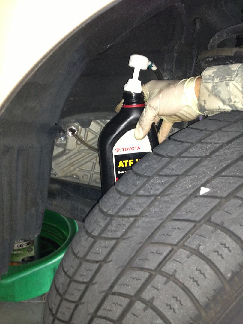

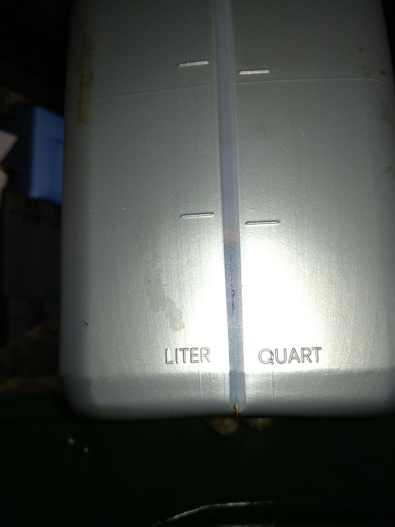

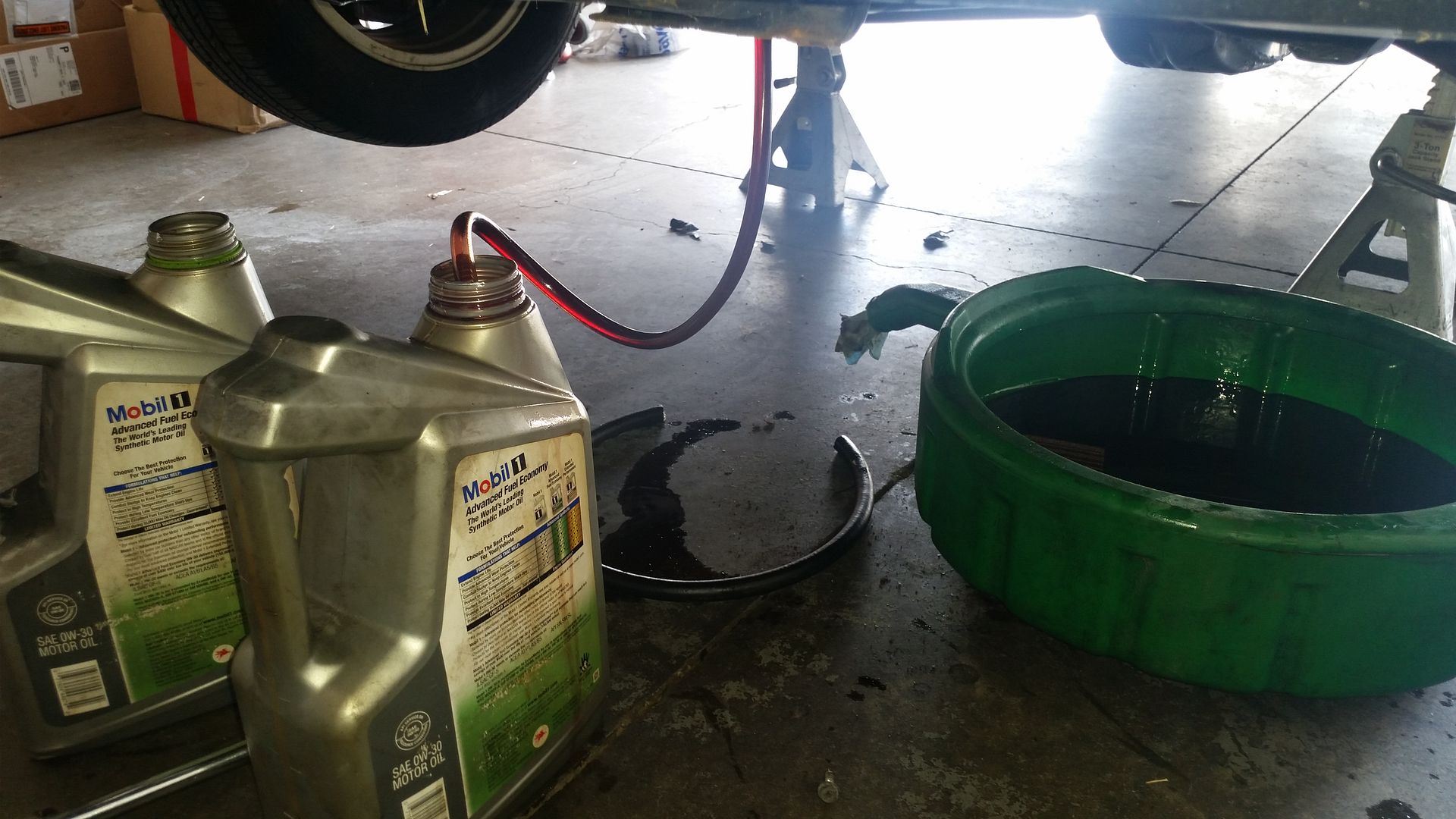

6. Pump out one quart of fluid. Attach your section of 3/8" or 7/16" hose to the radiator outlet (2GRFE V6 with U660E) or insert your 5/16" ID by 7/16" OD clear PVC/vinyl tubing into the return hose itself (2ARFE I4 with U760E). After ensuring the hose/tubing is well inside your suitable drain container start the engine and allow the transmission to pump out a bit less than 1 quart of fluid. When it is about there shut off the engine. You will notice that after you shut off the engine, a small amount of fluid will drain out. This is where a helper is valuable.
Note: The transmission pumps fluid at a relatively easy rate. You are not in danger of pumping out all of your fluid unless you are not paying attention.
Warning: Hot transmission fluid can cause burns or injury. Take proper precautions when dealing with hot fluids.2GRFE V6 with U660E:

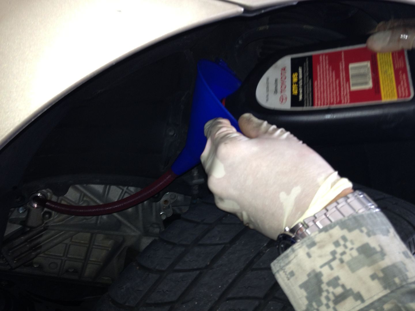

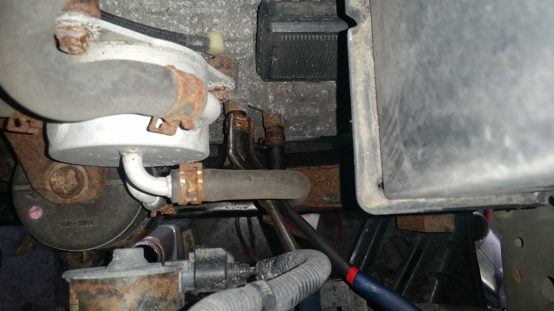

7. Fill the transmission with exactly 1 quart of fluid. Remove the transmission fill plug using your 15/16 inch/24mm socket, ratchet, and extensions. Insert your funnel or pump and add 1 quart of fluid into the transmission. Reinstall the fill plug finger tight only since it will be coming off several more times.
8. Repeat steps 6-7 around 9-10 more times. You will notice by quart 9, the fluid will look brand new. The 11th and 12th quart arr there to top off if you were a little off after the warm up.
9. Reinstall the transmission return hose onto the radiator/transmission. Remove the 3/8" or 7/16" ID hose section from the radiator outlet and slide the return hose onto the radiator outlet (2GRFE V6 with U660E) or remove the 5/16" ID by 7/16" OD PVC/Vinyl tubing from the return hose itself an slide the hose back onto the transmission (2ARFE I4 with U760E). Using your needle nose pliers reinstall the hose clamp in its original position.

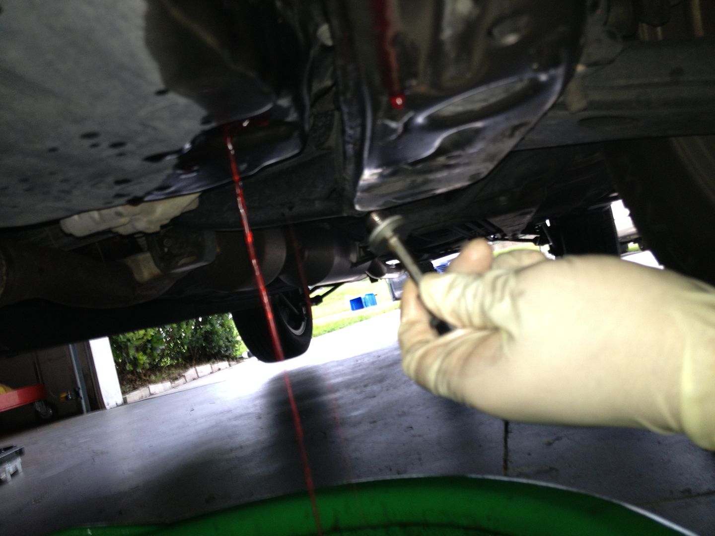

10. Check the fluid level. Level the car by jacking up the rear of the vehicle until it's level. Start the car in the air and warm the transmission fluid to the proper temp (104-113 degrees Farenheit/40-45 Degrees Celcius per Toyota). If using a thermometer I like to contact the fluid itself immediately at the overflow point. This way your fluid reading is more accurate to the fluid temp at the sensor. If using a Techstream observe the fluid temp in the data list or place the transmission in inspection mode (I will update this portion of the procedure when I use a Techstream). If using the paperclip, see below.
Note: Some fluid has to come out of the overflow for the thermometer check to work correctly. If no fluid comes out, you will need to add fluid through the fill hole and recheck both flow rate and temperature.

Cycle the car through the gears with the brake depressed a few times. Using your 6mm allen socket and ratchet remove the inspection plug from the transmission pan. Observe if fluid comes out or not. If no fluid comes out remove the fill plug and add fluid until you get a steady small stream/trickle of fluid draining ( I had to add around another 1/2 quart). Light dripping or heavy flow is a sign of an underfilled or overfilled transmission. When the desired flow rate is reached reinstall the fill and inspection plugs and tighten to 30 lb ft. or snug (tight but not too tight to damage the gasket).

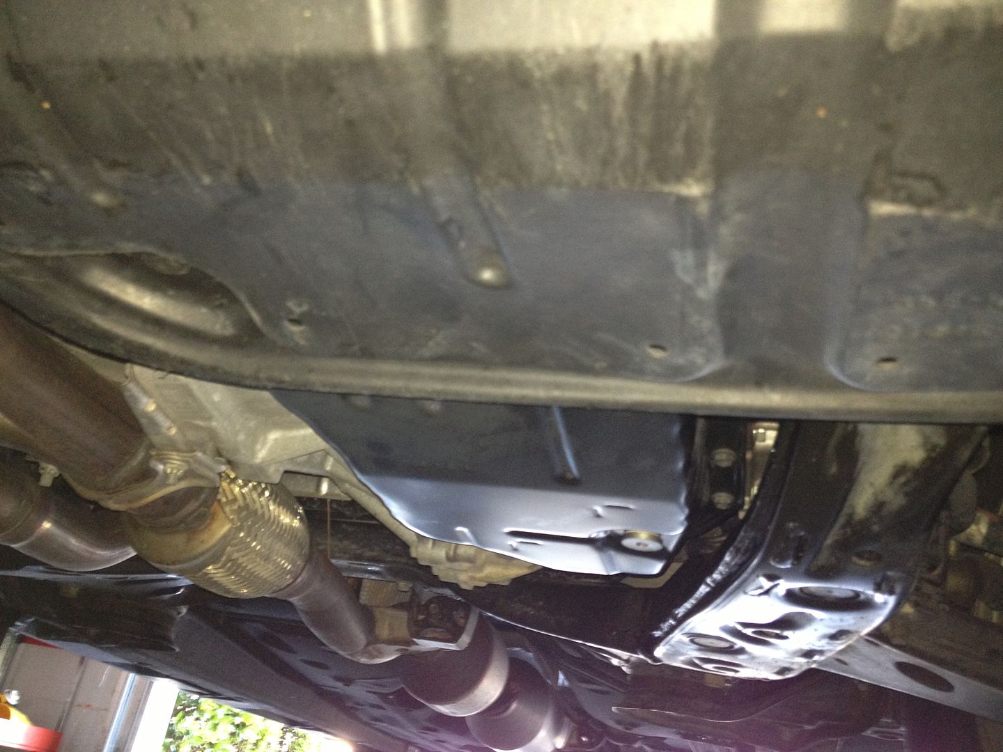

All 2007-2011 V6 Camry use the same exact U660E 6 speed "sealed" automatic transmission.

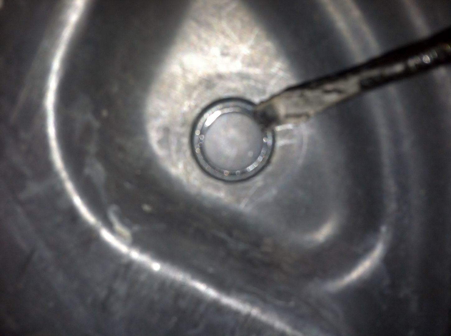

These newer Toyota sealed transmissions "DO NOT" have a "DRAIN" plug, rather they have an "INSPECTION" plug.
This isn't simply a new naming scheme because the plug on the bottom (3rd picture from the bottom in the DIY and probably what you look at) if removed will not drain the transaxle. Fluid will only drain from the transaxle when fluid is at the specified temperatures and the only way a rush will come out is during an overfilled situation. Short of that if you removed the inspection plug on your car right now I'm 99.999999% sure you wouldn't even get a drip of fluid out of the transmission. The way it works as stated above is you remove the plug during a certain temperature range (for the fluid) and watch the rate of flow out of this plug. If it drips a little it's underfilled and if it rushes out its overfilled. The target amount is a steady stream of fluid that is "just right".
As for the $125 dollar price I think an incompetent service writer is charging you for a drain and fill (for an older "non sealed" transmission). WS is pretty expensive and the labor rate is usually at least 2 hours. My advice would be have it done for that price but to watch them. If they do it you should see 9-12 quarts of new fluid, a large clear and orange reservoir with a hose for filling (this is the Toyota WS filling tool used to add fluid), and a flush machine.
With this transmission you have to flush it since it can't be drained and that would be the best flush price I have ever seen (heck I could only do it for about 40-50 bucks less and I got fluid employee price). They are right that WS is an average fluid and 60k should be the max in any transmission.

If you remove the overflow plug first with the 6mm hex, and using same 6mm, turn out the overflow tube up in where plug came out, it will drain about 2qt. My 2009 Matrix with a drain plug only gets out about 2qt 20oz.
Hope this clears things up.

5. CHECK FLUID TEMPERATURE
NOTICE:
The fluid temperature should be less than 40°C
(104°F) before beginning the fluid temperature
check.
(1) Connect terminals CG (4) and TC (13) of the
DLC3 (OBD2 connector under steering wheel) using a small Paper Clip to jump PIN 4 and 13 together
(2) Move the shift lever back and forth between N
and D at 1.5 seconds interval for 6 seconds.
(3) The D shift indicator on the combination meter
comes on for 2 seconds when the fluid
temperature is within the appropriate
temperature range.
(4) The D shift indicator will come on again when
the fluid temperature reaches 40°C (104°F)
and will blink when it exceeds 45°C (113°F).
(5) After confirming that the D shift indicator turns
off, move the shift lever to the P position and
remove the SST from terminals CG and TC.3
6. CHECK TRANSAXLE FLUID LEVEL
NOTICE:
The fluid temperature must be between 40°C (104°F)
and 45°C (113°F) to accurately check the fluid level.

My 2010 Camry I4 6speed does have a drain plug/overflow plug.
You can drain about 2 quart out of it. You remove the overflow flug first with the 6mm hex, and using same 6mm, turn out the overflow tube up in where plug came out.

Short of adding the paperclip method (which I didn't initially find as they want you to use Techstream to place the transmission into Inspection mode) you described the identical procedure.
I will add the paperclip method to the DIY for those that don't want to use a temp gun.
I wil reiterate that the plug is not a drain plug as the transmission will not drain completely. As an example if you turned on my 2009 Camry with a dipstick and opened to drain plug I would lose all the fluid eventually. If you did the same thing on a U660E/U760E transmission you would not. It will only drain a small amount of fluid out and can be opened while the vehicle is running.

In looking at pictures online, it appears that the the radiator still has lines for transmission fluid after the heat exchanger. The other end of the heat exchanger appears to reflect that.
22 Posts
The small heat exchanger two line is connected to Transmission and other two line connected to coolant line that goes to Throttle. Its not a traditional cooling system like transmission cooling is part of the radiator assembly. I have seen some manual explain that design helps transmission warm up quickly rather than cooling. I think that's true since they are before thermostat where radiator get hot coolant after thermostat opens.
So Basically this small heat exchanger is not working as cooler. At some point the temp of the engine coolant and Atf would come to equilibrium if the heat exchange is that good via this small device. Which is another point that atf will get bad quickly due to the higher heat by design.
So the previous question remain - is it possible to add fluid via the exchanger? Anyone tried?
Super Moderator
2005 Corolla CE
14,832 Posts
Discussion Starter #20
Interesting. I can't say for sure that would work.
