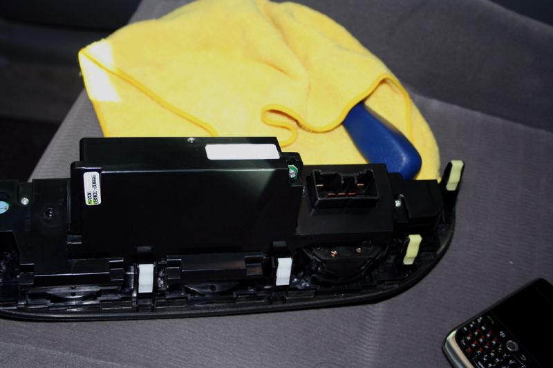

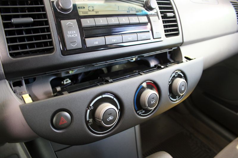

Alright, I finally put together a DIY on how to change the climate control bulbs, along with the (apparently) elusive part number. Hope this is helpful :)

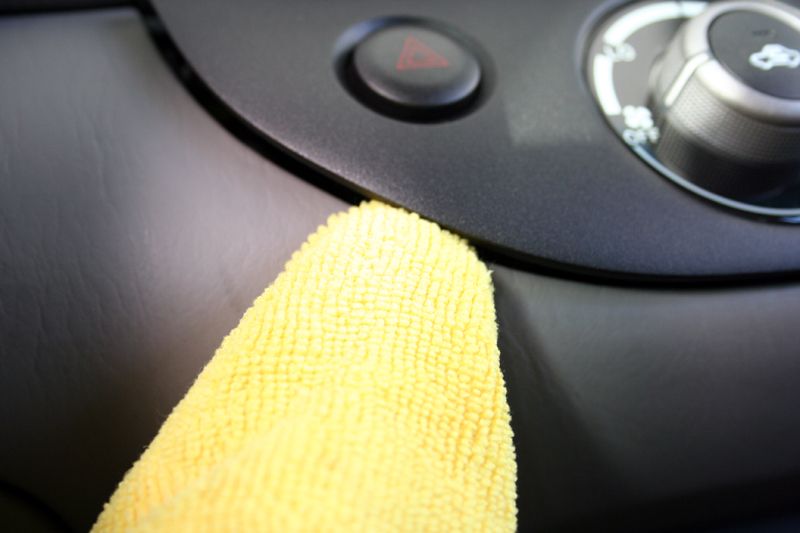

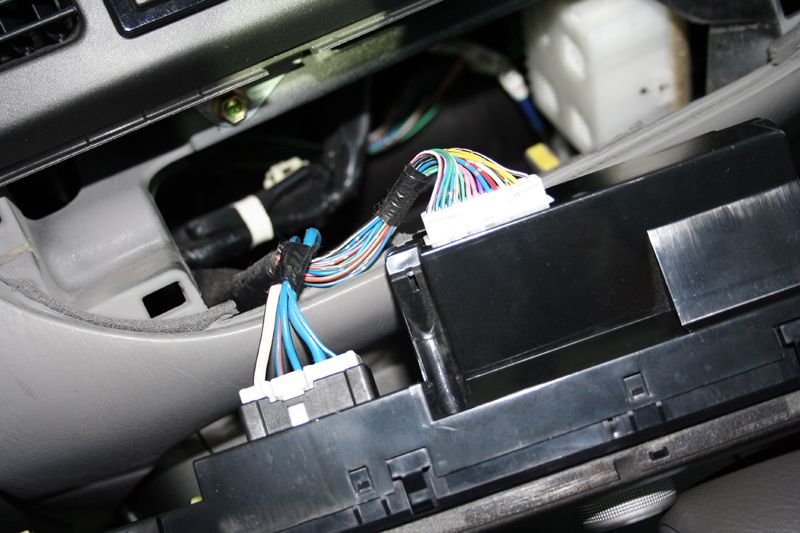

Basically you just need to pry the climate control panel out, I covered a screw driver with a microfiber towel so I wouldn't scratch anything. There are six clips which come out fairly easily. Once you get the panel out there are two plugs - just unplug them, they're both big and unique so you won't get them mixed up.

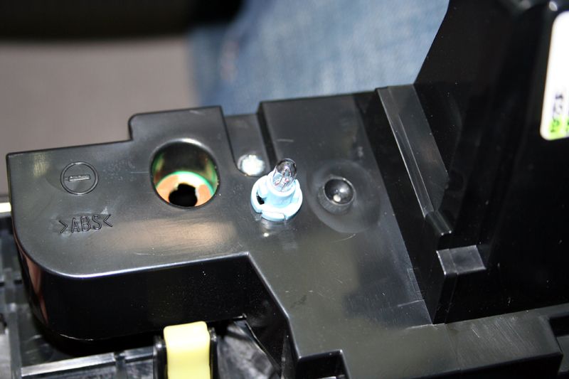

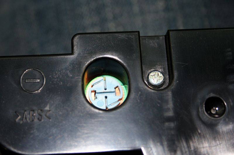

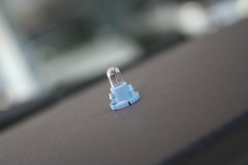

You don't have to unscrew the backing of the panel, the bulbs have blue bases and just twist out. Remove the burnt out ones and replace it with the new bulbs. Then all you have to do is attach the two plugs and snap everything back into place.

Part number: 90011-11050 @ $4.61 each

Yeah I didn't see a previous DIY and nobody volunteered info in the other thread I/we were posting in regarding the climate control panel/bulbs. I also couldn't find the bulbs aftermarket and decided to just get regular incandescent bulbs from the dealer. LEDs crossed my mind but I wasn't sure about the viewing angle from such a small LED.

AWESOME. I did it the other day. Bilbs were $3.30 at the dealer...took a ady for them to get them. It took less than 10 minutes to follow your procedure...I did not even have to disconnect the climate control panel once it was removed. Thanks again.

thank you so much. i have had this problem for a long time, and thought it was a short in a wiring or something.. fixed today in 5 minutes. thanks man!

I dont have a Gen 5, so what size is the bulbs for those who want to get LEDs. There are 3mm, 4mm and 5mm. Looking at the picture and size of the bulb, it looks like 5mm.

Comparing it visually to the images on superbright, I would say the 5mm LED in NEO5 lamp.
