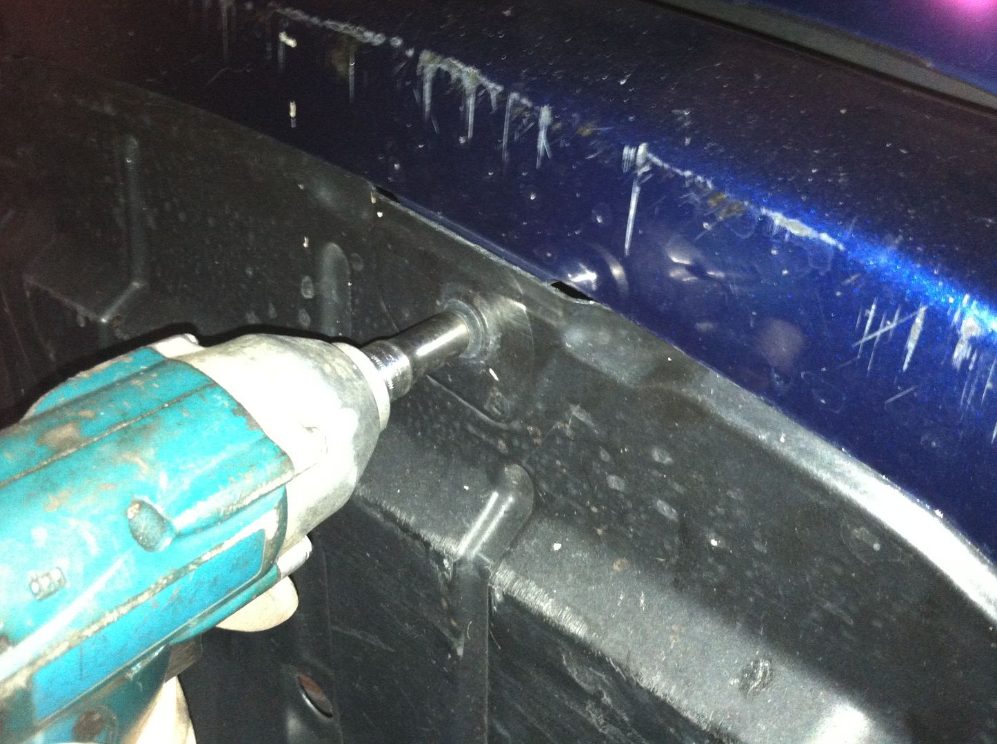

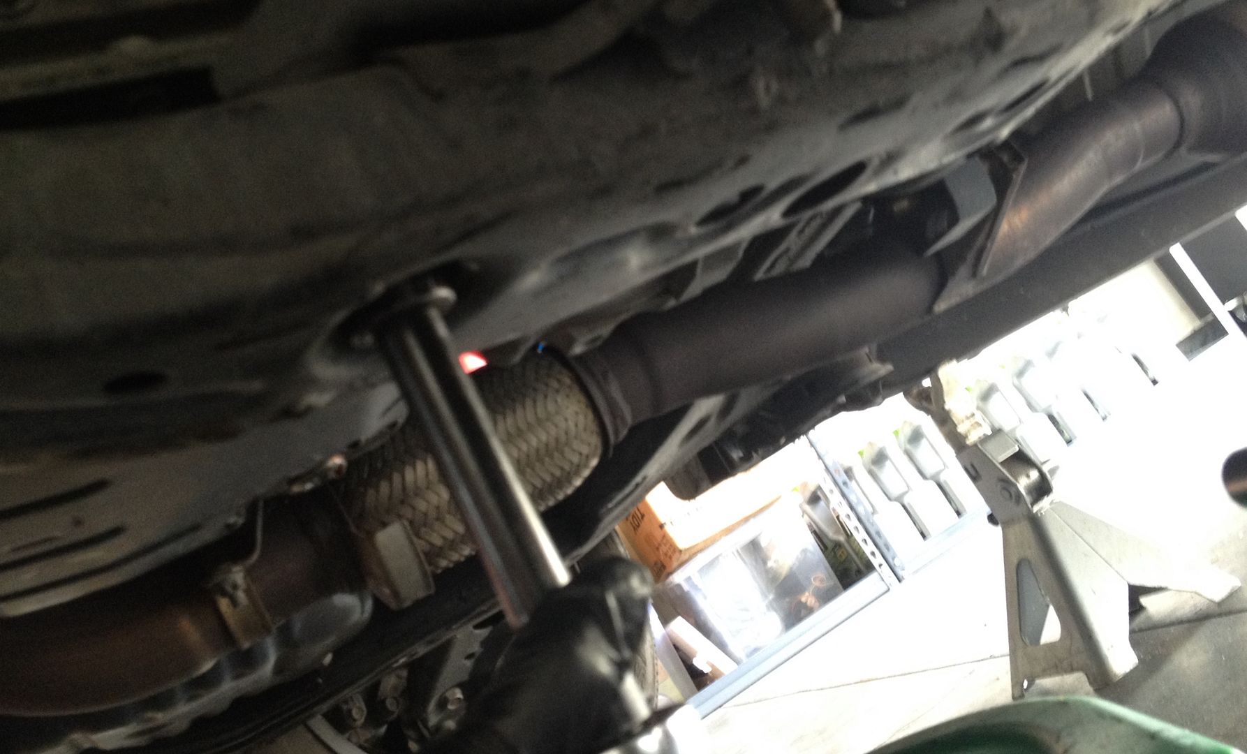

3. Remove the driver side lower splash shield. Depending on who has worked on your car previously or any kind of curbs you may have hit some of these may be missing. Here is when it would be a good idea to have extra clips handy (I broke 2). Using your flat head screwdriver remove the 3 push clips holding the splash shield by prying out the center section and removing the clip. Remove the 5 10mm screws securing the splash shield and small mud guard piece to the car and remove the splash shield and mud guard.

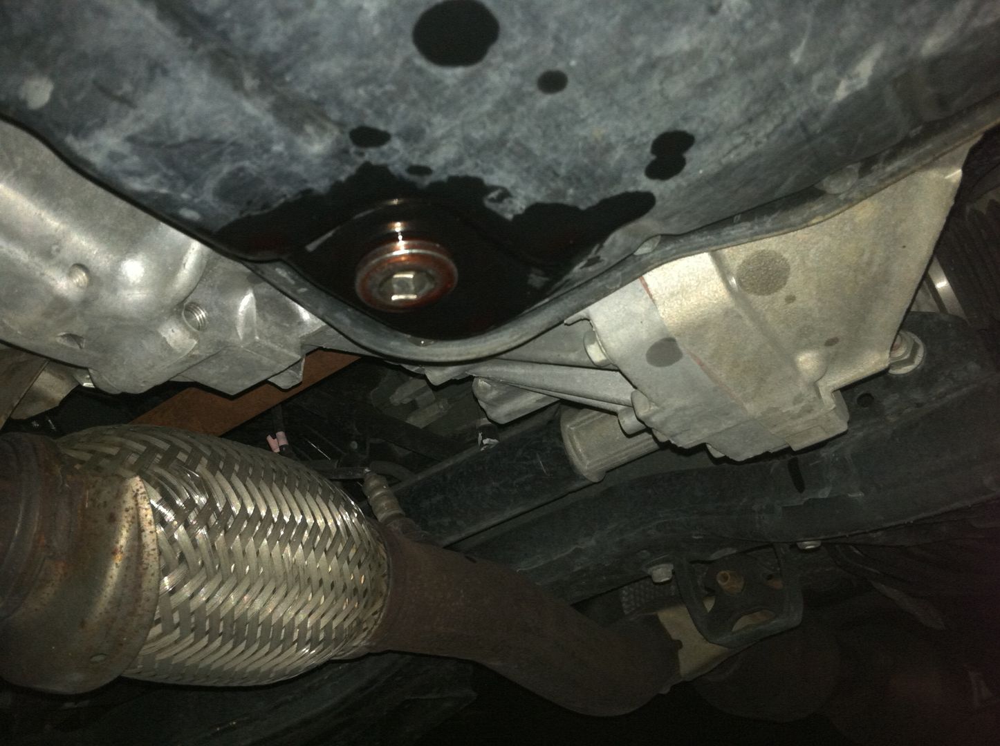

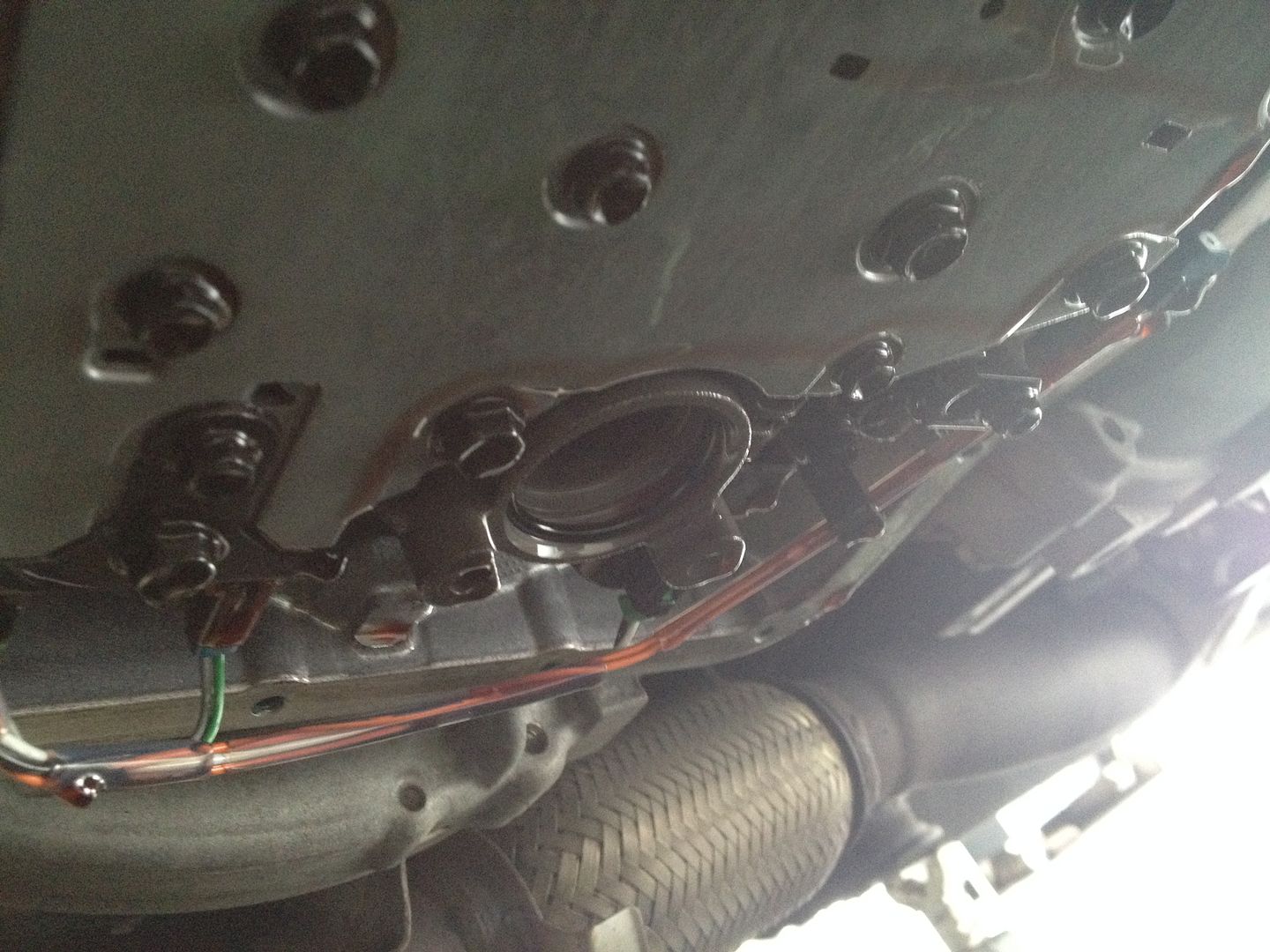

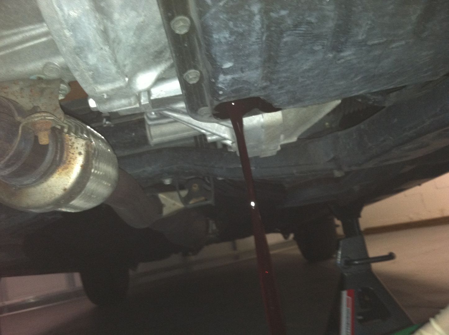

4. Drain the transmission pan. Set your drain pan in place and using your 10mm hex head socket and ratchet loosen and remove the transmission drain plug. If this is your first time doing this you can reuse the drain plug gasket, if not it is adviseable to replace the gasket. When draining is complete be sure to reinstall the drain plug with gasket. You will not need to touch this again for the remainder of this job. This plug needs to be tight but be sure not strip it. Snug it down well.
Warning: Transmission fluid may be hot and can cause burns or injury.

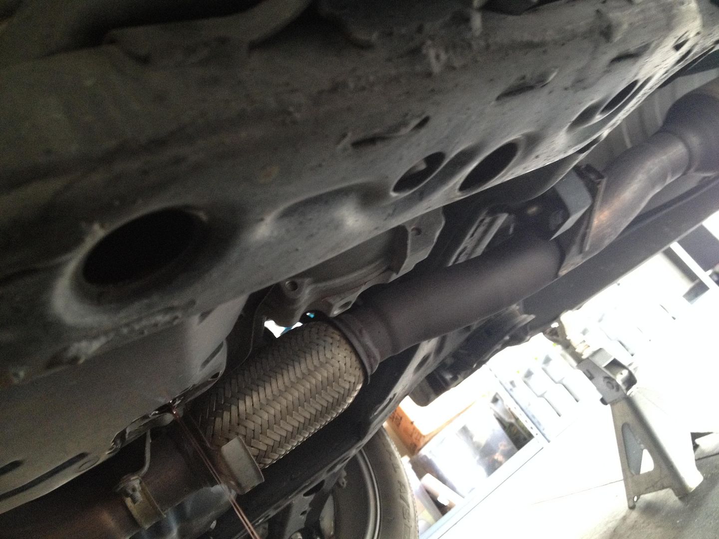

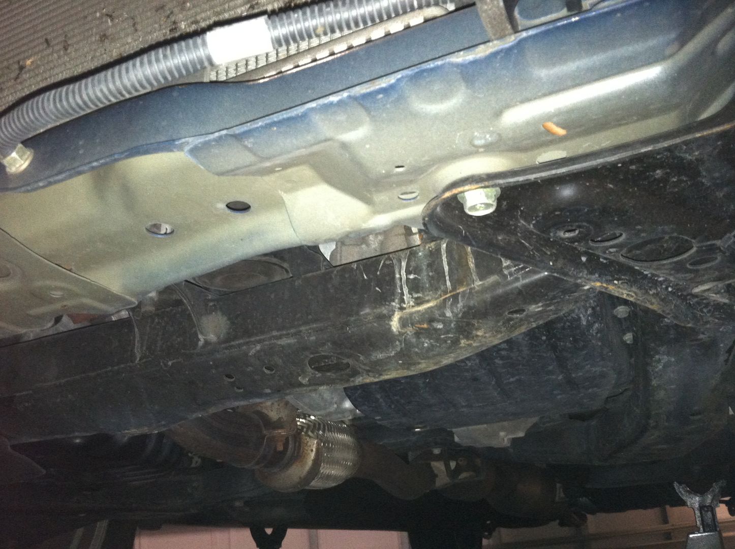

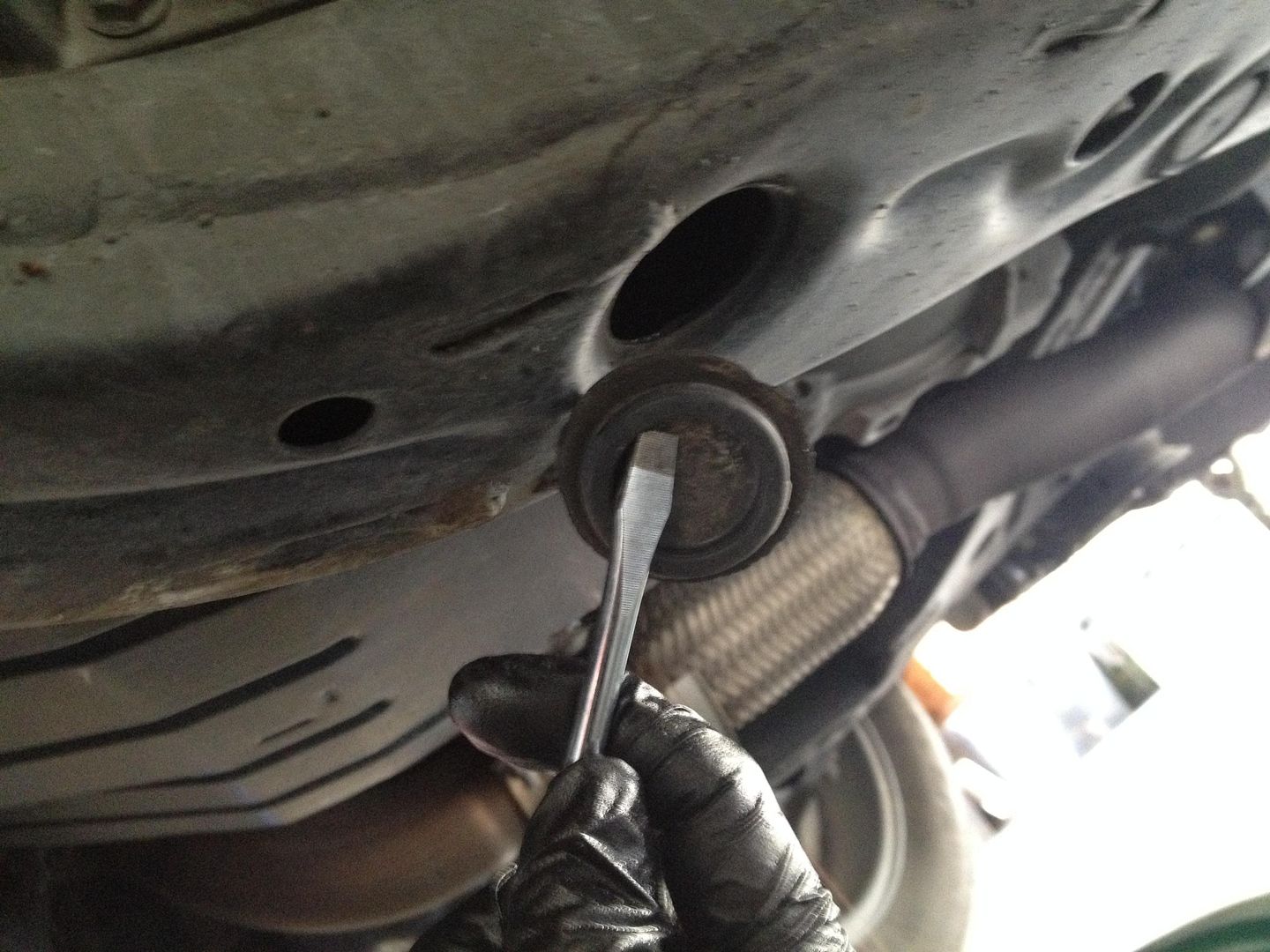

5. Remove the driver side inner splash shield. Turn the steering wheel all the way to the left. Remove the inner splash shield by removing the 2 10mm bolts using your 10mm socket and ratchet or impact and 1 plastic clip by depressing the center of the clip down until it unlocks and then using your fingers or screwdriver to remove the clip. Remove the inner splash shield from the vehicle. It may also be wise to remove the wheel here for even more room.

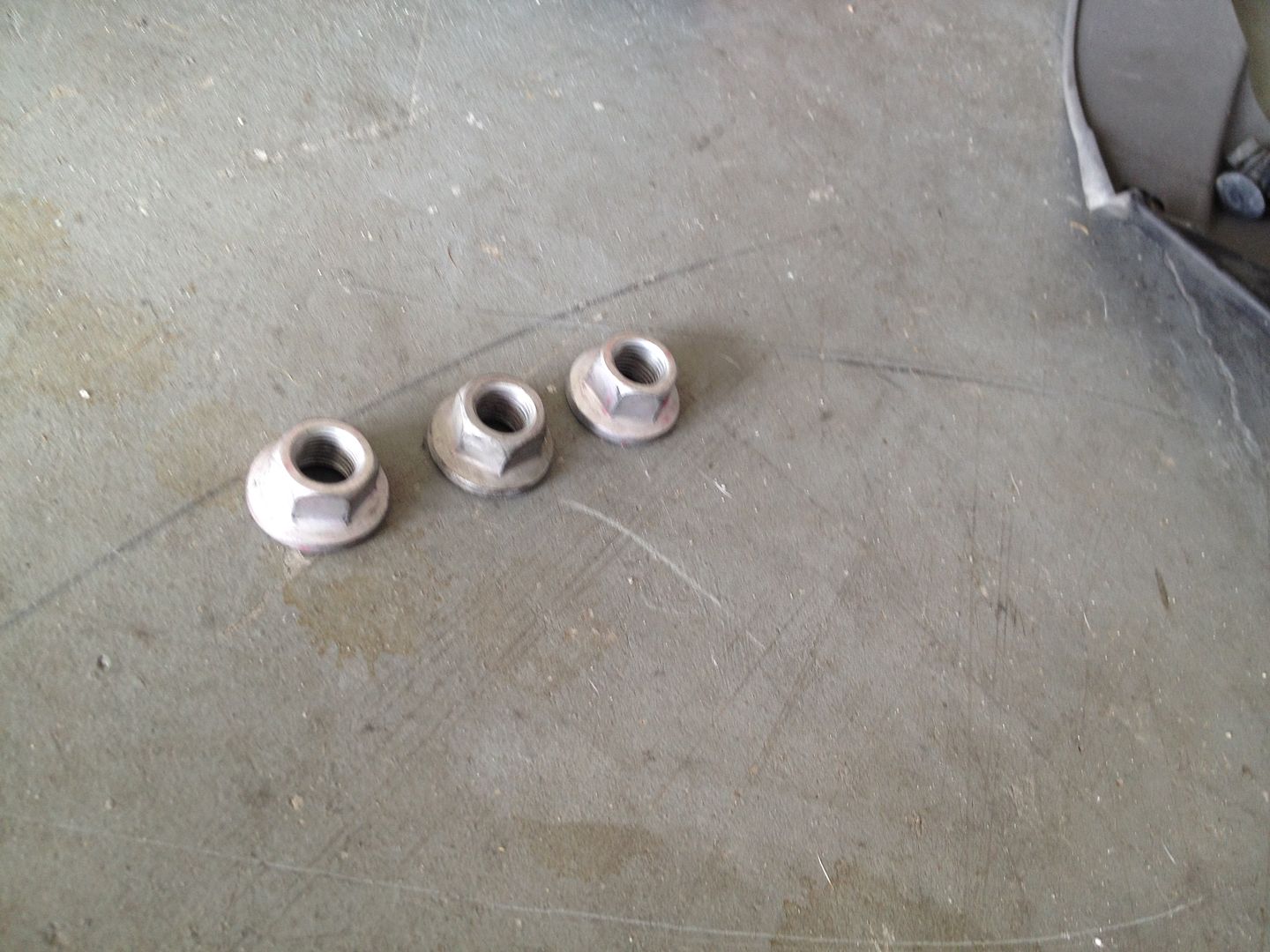

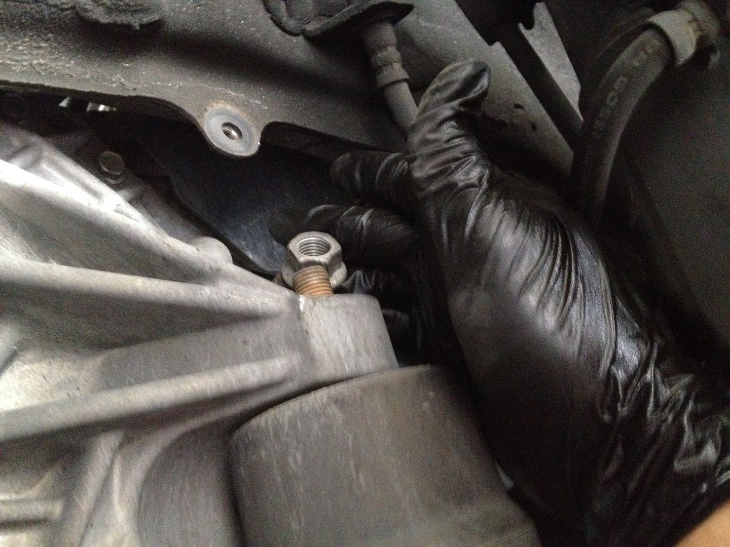

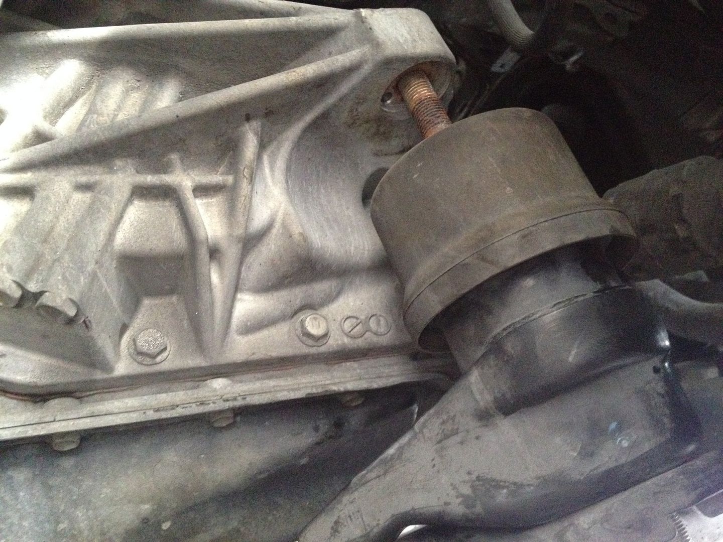

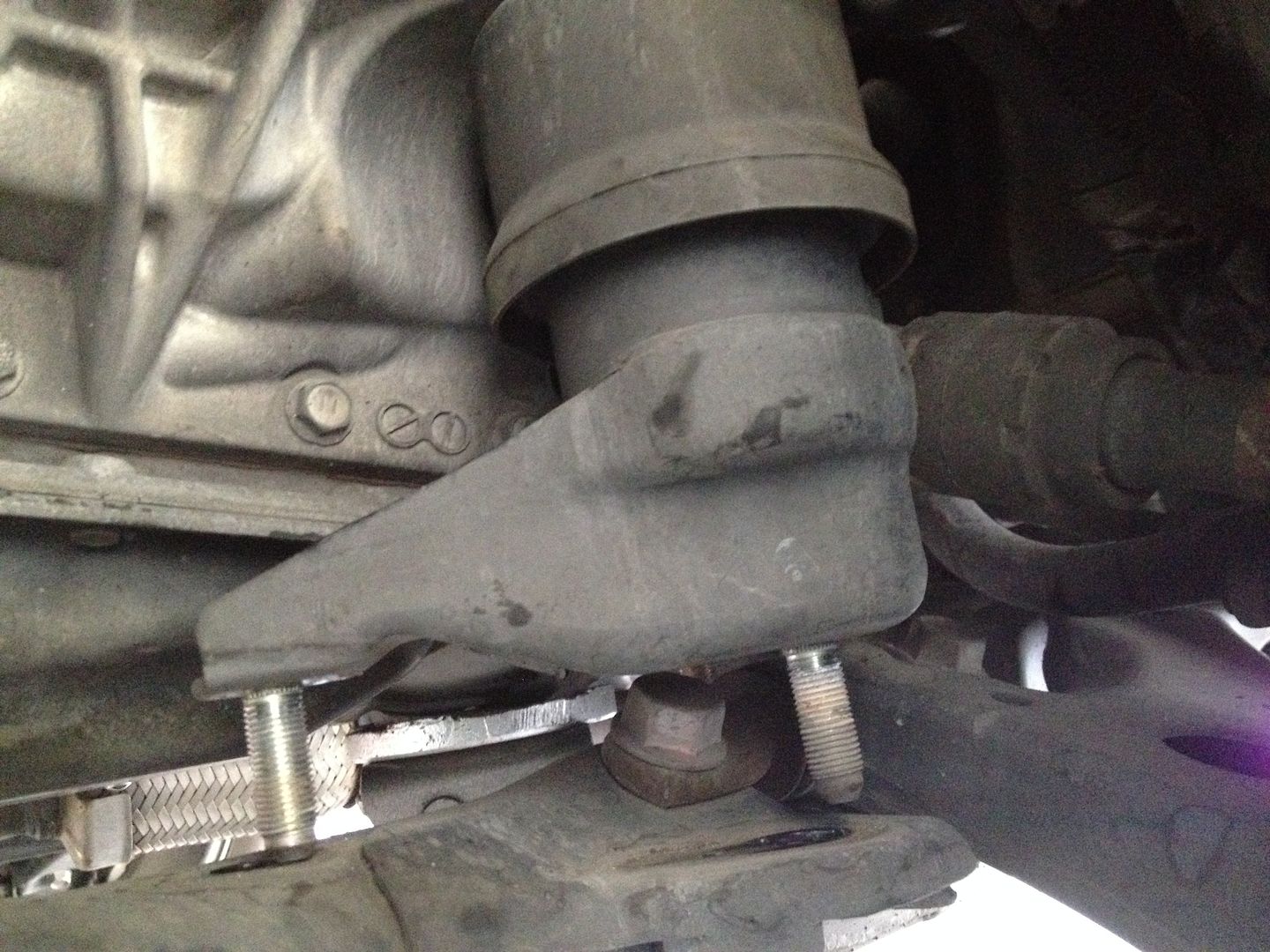

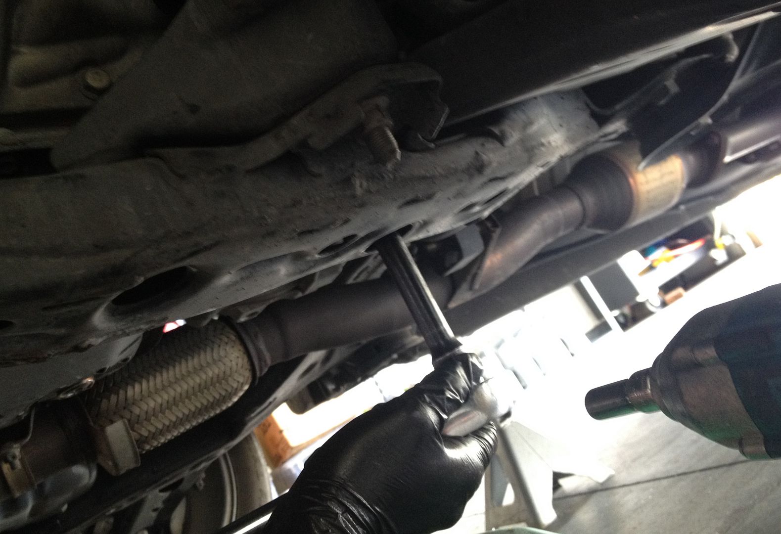

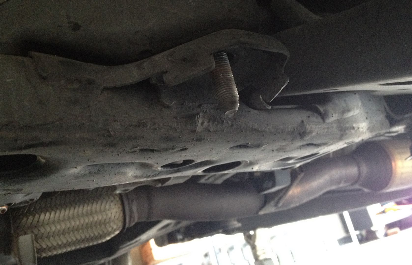

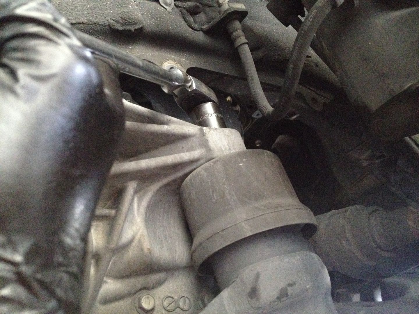

6. Remove the nuts securing the drivers side transmission mount. Using your screwdriver pop out the hole covers for the lower mount studs. Then using your ratchet, 17mm socket, and extension remove the 3 17mm nuts from the transmission mount. 2 are under the stud covers and one is exposed under the mount. Finally using your ratchet and 19mm socket, remove the upper nut securing the transmission mount to the transmission.

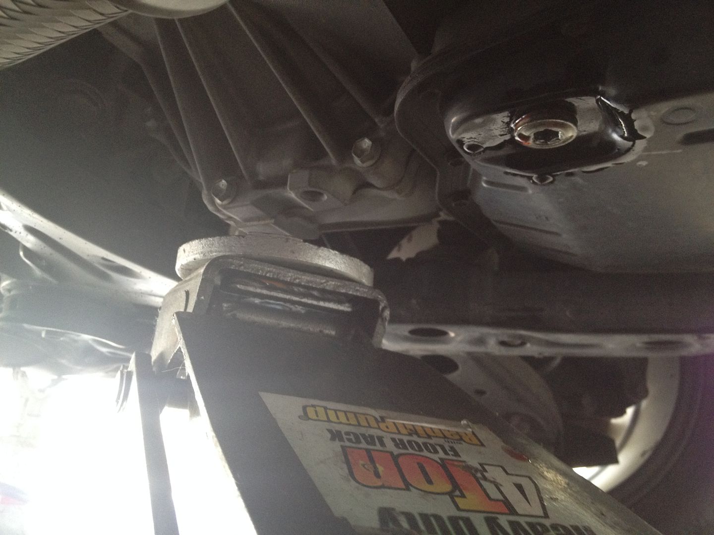

7. Raise transmission. Place your jack under the differential case of the transmission and lift the transmission as high as it will go before lifing the body off the jack stands. If the mount goes up with the jack lower the mount down to its rest position with your hands.

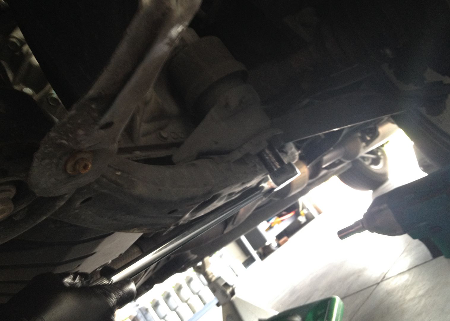

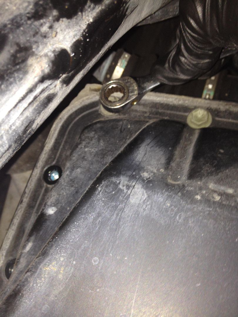

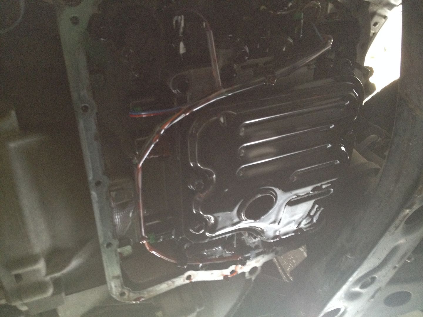

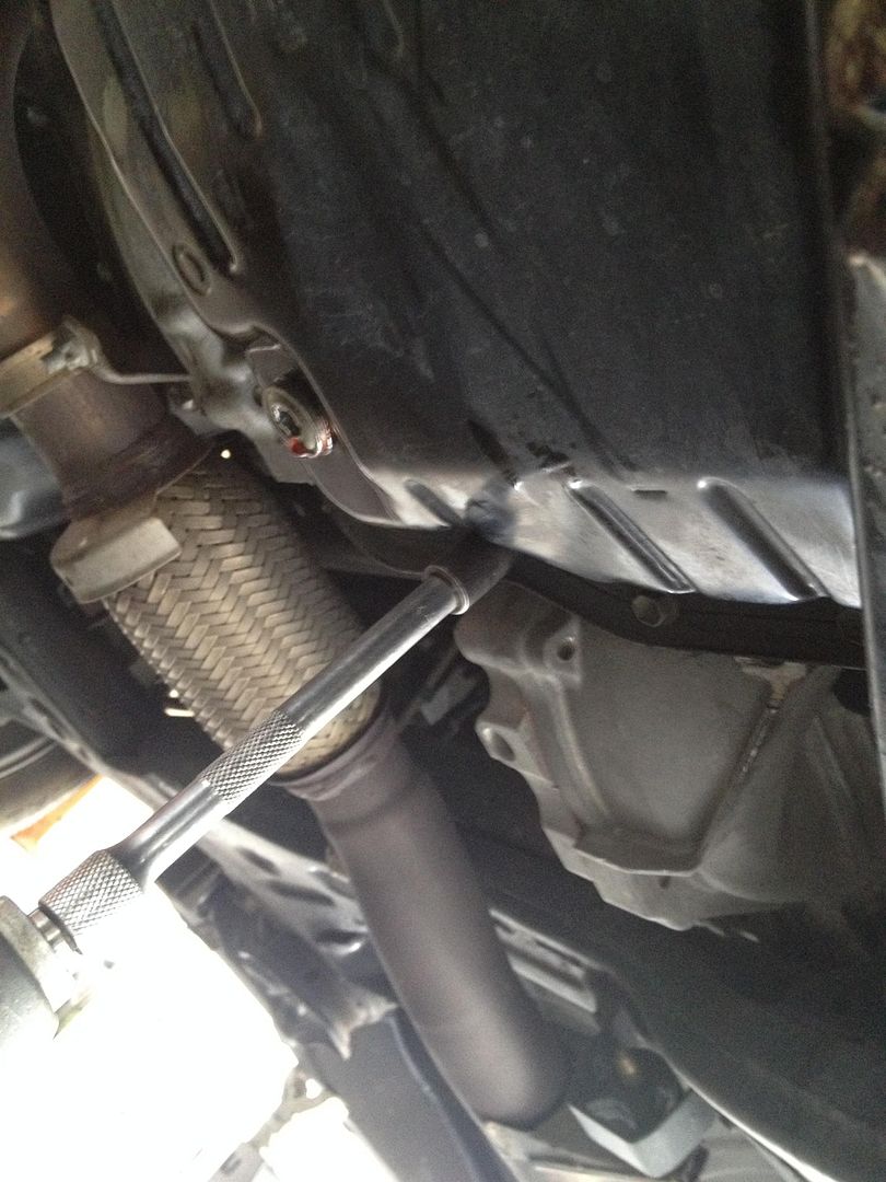

8. Remove the transmission pan. Using your ratchet, 10mm socket, and extensions remove all the bolts securing the pan that you can reach (should be 18 bolts total). Then using your 10mm wrench remove the remaining hard to reach bolts from the over the front subframe and transmission mount. While supporting the pan with one hand, using your screwdriver GENTLY pry the transmission pan away from the transmission and remove it from the vehicle.
Caution: Prying without all the bolts removed or in the wrong area can gouge the gasket surface or bend the pan.

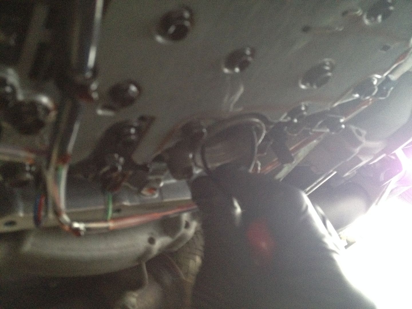

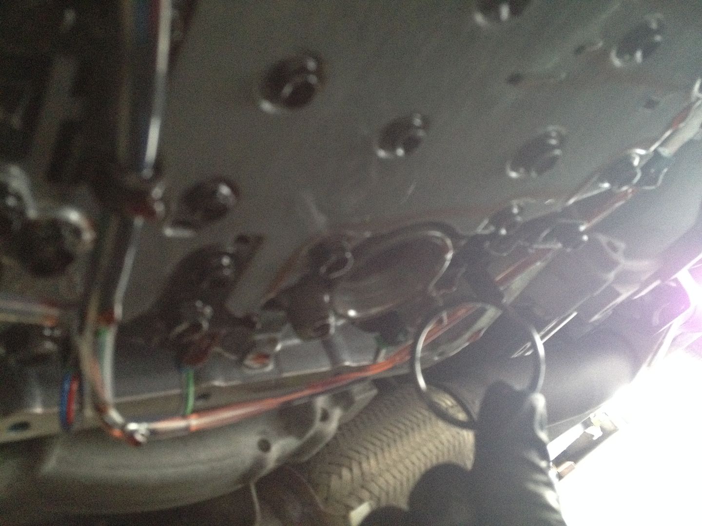

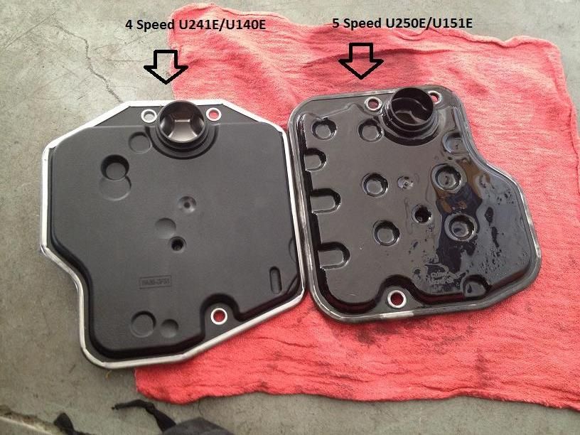

9. Remove the transmission filter. Using your ratchet and 10mm socket remove the 3 bolts securing the transmission filter to the valve body. Pry the filter away from the valve body with your hands. Remove the old o-ring if still attached to the valve body gently using your screwdriver.
Below you can see the difference between the 4 speed and 5 speed filters. Everything else in the kit is the same between both.
This is the inside of the old OEM Filtran filter. Honestly it wasn't too bad inside.

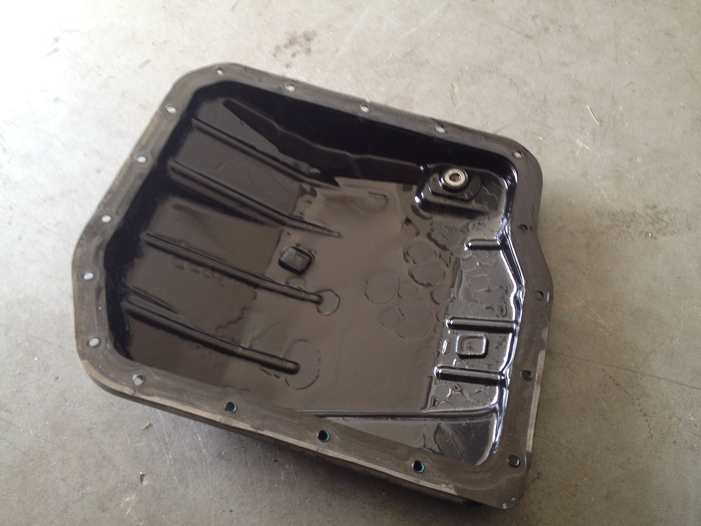

10. Clean the transmission pan and magnets. Remove the old gasket from the transmission pan. Remove the magnets from the pan and using your rags or towels wipe away all the build-up from the magnets. Then using your brake parts cleaner and rags or towels wipe away and residue or buildup from the transmission pan. Reinstall the magnets into the designated areas on the transmission pan.

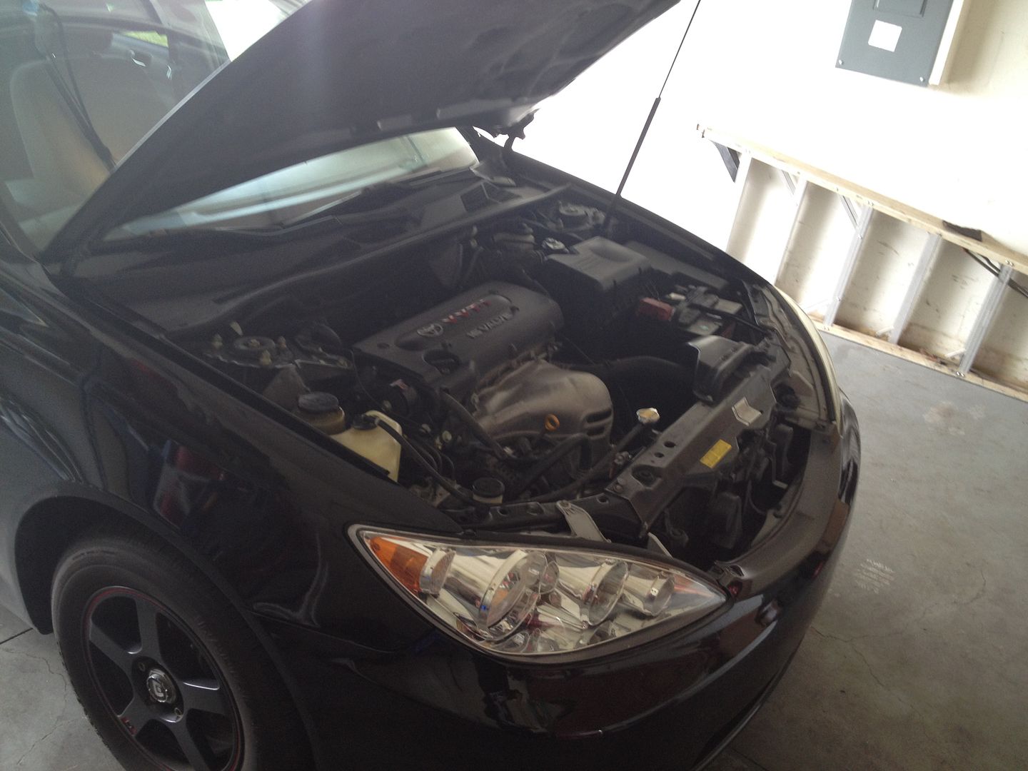

Warning: The transmission dipstick is located very close the positive battery terminal. Be sure the battery terminal is completely covered with it's cover or a rag and ensure the dipstick does not contact the battery post to prevent arcing.

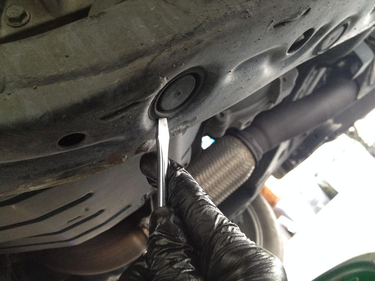

21. Reinstall the driver side lower splash shield. First using your brake parts cleaner liberally spray and clean the transmission fluid from under the car. Set the splash shield into position (remember that at the front of the splash shield/bumper area the splash shield extensions go under the bumper. Install your 3 clips and 5 screws. Remove the drain pan from under the car.

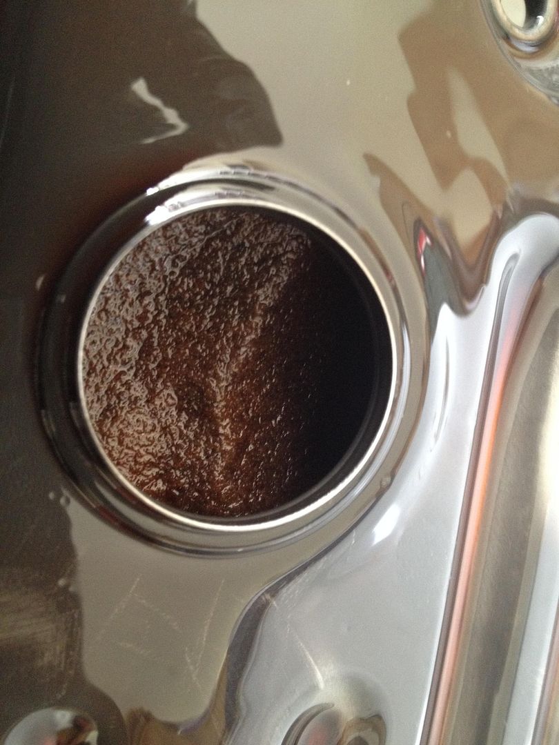

Changed the filter on my car today. Here are some pics of my 130K mile OEM felt filter.
It was in great shape and appears it could have gone much much longer. Barely any debris at all in it however I do good regular fluid maintenance.

The transmission mount hides 3-4 bolts. I used to have a wrench that allowed me to remove them without touching the mount.
Basically you have to move the mount.
15 Posts
Thanks. What kind of a wrench would allow me to get to those 3 to 4 bolts without loosening the transmission mount? The whole point of the jack is to lift up the whole transmission such that I can reach those hard to reach bolts of the pan right?
My understanding is that the hard-to-reach bolts of the pan are right above/near the transmission mount, is that correct? An offset-wrench or some joint for the ratchet might do the trick?
I used to have a 4 in 1 ratcheting box end gear wrench that had a lip extension for all the sizes. This allowed the wrench to grab on the bolt that otherwise would have stripped. The wrench broke. Keep in mind, even with that tool it is a PITA.
Remove the 4 mount nuts and jacking it up is a million times easier.You jack up the transmission to separate it from the mount. Jacking up the transmission with the mount attached will only lift the entire car up.
