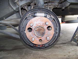

Once you have your corolla secure with jack stands then you can remove the brake drum off . Some brake drums might need a little bit of tapping to get off .

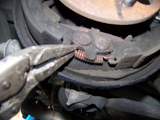

The best way to remove your brake shoes is to start from the top removing the spring where the brake adjuster is through it then you can work your way either one side or the other side down till the brake shoes are completly off.

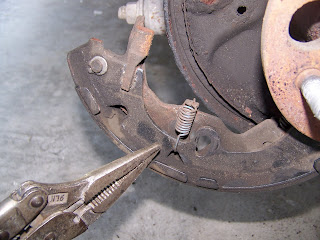

Then you can remove the emergency brake bracket from the brake shoe . Take the spring off first then spread the clip apart . Some brake shows come with this replacement and others don't so try not to destroy it .

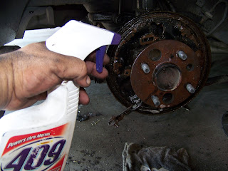

While I had everything off I decided to get a tiny wire brush and cleaned the braking plate , Then with some degreaser I spray the area and with my air hose I blew out the all the junk and made it easier to dry out too .
