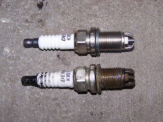

My OEM plugs are the double sided spark plug . Denso #3194 . Some places you have to order them as in my case . Some people have their own preference . This is mine and what my corolla calls for .
Then I gap them at .44 each side .
Then I applied some anti seize because the corolla heads are aluminum and the spark plug is metal . If you don't apply this they will be a pain to get out . Once I applied the anti seize then I put the plugs back . Hand screw first so that you don't strip the threads .

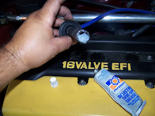

The with the dielectric grease you put some inside the spark plug wires so that it will make it easier to pull the wires on and off with out breaking them .

Also, watch out and keep the anti-seize stuff off the last couple of threads on the plugs. Pretty easy to over do it and increase the potential for hotspots and predetonation from that extra anti-seize sticking into the combustion chamber. Also have to adjust your torque rating as well, assuming the base lubricant of the anti-seize is some sort of grease. Pretty easy to overtorque the plug, increasing the chance of stripping the threads off the head.

NGK said:
NGK sparkplugs feature what is known as Trivalent plating. This silver or chrome colored finish on the threads is designed to provide corrosion resistance against moisture and chemicals. This coating also acts as a release agent during spark plug removal. NGK spark plugs are installed at the factory dry, without the use of anti-seize. NGK tech support has received a number of tech calls from installers whom have over-tightened spark plugs because of the use of anti-seize. Anti-seize compound can act as a lubricant altering torque values up to 20 percent, increasing the risk of spark plug thread breakage
(read: K-factor)

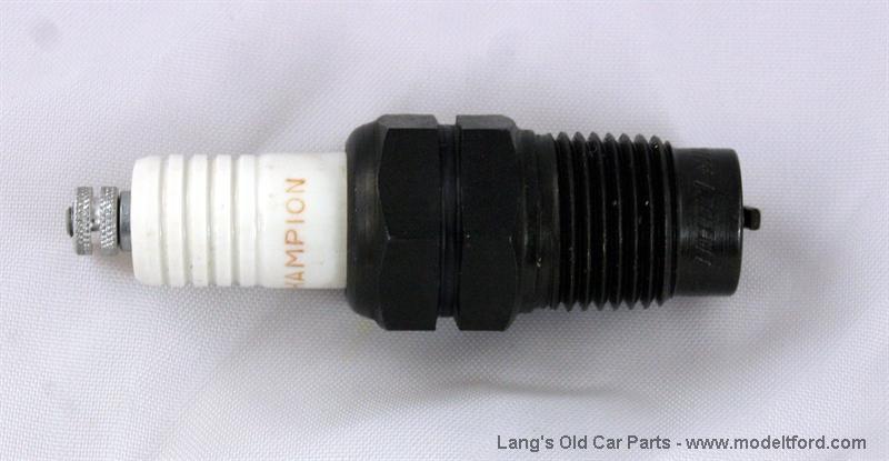

AFAIK, all modern spark plugs are, and have been, like this. This is why the threads are shiny. Whereas spark plug threads back in the day, are a dark grey color, and require anti-sieze. I have only used new spark plugs, and have never had a problem getting them out, whether it be short-life copper NGK's after 5k mi, or Bosch plugs after 40k mi. So I'm not sure why OP recommends the use of anti-sieze on the plug threads. I wouldn't do it.
Here is an example of a plug you would use anti-sieze on. This is for a Ford Model T.
