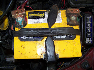

This is how my battery looked with corrosion and acid all over the tops and post .

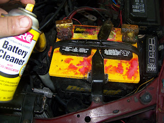

First I sprayed the battery cleaner and die spray . The red shows all the acid . Once you spray this you let it sit and eat up the acid . If you need to apply more then apply more . Always remember to use gloves cause the acid will eat your skin and sting a little . Wear eye protective glass . Never blow the acid , Always use a rag your not gonna reuse again then throw away .

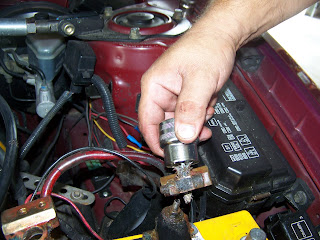

Once you have wiped off all the cleaner and as much as acid you can , Then with your battery cleaner tool that has a wire brush inside you clean your top post . If you do not have this tool you can use sand paper or a wire brush .
Then you open the top of the battery cleaner tool and wire brush the inside of your battery terminals and then the outside of the terminals removing all the acid . Again if you don't have this tool you can use sand paper or a wire brush .
