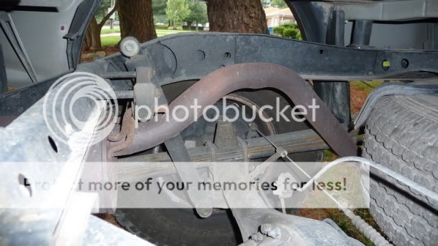

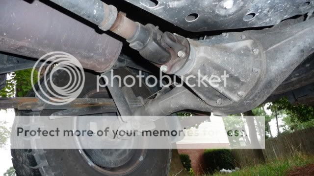

I was in the process of buying some new bilsteins for my 2001 prerunner, but I noticed my leaf springs are kind of flat, what do you guys think ?
Shall I replace my springs first or the shocks ?

Yeah, those springs look like they're on their last legs. Maybe get the springs first and get shocks afterwards?
Yes, 1st gen Taco springs have a bad reputation of flattening out. You can go the cheap way of adding an AAL to regain some of your lift back, re-arching the springs or getting a pair of new leaf packs.
