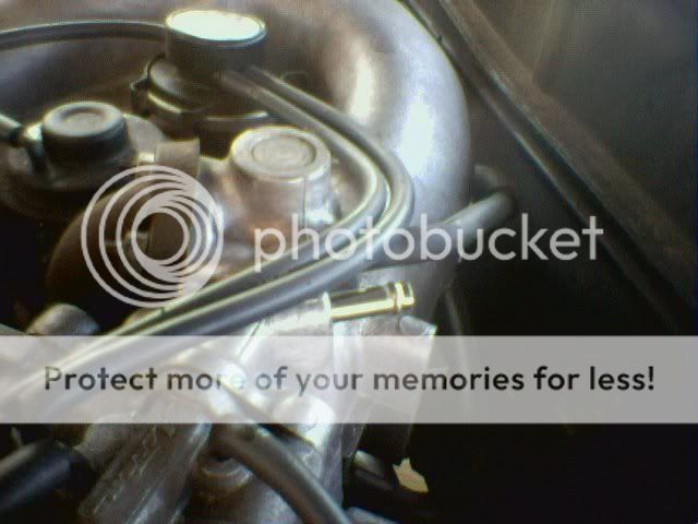

well i was dumping some seafoam in my my engine today and i rember seeing what looked like a little pipe being covered on the tb. so i took the cover off and there was a brass fitting for a hose. now was something sposta attach to this like in another country or something? well there a picutre it's the brass fitting with nothing on it.
oh and i was able to dump the seafoam throught that little hole. and there was a LIGHT vaccume

Looks like something should be there... what engine is it?
it was all a dream
4,204 Posts
Its the 1MZ motor.
And Pineapple is right. Its where the rear PCV valve hose goes into. The 1MZ has two. One from the front valve cover going into the intake piping, and the rear valve cover which goes into that port.

odd? all i found was one line connecting to the tb
thats from the back bank and then the front back connects to the air pipe. i guess older modles had a pvc for both banks? there was a plug on that i took the picture with it off so you know what it is.
