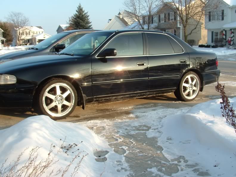

UPDATE!!
I finally took some pictures of my Camry. Sorry for such a long delay. Busy making money for more mods :clap:
So here are few pictures. It looks hotter in life then on pics.:naughty:

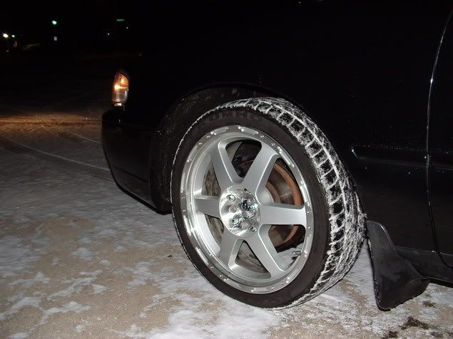

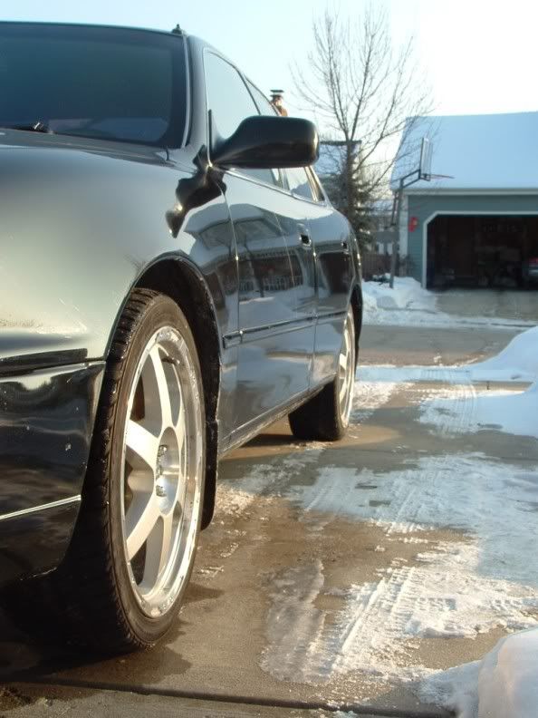

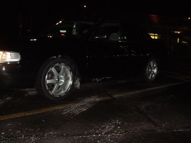

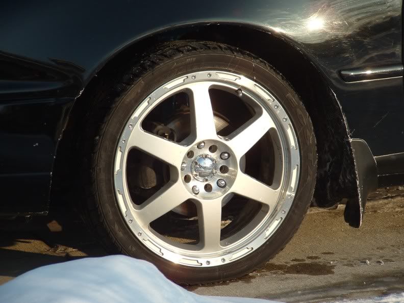

Struts: Tokico Blue
Springs: Intrax
Rims: 17x7 ADR Revo-6
Tires: Kuhmo Ecsta 711 205/40 R17

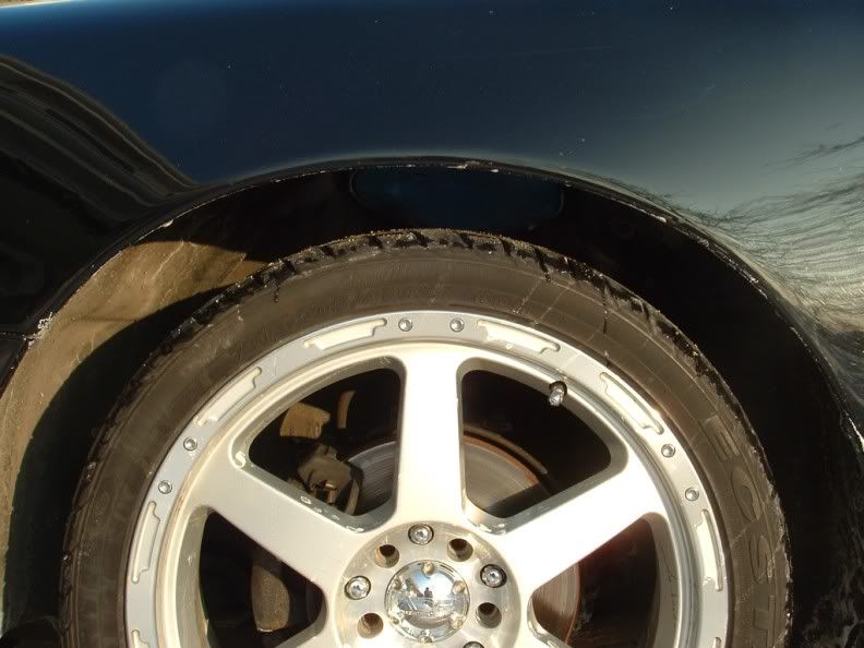

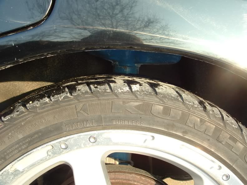

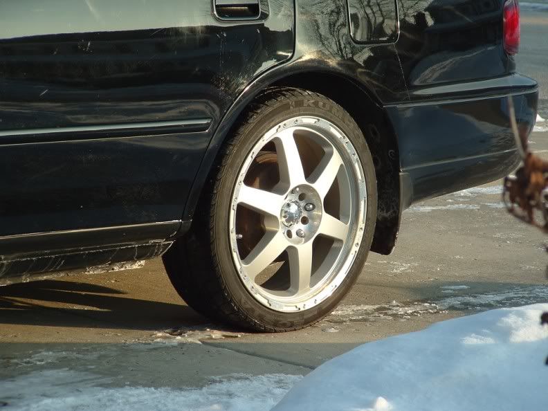

Front^
Rear^
Front again^
Rear Again^

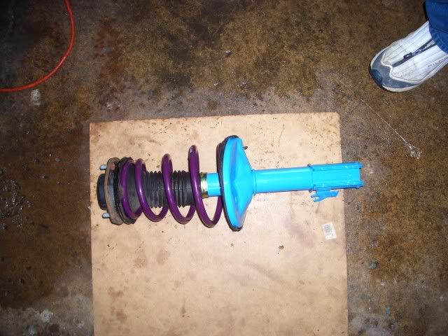

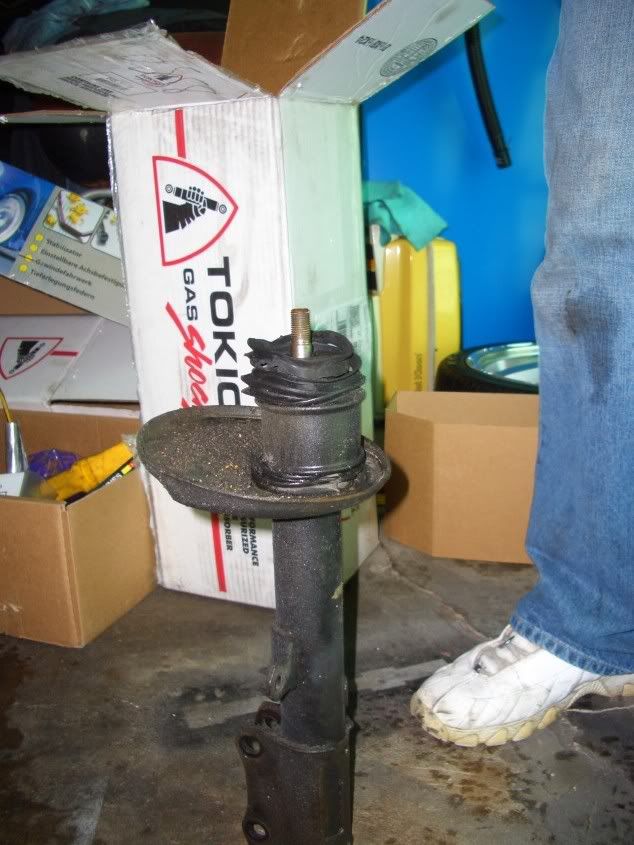

Few pictures of the Install:

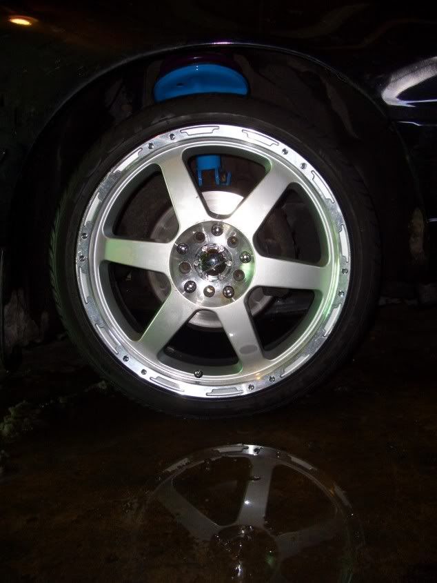

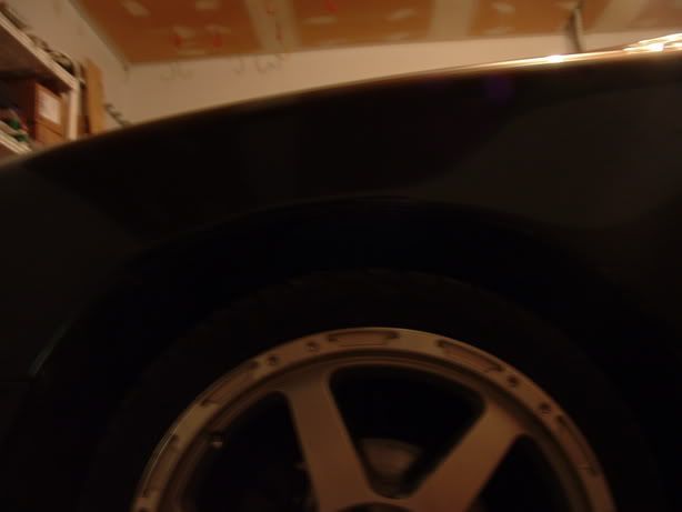

Cool Reflection picture:
Um... my stock high performance struts? Note: all of the struts were busted except one, that showed SOME sign of life.

looks awesome. get that cam polished out though. Those swirl marks are hideous.
Car looks nice dropped. I love black camrys, that sux about u'r rim. I remember when one of my rims on ym old camry was leaking. The prvious owner had put some silicone in the hole or something, I had to get it fixed since getting another rim like that was not possible. It was a discontinued MOMO rims. After going to different places, they all said they couldn't fix it. Then I went to a marine welding shop and they fixed that bitch like brand new.

looking pretty good....a drop is always a good thing :thumbup: but you're always going to have the huge fender gap though due to your tire size
but two things:
why are you running those tires in the winter?
and
why are you tires so undersized in the first place?
did you buy those used? those tires would fit better on a civic.....and it is universal bolt....
even 215/45/17 is slightly undersized, and it still shows a bit of a gap - the only proper way of not having thick tires if you don't like the look is by getting bigger rims
for the camry, you should have either 215/45/17, 215/50/17 (optimum, but less common tire size), or 225/45/17
