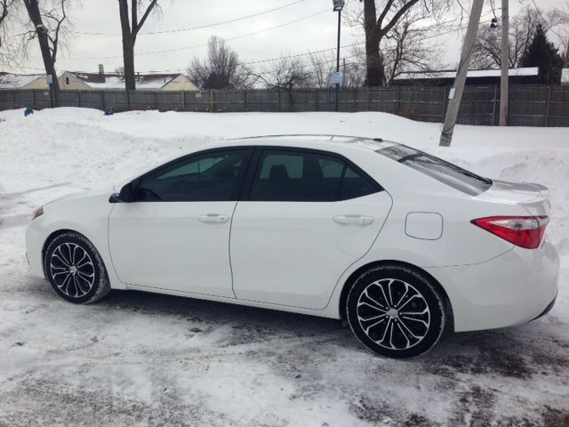

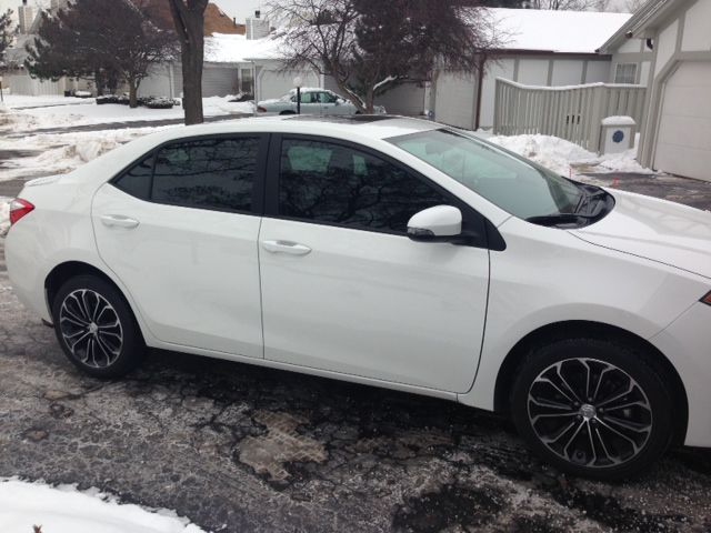

Hey everyone i just lowered my 14 corolla s with Eibach lowering springs from 10th gen 1.4 front and 2.0 Rear. Just got them installed 1hr ago, they fit with no problem only the front was a little tricky but over all no problems, the car looks much better it will still lower it self a little more within the next two weeks after it settles, but i am very happy with these springs rides very good much better handling, no bouncing and the car is not slammed as it would be with Teins.
Before:
After:

Thats a really good stance. Lowered but still looks factory. Dont know if Eibach makes both but did you get the Pro Kit or the Sportlines?

This is the Pro kit I did not want to lower it to much I just wanted to get rid of the huge gap, friend of my installed Teins 2.0 Front and 2.0 rear on his LE Eco and he is thinking about switching Chicago sucks for slammed cars.
