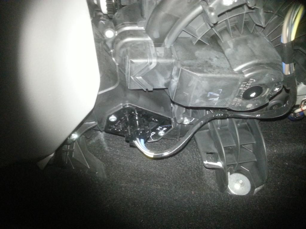

If you are only getting high speed, then your blower motor resistor is blown. High speed gets direct battery voltage, all ther speeds as are feed through the resistor. The resistor is located behind the glovbox. If you look at the heater box you should see a connector that plugs directly into the blower motor resistor.
This is what it looks like on a Corolla. Not sure if it's the same on a Matrix.
Heater fixed
Sorry I'm late posting. I replaced the blower motor resistor, $ 30 and 15 minutes, local shop wanted $125. It was in the same location as shown in the Corolla pic. Thanks to everyone for your help. I have to keep Mom warm, she will be 86 years young in March!:grin:
