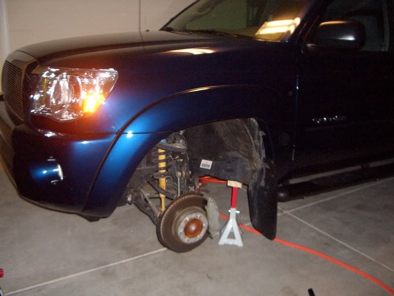

Here is the first stage.... I'm going ahead and prepping the truck before Pointer and ******* get here at 7am to help me finish up this beast.
Here is the first picture of many to come of my truck being jacked up!! I'll update periodically. I have my laptop in the garage if anyone has any helpful hints along the way, just PM me. POINTER, remember the Jack Stands and the Reciprocating Saw..... and also, the beer is in the fridge.

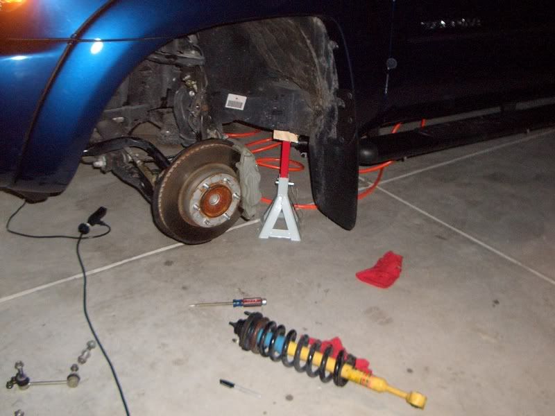

Shock/Strut is out Left side
going to do the right side now.... an impact wrench helps a TON!!! took one hour as a first timer getting the thing out.....so far, so good.

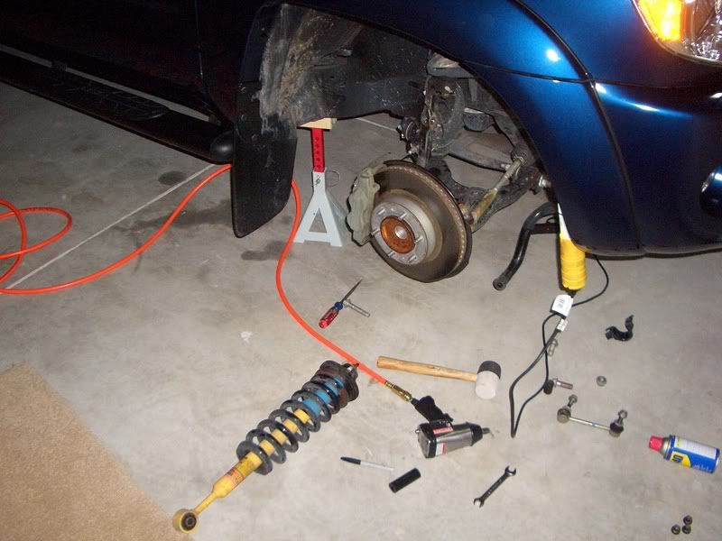

other side strut is OUT!!!
this one was a lot quicker.... 13 minutes!
it will go a lot quicker tomorrow when u know what ur doing

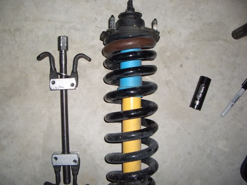

can i remove the top shock plate and 17mm nut before I compress the spring? I think I should have rented the strut compressor instead of the spring compressor.....
Air tools rule. :thumbup: I use mine whenever possible. Plus they're pretty cheap compared to electric power tools. Most of mine are Ingersol Rand. Be sure to add a little air tool oil in the fitting after each hour of use.

Edit: I think you should get the spring compressed before you remove the center nut. Good luck - with 4 extra hands you should be in great shape.
