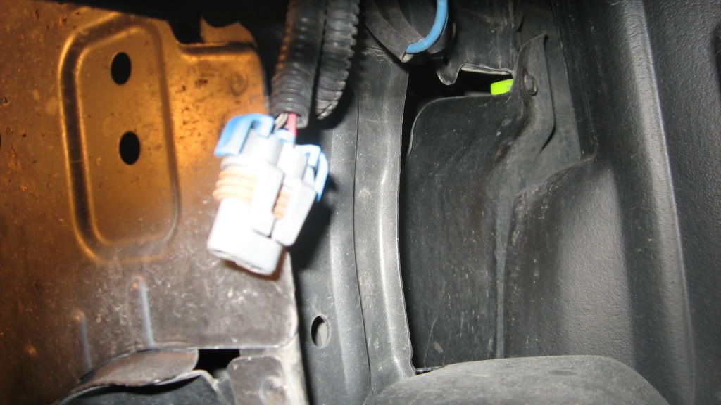

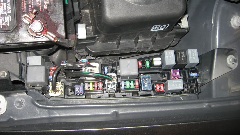

I have an 08 CE, I want to add fog lights to my car. I have read a few threads on the subject. I have found 2 plugs under the car in the area where the fog lamps would go, and there is currently a 15 amp fuse in the fog lamp outlet in the engine bay fuse box. Is it safe to say that my car is pre wired for the foglamps?

It looks like it besides not having a light stalk with the switch and relay, just like on my le. I was under the impression that the ce did not come prewired from the factory for fogs but I guess that is wrong.

I was surprised to see the wiring there myself. For what its worth, my car is a Corolla CE 20th Anniversary Edition. Its fully loaded including a sunroof. Perhaps this special edition got the LE harness since it has most of the options the LE has?

I would remove the steering wheel bottom cover (2 screws) to check and look for the pre-wire connection for fogs supposed in the light stark in LEs. If it is not there, I would run separate wire for foglights from the fusebox to the dash.
Just my 2 cents
