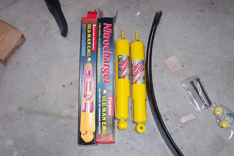

Finally installed my suspension upgrades on Friday, and extended my diff breather. I went with the full OME upgrade package, except for the replacement leaf pack (for now).
OME 885 coils
OME N140S struts
Alcan AAL
OME Nitrocharger (N182) rear shocks
3* shims

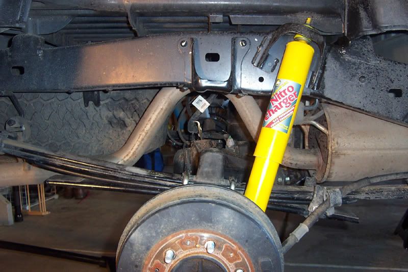

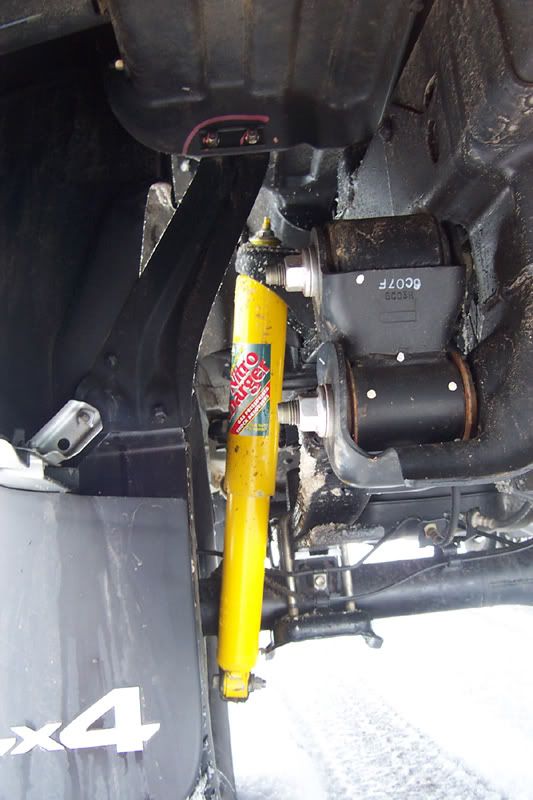

The rear install was more of a bitch that I expected, but nothing a crowbar and hammer couldn't solve :hammer: Those brake lines aren't long enough.....
Given all the mixed reviews about the ride, I wasn't expecting too much. But so far, I'm ecstatic. I don't think it's too stiff at all, and it seems to hug the road/bumps more with this setup than the TRD. The roads around town are just littered with potholes becuase of all the snow we've had, and I was trying to hit every one of them. No problems at all with the AAL; maybe it's the addition of the Nitrochargers that is helping. This is a GREAT SETUP!

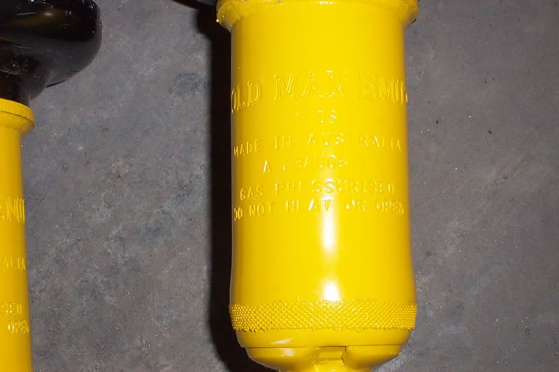

Comparison of Nitrochargers to TRD Bilsteins (bigger and longer, like me)

I keep bouncing back and forth between 285's and 265's / 75/16. My preference would be for the 285's, which is why I did install the 1/2" top plate spacer (I actually installed the passenger side coilover without the top plate, then pulled it back out and reinstalled it with the spacer - you can see the spacer in the 3rd pic). I figure it'll be pretty easy to pull out the spacer if I ever decide I don't like it/need it. I've read all the goods and bads about the 285's countless times, which is contributing to my schizophrenia. I've got about a month to figure it out. I definitely like the more aggressive look of the 285's, especially with the AT tire. 265 MT's look great, but MT's aren't practical for my needs.

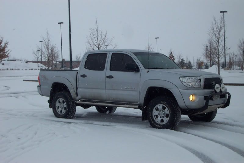

So the front is a full 3" with the 1/2" top plate. I expect some settling with the spring based on what I've read - maybe a 1/4 to 1/2" over time.
Rear is 2.5" taller.
