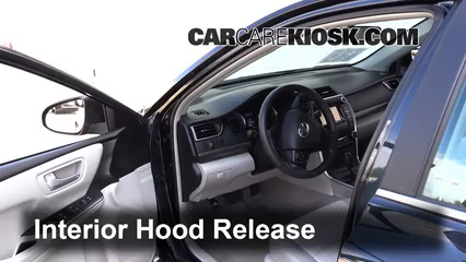

Finally located the second fuse box. It's on the driver's side, not too far from the latch that opens the hood. Now gotta figure how to take out the cover without breaking it. :)
Found this great link:
This one is also helpful for it shows you how to open the fuse boxes:
