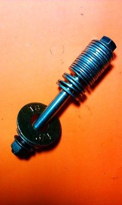

Piece of cake really........I didn't even remove rear carrier assy......Used a 1/2"x 6"
bolt to start, then just kept adding washers to ease it in......My own home-made press !
Had to use a large washer on the ends......then used a rubber malette to tap in that last 1/8"........Didn't even remove tire....

I think it goes on the rear adjustable trailing arm. The bushing that usually requires you to buy a whole new arm...
1,022 Posts
I believe, in this picture, it goes on the "strut rod".
The reason that the No. 1 and No. 2 lower suspension arms have non-replaceable bushings, is because they aren't a bushing, but a captured ball joint (that's probably not the correct term, though).

Well.....Toyota calls that a "Rear Axle Carrier Sub Assy".......others carmakers call it a 'trailing arm' or 'carrier ends', and I believe others. Whatever. It's the big giant 2"+/- wide bushing that the strut rod attaches to.
Also, Witstock, the wobble I had on back end diminished almost completely.....I'll need the strut rod and the suspension arms (and maybe links) before I'm completely done.
