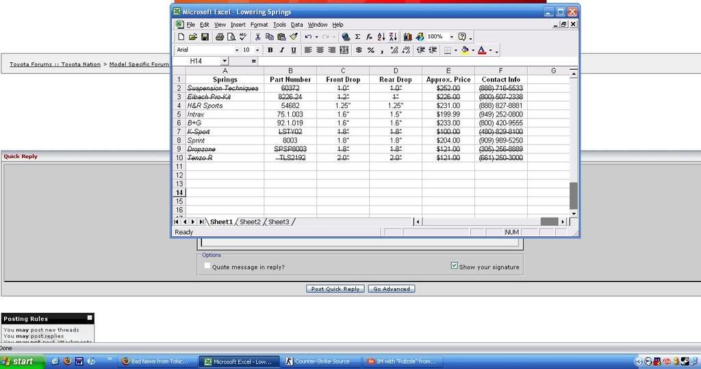

my notes:
- For struts, i would go with the Tokicos unless your car is still a family car ... they provide extra stiffness, and are great for complementing lowering springs -- the KYB GR2's are probably your best bet if you want to retain a stock feel but wish to lower your car
- For light springs, i would go with Eibachs or H&R Sports if you want a minimal drop but a better-handling ride
- For for medium springs, I would go with Intrax or Sprint if you want a moderate drop, but there is always the risk that after they settle, the wheel well gaps will become uneven (however, the car will be level in most cases, instead of raked)
- For intense springs, I would go with the Tenzo-R springs if you want THE MOST drop you can possibly get, however keep in mind that they are discontinued so you will have to buy them off someone else
- most (if not all) of these springs are Progressive Rate springs, which means that the harder you push them, the harder they will push back ... which isnt optimal for the track, but its great for a Daily Driver .... this also means that you cannot cut them to achieve more of a drop, because you will be cutting the outer rings, which provide less force and you wont end up any lower
- IN ADDITION, lower springs do not always provide the stiffest ride .... I tried contacting most of those companies to ask for their spring rates (or spring rate functions, since they are progressive), and nobody would give me an ounce of information ... so if you want the stiffest springs, then its going to be a hit-or-miss game .... but keep in mind that most of the ride "stiffness" is provided by the struts (so if you ask another user if their Eibachs were stiff, you may get a different answer depending on whether they have KYB GR-2s, Tokico HPs, or anything else)
here is a link to a screenshot i took when trying to figure out what springs to get ... it gives you the Part # and Telephone # for all of the Springs listed, as well as the expected drop from each:
http://i205.photobucket.com/albums/bb82/venom__5/choices_2.jpg
