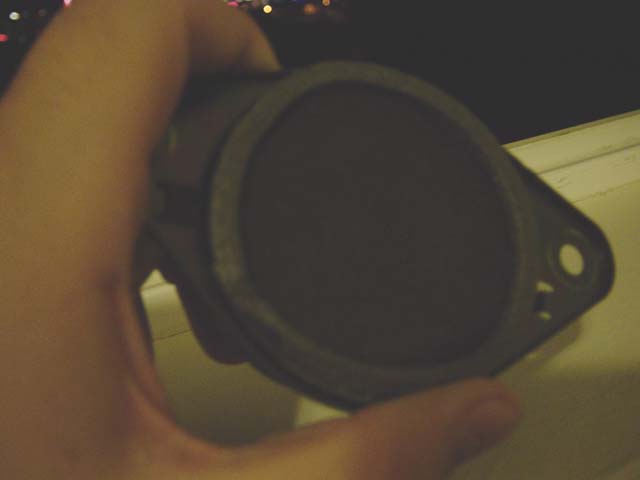

I have some old pics I took for someone a while back...
Stock in-dash tweet:
The in-dash tweeters are 4" from mounting hole to mounting hole. You're going to have a hard time finding anything decent to fit in there, though...
