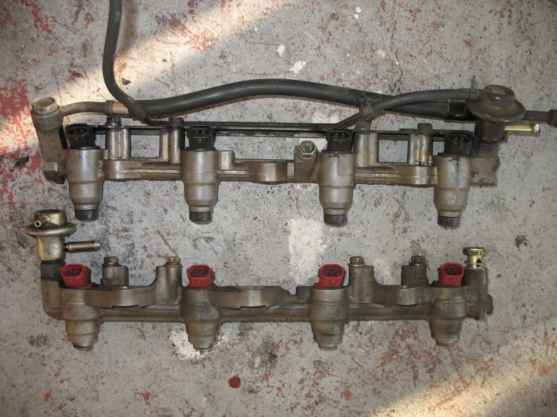

This is a confirmation that 2nd and 3rd gen 3sgte fuel rails are NOT interchangeable!
The bolt holes to secure the rail to the head are very different
What can be interchanged are the injectors and the fuel pressure regulator, decent upgrade for 2nd gen owners but the engine will run like CRAP if you don't tune it somehow with an emanage or at least a SAFC (be careful though) and a wideband oxygen sensor for sure. you should only go bigger injectors with the stock ECU if your setup is noticeably modified; bigger turbo, full 3" exhaust, cat delete, tvis delete, better intercooler, port+polish, bigger cams, etc
hope this info helps
other than the mounting tabs is the distance from injector to injector the same? it seems like that in the pic.
