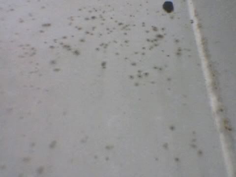

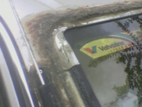

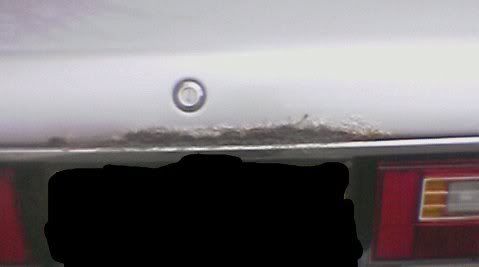

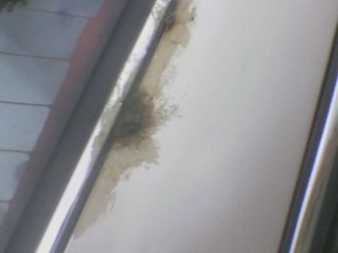

hi guys. just bought this cheap car recently..got alot of rust on the body. is there anyway i can clean it? or is it too late? on the rust on the top and the boot cover..theres serious rust and looks like somesorta mold was put on it! wonder what thats for..iv got some pics of the rust too..thanks

Without a lot of work and expense at this point you can only slow down the rust. Suggest using some kind of chemical rust remover and neutralizer liquid. Then apply something like RustOleum in a color that matches as close as possible your car. The finished product my not look pretty but it will slow down the rust. On the inside of the body parts spray on something like LPS 2, a rust inhibiting liquid.
6 Posts
when you say inside of the body? do u mean from behind the metal?
for now i jus want to clean the rust and cover it up. will tell the next buyer about the rust..
the mold thats on the rust..was that put on there to preven the rust from spreading? forgot to ask the owner
