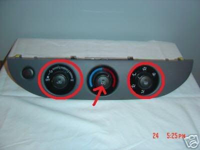

Your'e misunderstanding which bulb it is. The bulbs that you are talking about are the ones that light up the ring of the controls (red circle in pic) Yes, those are easy to replace but those are working. The one that is not working on mine is the green light when pushing in the A/C button (red arrow in pic) If it is that bulb that is out it seems a lot harder to replace. The bulb is behind the button and looks soldered into place.
the a/c light is led, shouldn't go out that quickly. and yes, its soldered in, and no its not easy to replace. like the others said, check the compressor and make sure your a/c actually works.
for future reference, all the button lights and symbol back lighting (Recirculate, A/C, Defrost) are leds, the outer rings are incandescent bulbs. i've replaced those leds to blue and red, and its not easy. took a little tinkering around to figure out how to get them apart.

^^ Update: brought it in to toyota this morning and they diagnosed the problem. Somehow my A/C fuse behind the panel was missing. It wasn't blown. It was completely missing. Real weird! I was tinkering around with my head unit the other day because I had to remove my sirius and ipod interface adapter so it could of happened then but I never distinctively took them out. To bad I couldn't figure out the problem myself and had to pay toyota $60 to figure it out. I should have thought of that before that it could of just been a fuse. DUH! But oh well, im just happy that it's not a major problem. Thanks for everyones advice and input though.
